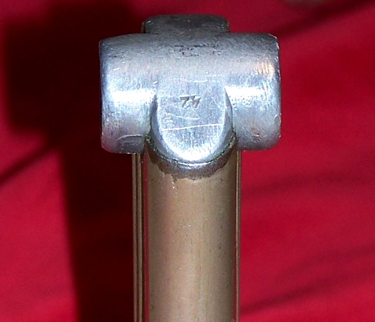

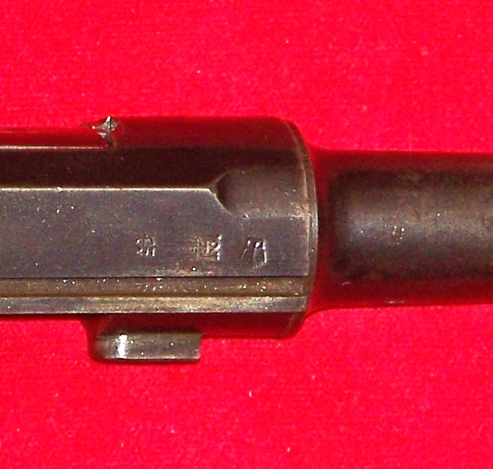

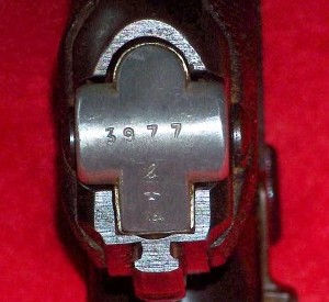

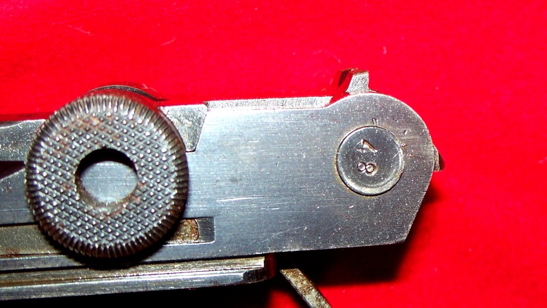

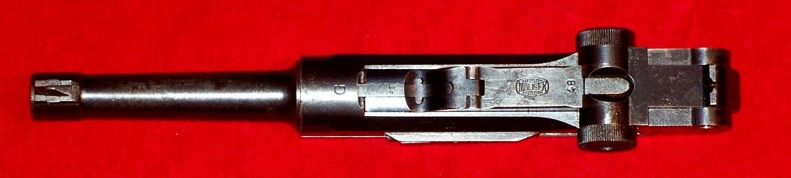

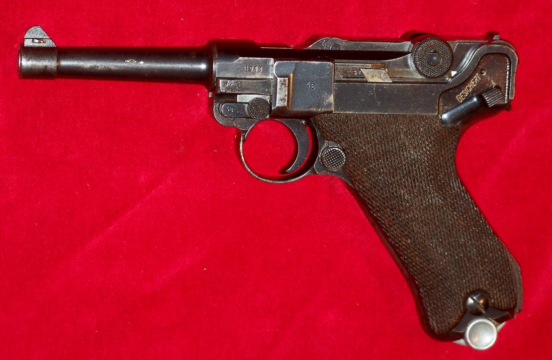

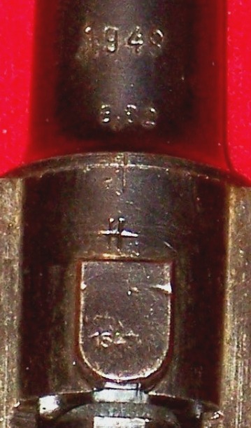

All........ just came into posession of this strange Banner toggled G date. The reciever has E/211 proofs, the barrel has E/154, the stop lug has E/154. The frame serial # is 1948x, and all the parts match, including the grips. The style and font of the numbers are the same, even to the toggle pin. The overall condition is not the best but it is the same all over, looking to be all together since it was made. The mag is a silver bodied, aluminum bottom, with only a S/42 proof and no numbers. Page 136 of Don Hallocks new book states "Confusing Exceptions" that may give some insight to this piece. There probably will be several opinions, but that is why I'm posting these scans. Thanking all of you in advance...

Whoops..... wrong mag scan.......Here's the right one..... sorry.
Myky

Numbers may match, but the years do not. Check Don's book. You'll probably find that the x suffix on frame is for a 1937 gun... note the blued small parts. A G Date has strawed small parts, and the E/211 mark is found in the d block. It is a parts gun.

Eric....... thanks for the input guy. Yes, I too believe it's a parts gun, going by Don's book. Any piece that had failed muster by the military inspectors was sent back to Mauser and they incorporated the necessary parts, and then sent it to the commercial market. By all parts matching with the same style and font, the un numbered surplus mag, and the finish being the same on all parts, it's apparent that's where this piece came from. I've been collecting Lugers for 52 years and this is a strange one for sure, not near in value as an un altered one, but still a conversation piece, and an insight as to Mauser's proceedures on rejected Lugers from the military. On pg. 298 Don lists # 1922x as being from 1940 and E/N proofed, a commercial, drilled only, no sear safety. Pg 296 and 297 also gives a short background. Just couldn't pass it up........ : )

The firing proofs were the last proofs to be applied. This indicated the gun was "good to go". If any part of the toggle train failed the test, I don't think any of the parts would have received 'military' firing proofs. I may be totally wrong about this. I hope that someone that knows more about this will chime in.

Hey Mike, thanks for your input ! Hallock, in his new book, says that the military inspectors could reject it even for poor bluing, even if it had passed all of Mausers proof testing. I kinda think this is what happened since all they did was put a commercial toggle assy. in it, removimg the military one, and running it through thier commercial outlet. See Hallock, pg. 136 and 137.

Ah, excuse my previous post myky. I hadn't read Pg 136 and misunderstood your initial post.
Interesting, would they have gone to the trouble of numbering the banner toggle? Can't tell from the photo, is there a proof mark on the left side of the toggle? (not meant as arguments against the theory... just a curious relative newbie : )

Hi Eric....... sorry to be so late in getting back to you, but have been at a gun show over the weekend. Yes, the toggle is numbered and proofed with the eagle, faint, but it's there. All Mauser had to do is reach in thier parts bin for a new and un numbered toggle, and number it to match. All parts are matched numbers in the same style and font.
