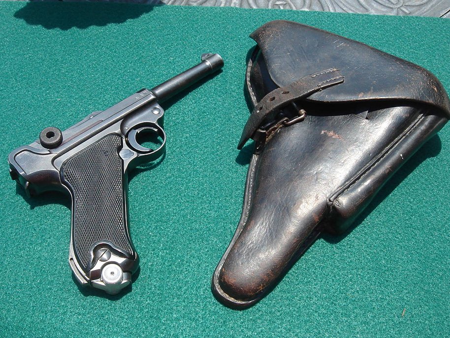

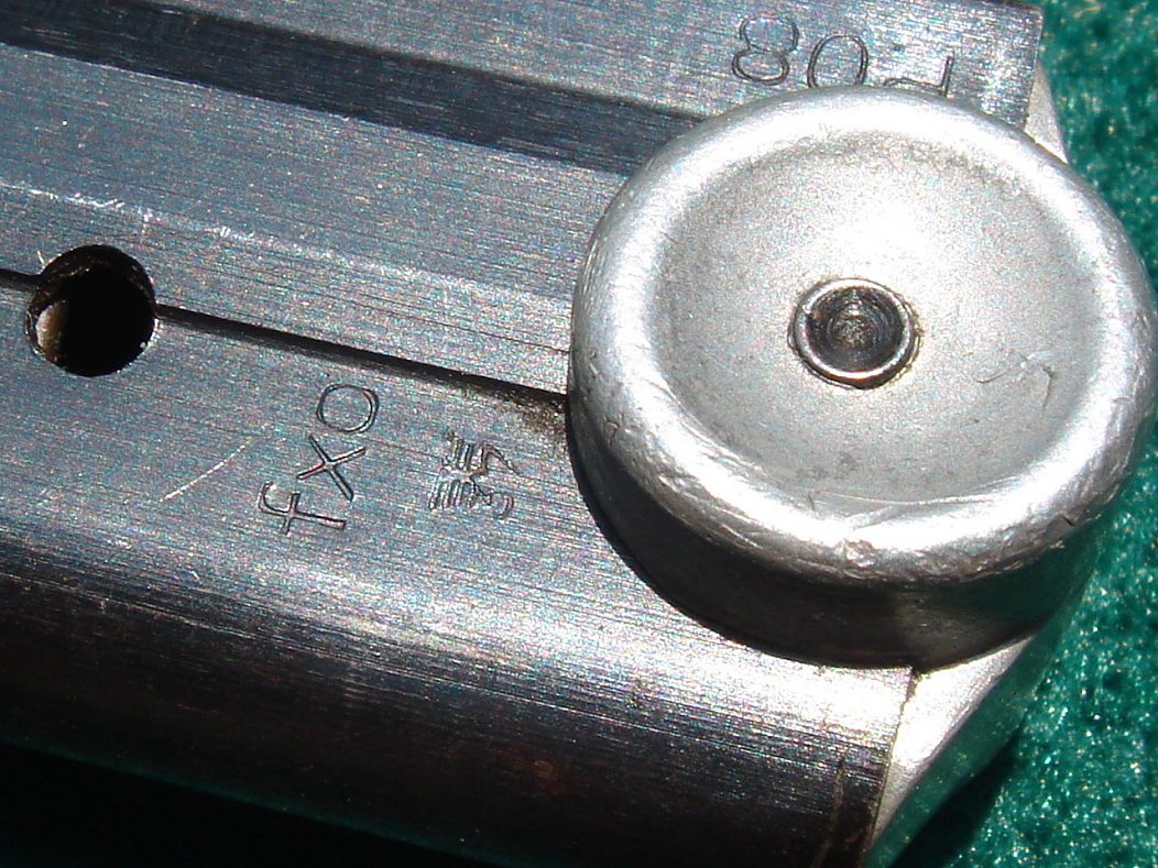

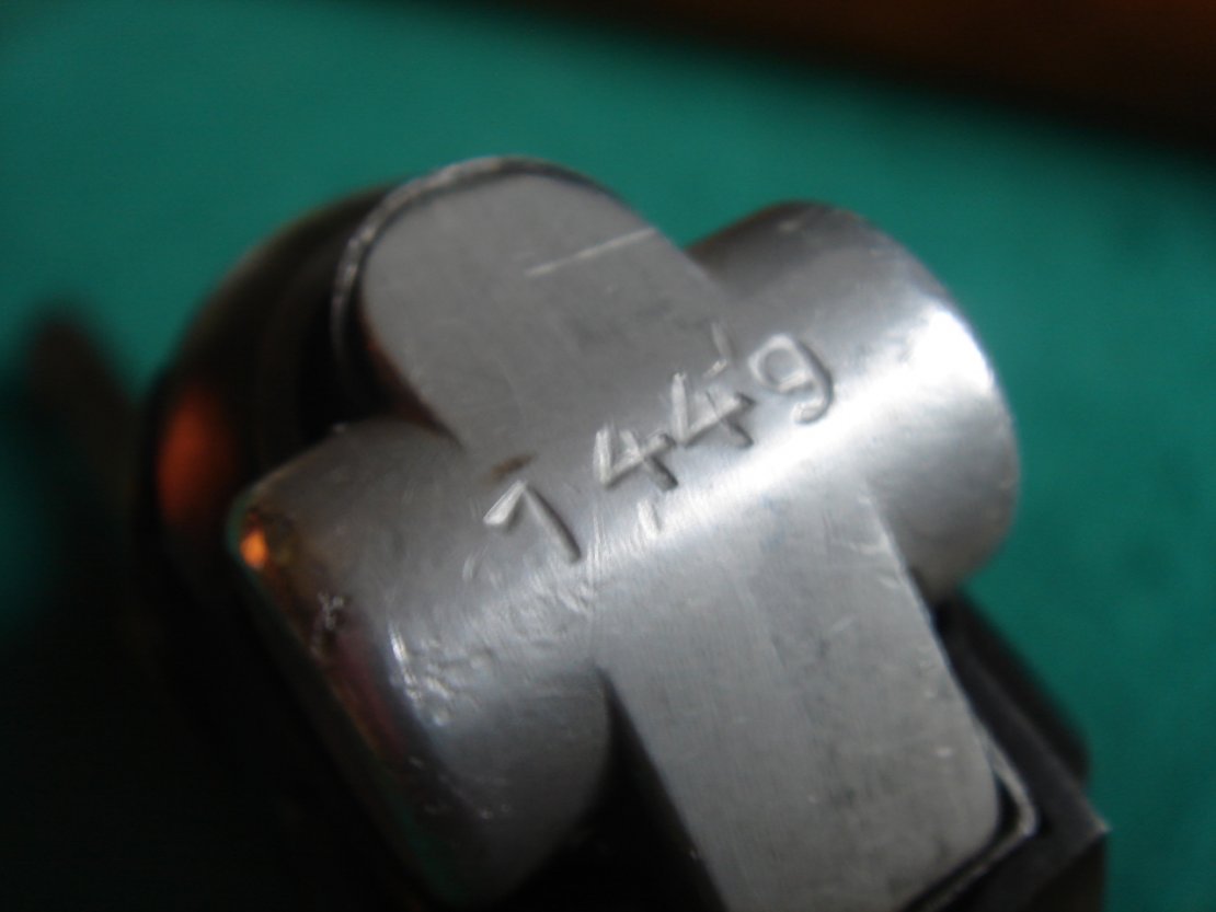

I'm new to the forum and after years of gun collecting I have take the plunge and bought myself a 41 byf Luger (s/n 1449a) and a Mauser C86 Red Nine from a friend's collection. My initial question is regarding the magazine that came with the pistol. It is an FXO, straight eagle 37 Top and bottom of the left side) that is in overall fantastic shape IMO. As you can see in the supplied photos...the pinned aluminum bottom has been stamped to match the pistol somewhere in the past. I've gotten answers all over the map regarding the authenticity of this mag actually matching the weapon. I've heard everything from "Bubba work" to "armorer's repair" to "original issue". Since there are no other proof stamps on the aluminum...I honestly do doubt it being "original issue". I guess my question is...what do the resident experts here think? All input would be welcome
Below are is photos of the bottom and side stamps and the rig as I got it...

This year of manufacture wasn't accepted on the base, the eagle 37 on the side is the acceptance marking....
Under magnification do you see other markings?
From several angles, looking from the side is the magazine bottom round (has not been sanded?

Hello donmor53 and welcome to the board.
Magazines issued to Military Mauser pistols would have the suffix a stamped under the numbers for the primary mag and the spare would include a + under the suffix. Also the font size and style should look similar to the numbers stamped on the pistol. It is possible that your pistol was issued without numbered mags, Mauser stop numbering mag towards the end of 1941 though 1942.

There in another straight eagle 37 on the left side about halfway between the the front of the mag (just before the roll) and the center longitudinal rib. It is about 3/4" down from the top and appears to be identical in striking depth and age as the straight eagle 37 pictured. There are no other marks than the FXO and P.08 pictured that I can find under any degree of magnification. I have worked with a lot of metals over the years and this bottom is still rounded and does not appear tp have been sanded. The s/n stampings look to have been done long ago as they appear to be aged, dinged and the coloration looks to match the rest of the aluminum surface. Bottom line IMO? Whoever stamped it...did it long ago and I would bet it hasn't ever been sanded.
Chris...
I was told that by all indications this pistol was a late '41 manufacture (most likely Dec.) and could possibly have come with the either aluminum bottom or bakelite FXO mag that match the black grips. Opinions so far are varied and lean toward a toss up. It's the apparently aged s/n stampings that so far have caused the conflicting views.

Thanks: 183
I agree with Chris. IMHO It was not issued with the numbers on the mag. The gun was probably isssued with a blank aluminum or bakelite bottom (possibly this mag). These numbers were added later. If you compare it to a correct numbered mag, you will see that the numbers are larger than normal.
Just my 2 cents...
I don't disagree. What I wonder is when and by whom? I guarantee you...the stamping has been there quite a while.

Thanks: 183
It reminds me of the large block type fonts used by the Police armorers. Police armorers never added the suffix, but they numbered the mags 1,2 or 3.
