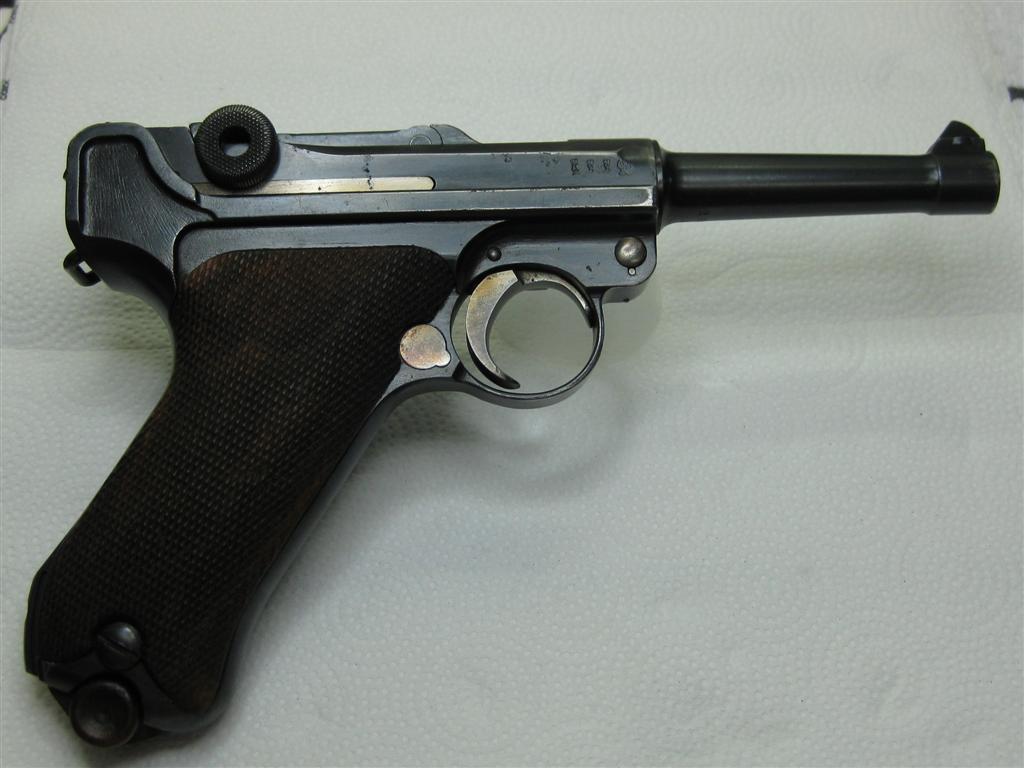

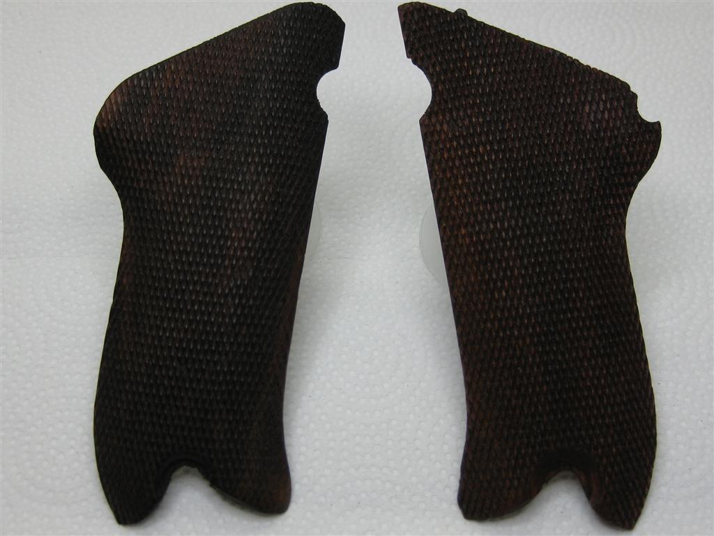

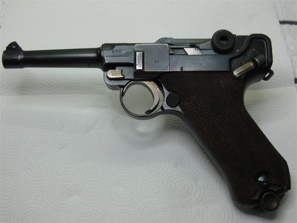

Thought I would show some before and after pictures of the grips. I ended up using Simple Green cleaner with a light scrubbing with a soft toothbrush, then a light rinse with water, pat dried with a paper towel then left to air dry for 4 days before applying a light coat of boiled Linseed oil.

The bottom three pictures don't do the grips justice, they turned out lighter than the pics suggest and have a nice rich look to them. Thanks again guys for the great advice I'm really pleased with how they turned out. A side note: after cleaning I realized that it looks like the left grip was replaced when the mag safety spring was clipped as there is no relief cut into the back of the grip. There is what looks to be a gothic S and a bell?? with something on top stamped into the back side of the grip. Cheers, Andrew

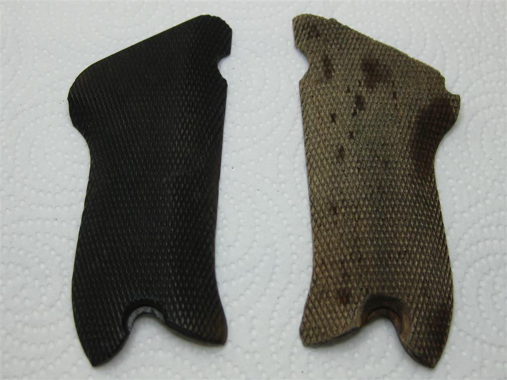

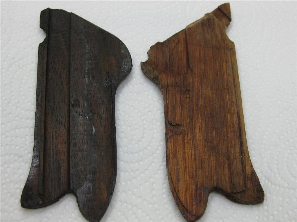

I used lacquer thinner to strip a pair of mauser C96 grips; however, there is a chip I am considering filling in so I haven't finished [Linseed oil] them yet...
They may not be original [no numbers on insides] but they fit much better than my aftermarket grips...
(New/aftermarket on left; stripped original on right)
