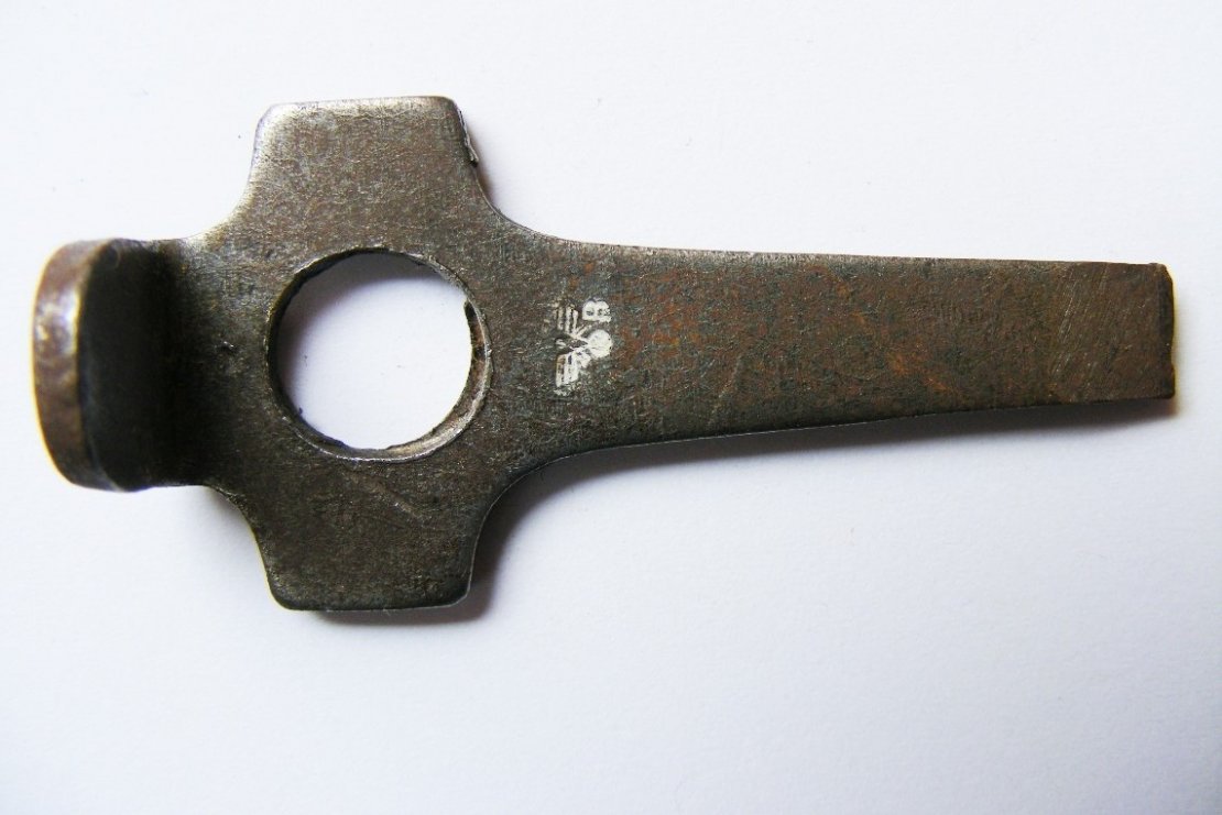

Originally Posted by Ron Smith View Post
How to use the tool.
Ron,
I may ask you to look at the top of your tool if there are markings like on the top of the tools of the added photo.
Thanks for looking!
Regards Klaus

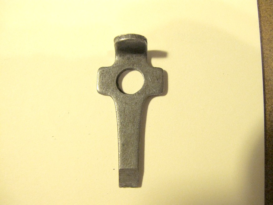

Hi Klaus,
Here's are photos of the tool I used. What is the significance of the marks?

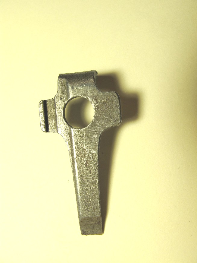

Unread 05-23-2011, 04:44 PM   #17
Klaus,
It is almost exactly 51.1 MM long. Sorry for the bad photos.

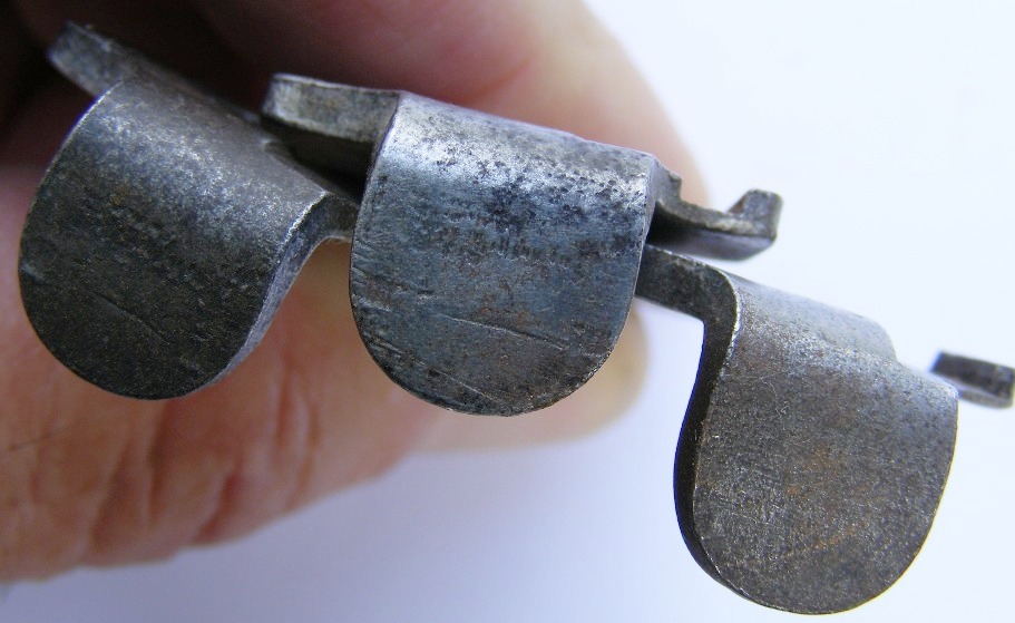

Unread 05-23-2011, 06:14 PM   #18
klaus 3338
Join Date: Jun 2009
Location: Germany
Posts: 525
Thanked 432 Times in 165 Posts
What would you say if you compare both tools?
There are some communities.
Thanks a lot for the photos.
Can I have some better/ bigger for my archiv?
My email would be grafschaft@gmx.de
Klaus
