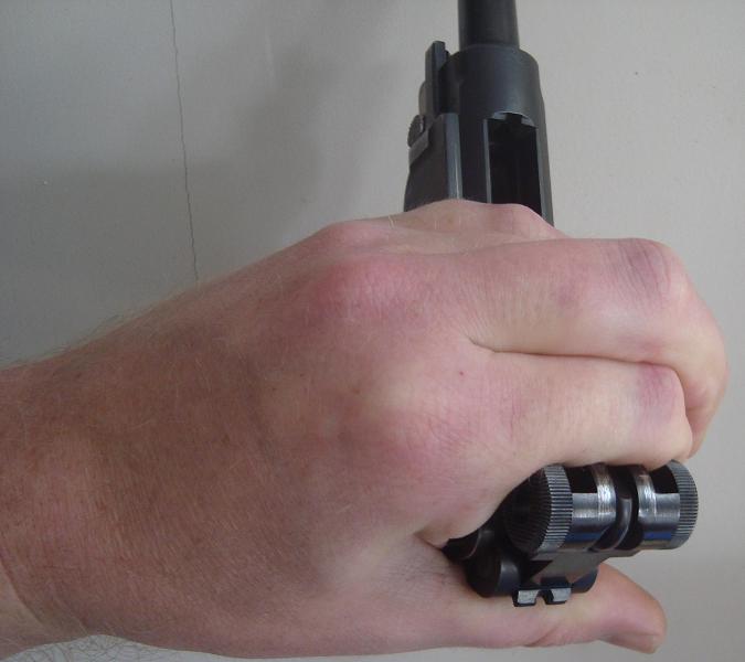

I think I know what you're referring to. The round rides up high and gets pinched by the breech with the nose on the extractor notch and the rim still in the mag?
When it happens to me I hold the gun in my left hand, thumb web high on the grip and the rest of the hand pulls the toggle back, leaving the other hand free to poke the round back down in the mag so it can be removed.
Muzzle in a safe direction!

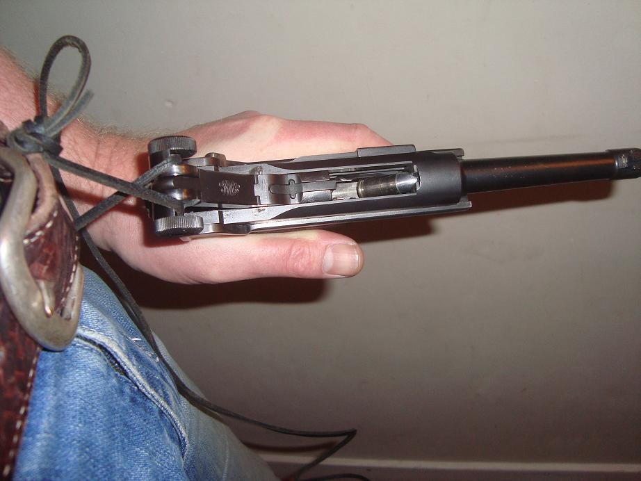

I could not let this go and thought up and discarded all kinds of contraptions to aid you.
Then this came to mind. A loop of rawhide in the belt, and put it around the knurled knobs. Simple is good..
Very little effort required to hold it open with one hand.
Could it work?

True, the holdopen won't work, nor will it be a good way to cycle the action as the toggle will pinch the thong in closing.
Hopefully it will give Lliam a fighting chance to poke the jammed round free and replace the mag with an empty one to lock the pistol open, without a lot of pain in the fingers.

OK guys. I had to go out for awhile this afternoon. I have been told there is more to life than messing with pistols.........but I don't think so. Back now tho. I grabbed a shoulder strap with snaps on both ends from an old camera bag, made a 4" loop of 1/4" braided nylon, clipped it to the shoulder strap, strap over right shoulder and then cross looped the nylon over the toggle grips as in Ugluk's picture, grip the pistol, straighten my arm and zzzt..Bob's your uncle! Works-like-a-charm!

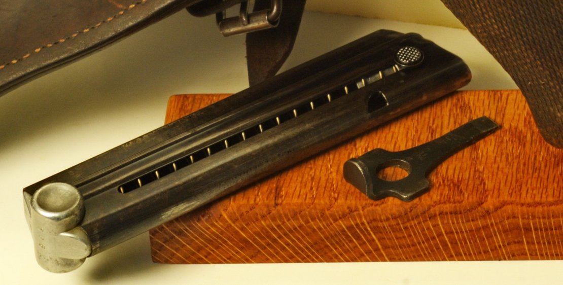

The original Lugers came with a small loading tool that doubles as a screwdriver for removing the firing pin. You can get both original tools and well made reproductions (which are relatively inexpensive, and actually come with some reproduction holsters).
The tool fits against the side of the P-08 magazine with the small loading button, and creates a shelf that makes it easier to compress the magazine spring. It may help you load your magazines.
