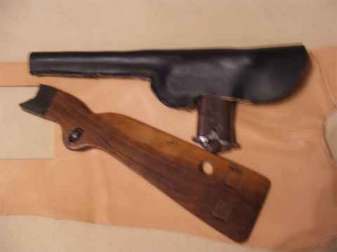

A pic of my holster I started. Wonder if anyone knows the size of the straps used? I'm guessing around 5/8". Someone else posted this pic of the rig, probably as ugly a rig as was around, but in 1893...

Bill, Yes a great photo! I can only assume you have in your possession the stock you show? If you do..you can measure the slots to determine the actual width.
Most standard straps, such as the Artillery are 3/4 inch. Thickness varies but is usually 1/10 to slightly more .0140 is about max but again..you can measure the width of the slots to see what they will accept.
Unread 05-02-2011, 05:04 PM   #5
The measurement is right at 2 cm or 7/8 inch. You want photos? You'll have to wait a day as I am swamped right now with projects that pay.

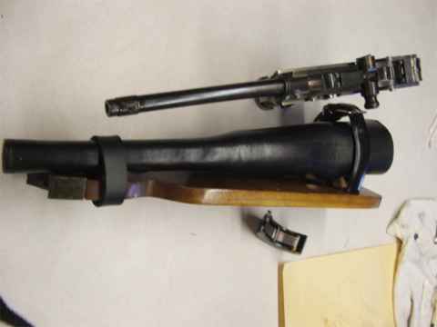

Thanks for the comments, Gents. I found that 3/4" Latigo strap material seems to work the best. I haven'got the long piece for the 'off the shoulder' strap. Nor, as yet have I made the "staple" bolts for the stock and frame....don't know what else to call them? The way the gun actually is strapped in, sure seems it would have been an unwieldy rig to use......certainly no 'fast draw'. I guess one would more likely wear the holster only on a belt, maybe carrying the rest along for storing. The stock I made from walnut, the holster is 9/10 oz. vegetable tanned hide with 'eco friendly' black dye Bill
