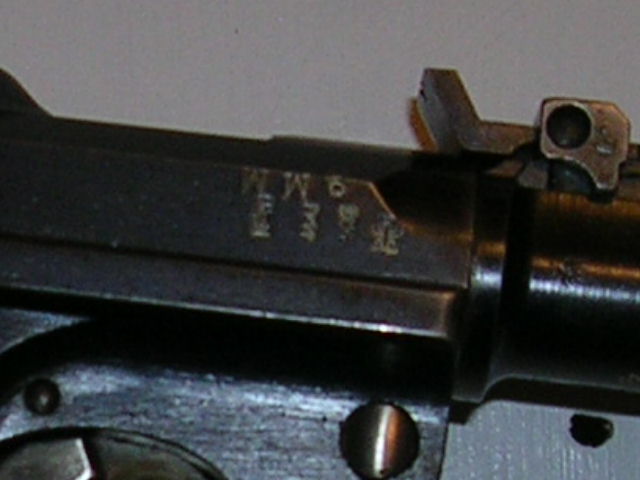

I have a matching 1918 Artillery , with "9MM" stamped upside down above the proof marks. The 'font' looks German. No import marks anywhere, or non German proofs. Any idea why this was done? Also, gun will not fire unless I put slight pressure on the side plate while pulling the rigger. I cleaned out all the crud around the sear, but don't want to start bending stuff. What remedy is recommended? Thanks.

I'd like to see pictures of the 9mm markings?
Sounds like it went to another country and it wanted to be obvious what caliber it is.
Could even have come to the USA and someone stamped it?

Here's a pix of the proof mark area with the upside down 9MM

My gut feeling is that this is some sort of goverment stamp at time of import or transfer. I can't imagine anybody else being so careless of appearances as to put the mark upside down in this way.
