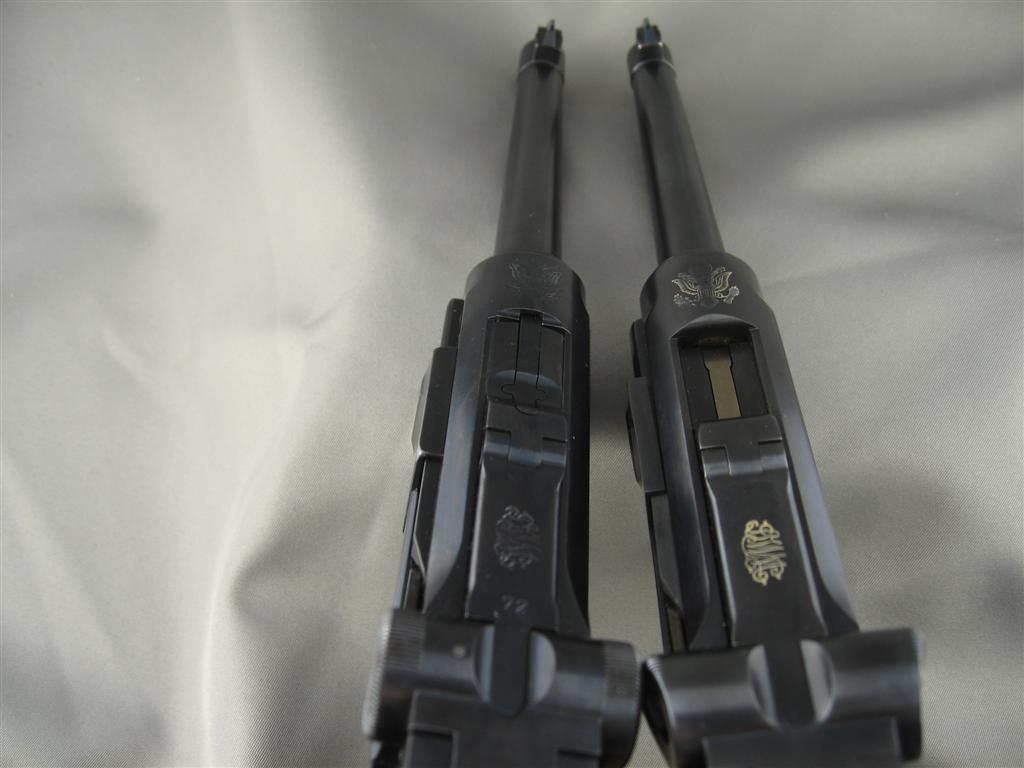

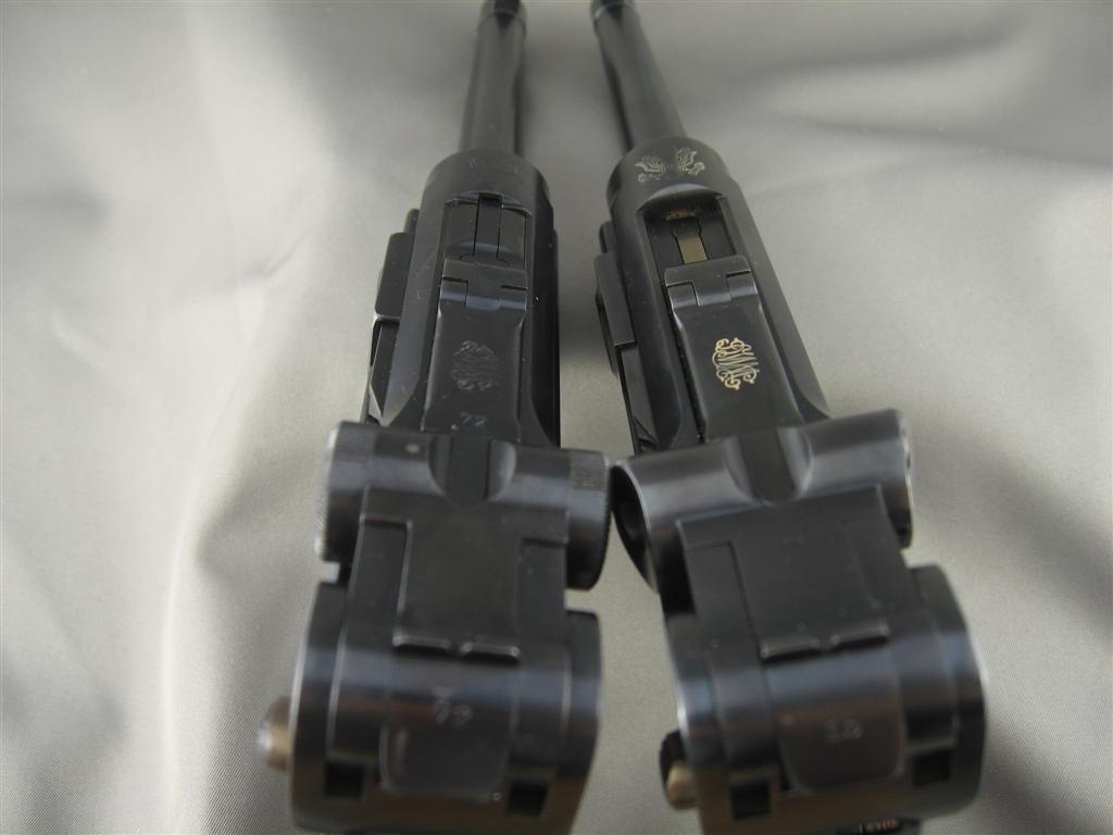

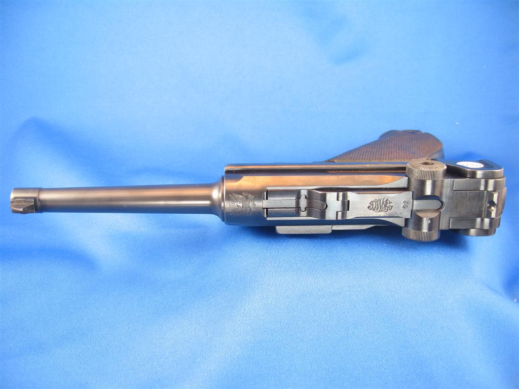

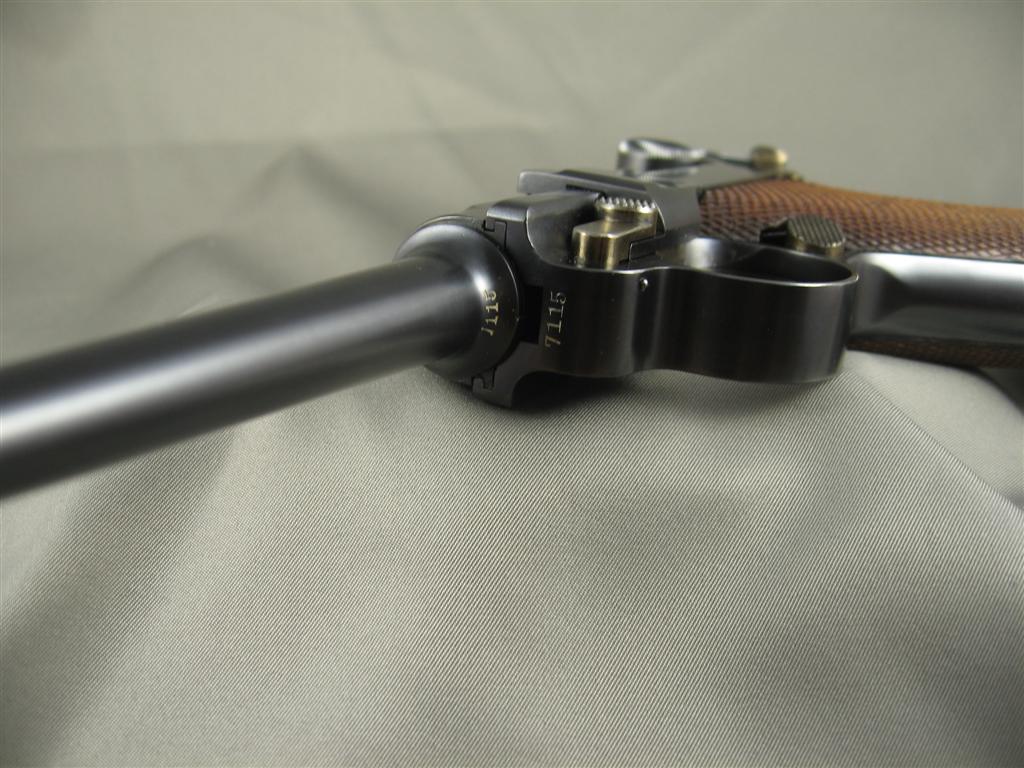

I am looking for information about a pair of my father's Lugers.
The first has very few markings other than the DWM on the toggle, the American Eagle on the chamber and the serial number on the barrel and frame.
The second has the DWM and American Eagle along with a crown over N proofs on the receiver, side of the toggle, and barrel. It has Germany on the frame along with the serial number.
Any information and approximate values would be appreciated. Thanks.

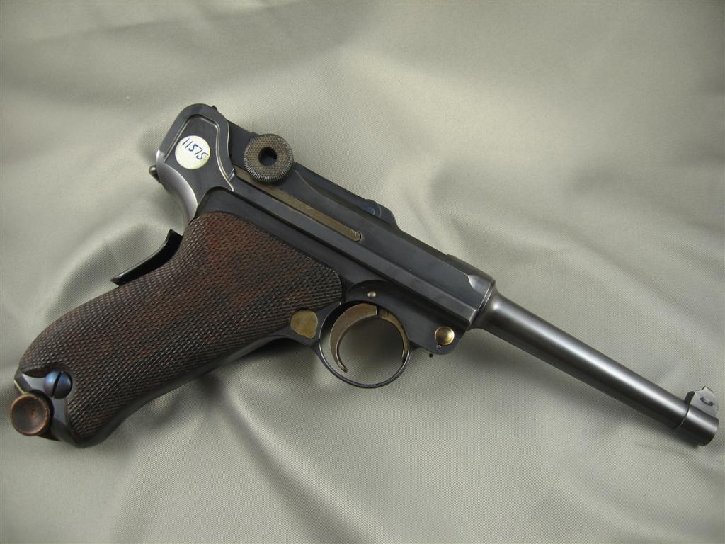

Nice photos! I would like to see photos of the left side of both guns with the safety in the upper position to better evaluate their finish. I personally cannot tell from the photos if their finishes are original, which has a major impact on their value.
The first one (Serial #7115 I think) is a model 1900 American Eagle. It is in the serial # range of those tested by the US Army in 1901-1907. The serial # is not a "Bannerman" number - one of the serial #s known to be purchased by surplus dealer Francis Bannerman which would validate it as a US test gun. The gun does not carry a "Germany" export stamp, which is typical of guns in that serial # range.

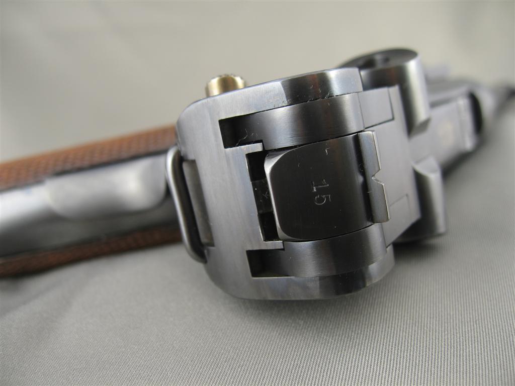

We would be interested to know if this gun is all matching. The #15 should appear on all parts including the rear of toggle, takedown lever and sideplate.
The second one appears to be a 1906 Commercial luger. #54772? Dwight Gruber's commercial luger database lists #54772 as a commercial w/o an Eagle. If it has an American Eagle on it and I have the serial # right, please post a photo so he can update his database. The "Germany" is a requisite export stamp designating that the gun was intended to be sold outside of Germany.

7115 doesn't have a serial number (15) on the takedown lever that I can tell, but it does have it on the bottom of the side plate and the rear of the toggle.

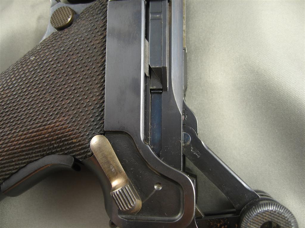

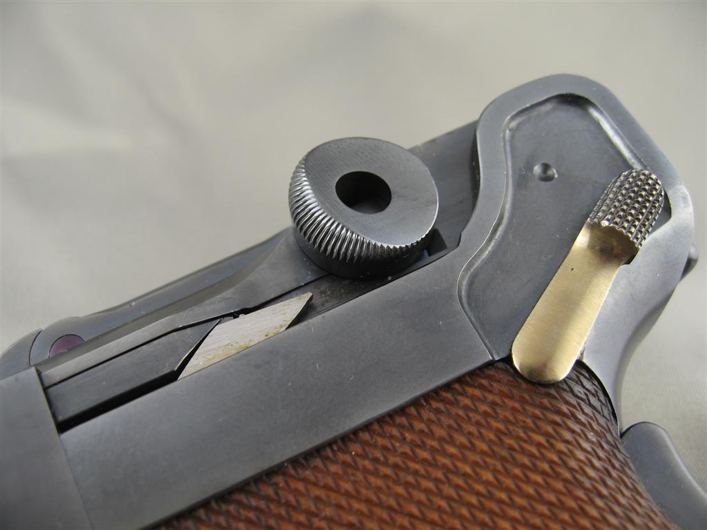

Here's a pic of the top of the 54772. It's a little overexposed as I was trying different things. I don't know how I forgot to get shot of the top this time around.
I'll get some shots with the safety in the upper position later.

Good lord, my bloods' running greener than Spocks with envy! beautiful.....the blue looks legit, the machining marks and edges are razor-sharp, straw is awfully pristine tho.....sure eager to see what Meister R. Wood and the other guys say!

I agree. That straw coloring just looks too good to be true. But very nice early Lugers.

I think 7115 has been restored, its color looks off to me, but from pictures it is always very hard to tell!
The other looks good, although the crown N seems light; but same caveat as above, as they both seem like old restores to me.
I would say, for a restored in range, but not bannerman 1900, $2500, if original (obviously the strawing is most likely not) then almost double that, around $4000-$4500

It may help to see left side shots with the safety lever up, and also downward shots into the top of the mag. well with the toggle back.

Beautiful guns, and the 1900 is particularly exciting for me. Although not a part of the Bannerman purchase it falls between known serial numbers 7108 and 7147 that were part of the purchase. In my estimation, I would be comfortable in saying that there is at least a 90% or better likelihood that it is a piece that was actually used in the US Test Trials. That is the good news…the less encouraging is that it is a professional restoration with a replaced takedown lever. That detracts somewhat from the monetary value, but as a collector piece it has, again in my opinion, a legitimate place in history.
The 1906 appears to be largely in original condition but may have had the straw restored.

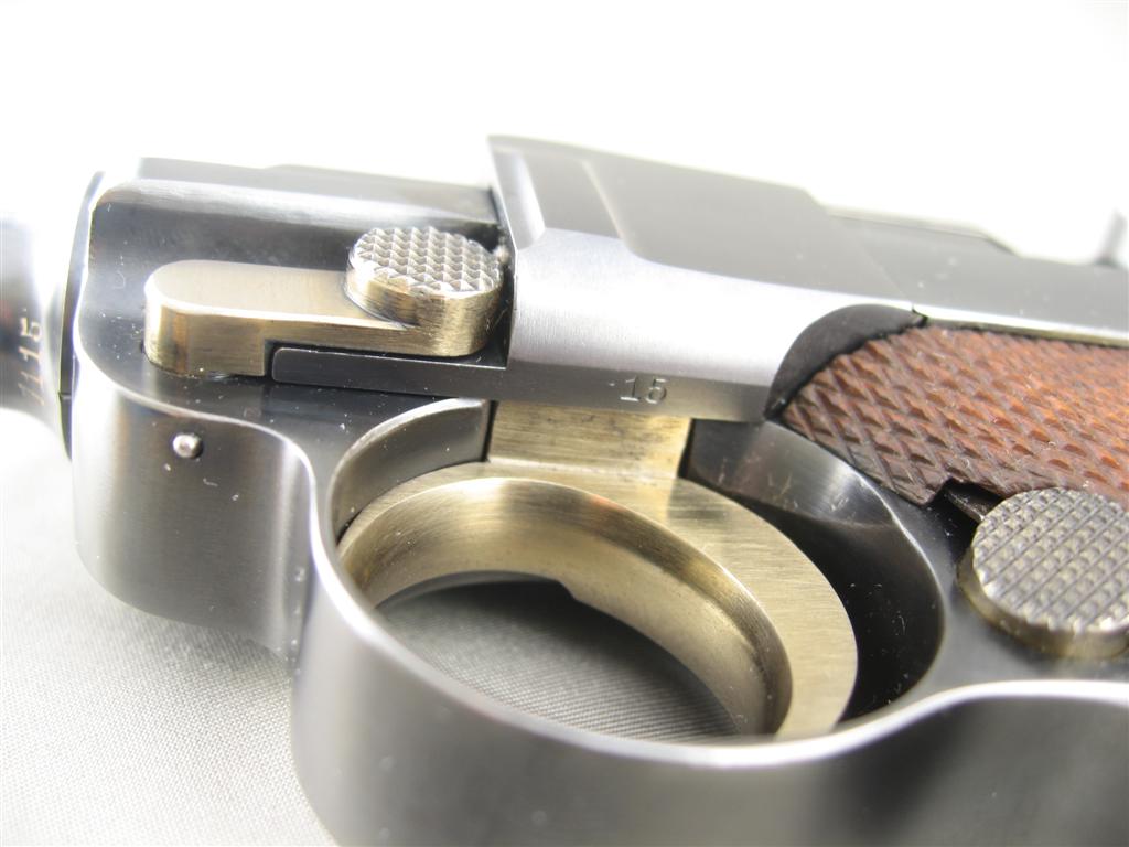

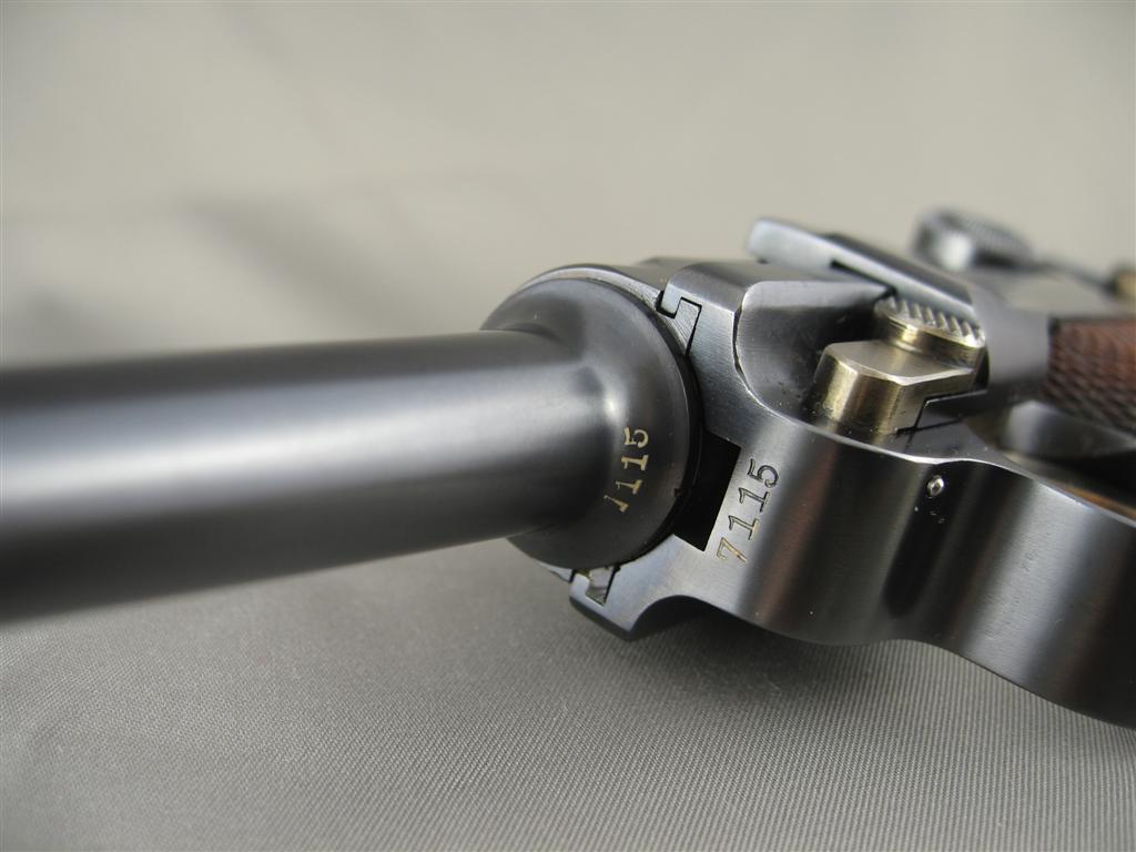

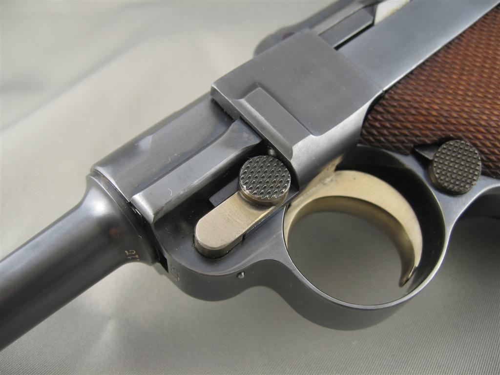

Good news (I hope). 7115 does have a serial number on the takedown lever. It was on the right side, not the bottom like the other.
Here are a bunch more pictures.

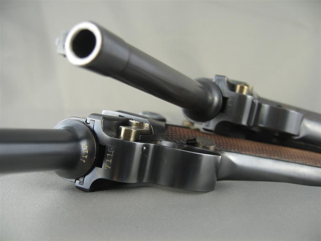

Here's a few of them together.

Whoever restored your 1900 Luger did a great job and carefully marked replaced part(s?), However, he did not know that the surviving examples above 7100 have the serial nuimber placed on the left flat of the takedown lever, and not on the right round end. The devil is in the details.

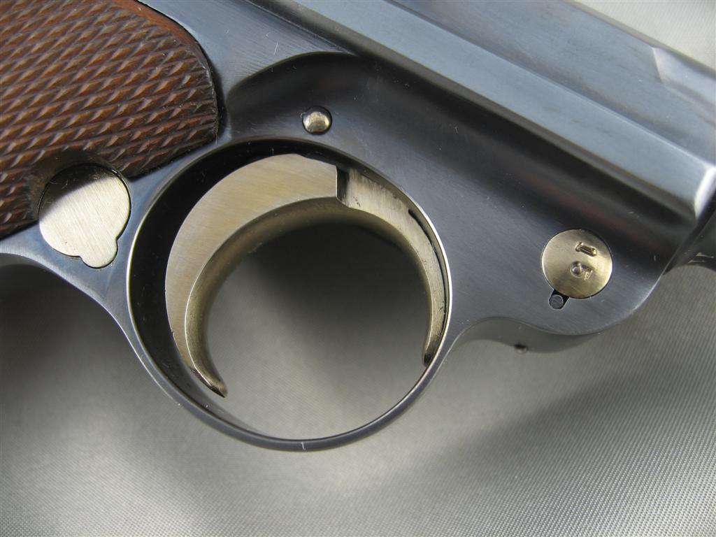

2 Questions:
1. Why is there no bluing under the safety lever with the lever in the down position?
2. Is it not possible that the person stamping the takedown lever was distracted and just FUBARED that part? If that had happened would the factory necessarily have either discarded the part of ground off the misplaced stamp and then stamped the part correctly?
