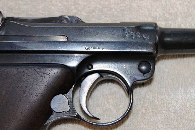

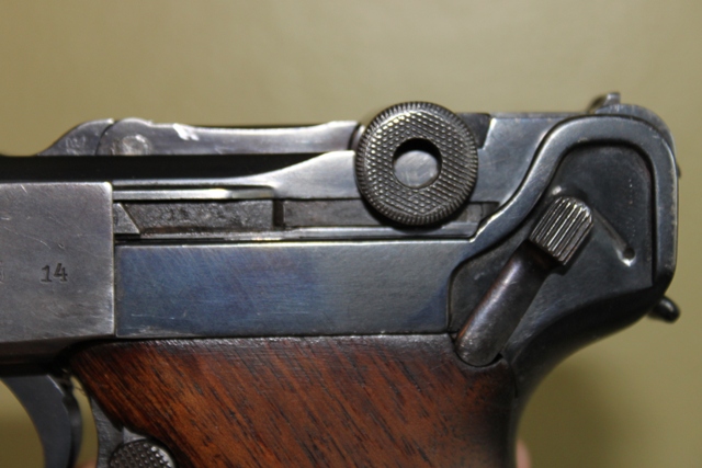

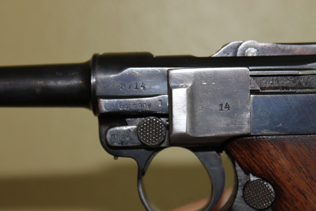

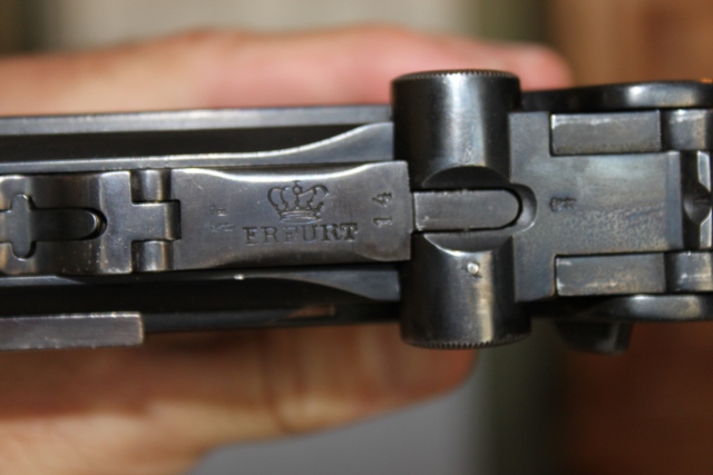

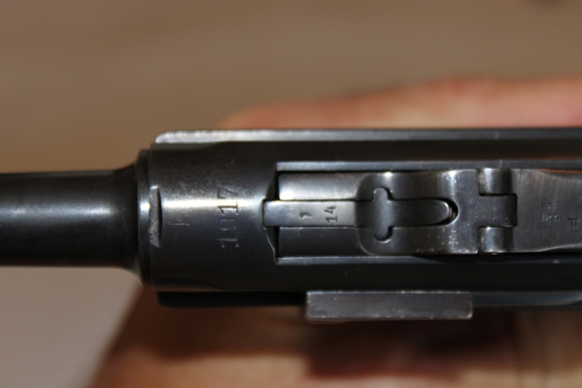

New user, apologize if I am posting this incorrectly but sure would appreciate any help. Inherited from my late father his prized 1917 Erfurt Luger, SN 8714. He was never able to fully identify having consulted several resources to include books from Datig and Reese. Didn't have the internet so thought I would put it to use to hopefully solve his quest. Particulars are 1917 production year, Erfurt stamp by toggle, smooth vs checkered grips in 7.65mm, Yes, 7.65. Barrel is 4", all SNs are matched except magazines. Holster is not original (for this pistol) as was produced in 1940. Everything says this should not be 7.65 rather 9mm. Can anyone help? Much thanks.
Uploaded some photos, have several others if needed. Also have in very high res (3MB+) if desired.

WHR, You are correct that a 1917 dtd MILITARY PO6 should have a 9mm barrel. There are 2 possibilities that came to mind: If the original matching proofed military barrel, it has probably been relined. If not the correctly marked barrel, it has been changed. TH

The barrel still has the original 9mm land-to-land size in mm (8.84mm), so there is no doubt that it once was a 9mm barrel.

Rebarreling to another caliber to extend a weapon's life does not really make sense. If you are relining, there is no difference in time or effort to simply reline to 9mm again. Chances are this pistol may have ended up in Mexico or a country with similar laws at some point in its life. The 9mm caliber is highly restricted to the military and police in Mexico and many guns, which ended up down there were rebarreled or relined to other calibers to comply with the law.
Mexico, in fact, is probably the .38 Super capital of the world. All the 1911s or Browing HPs you see commercially there are in .38 Super, since .45 is similarly restricted as 9mm.
This gun was also subjected to some abuse, (see the vice prints on the right side of the frame around the reverse face of the mag release). Probably during barrel removal to effect the relining.
