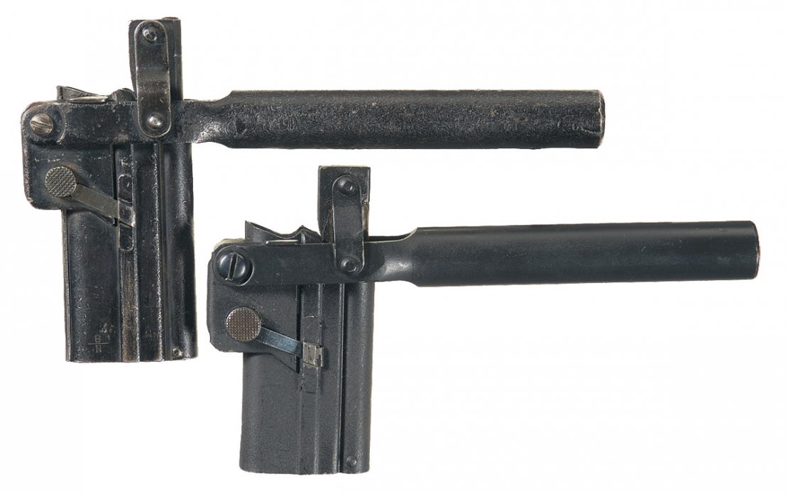

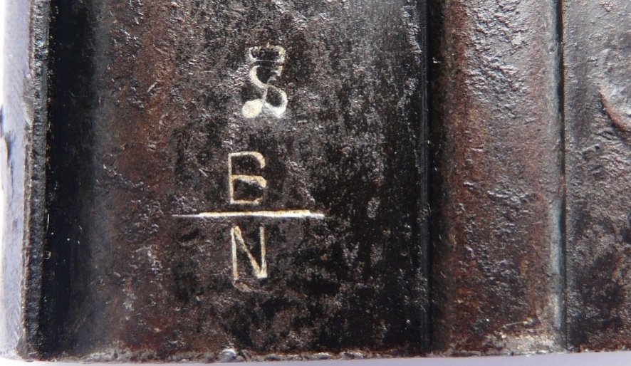

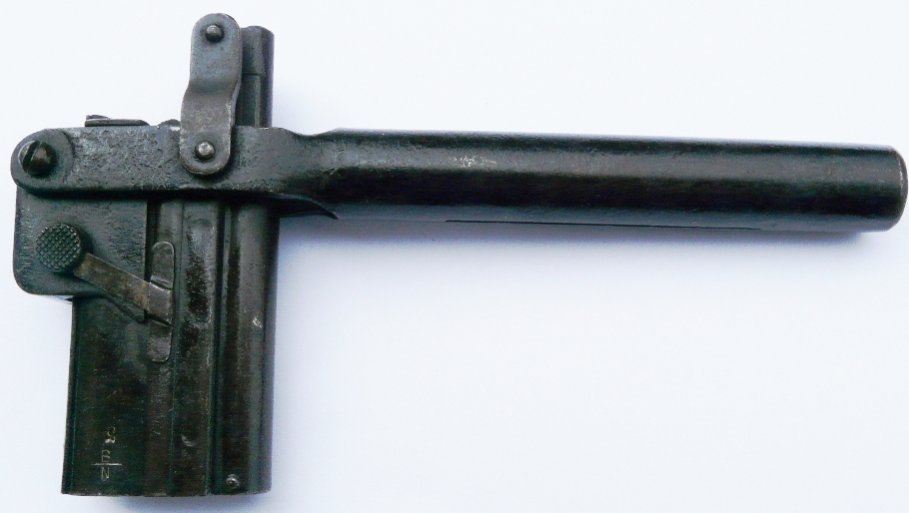

Joe, there are many differences between an original and this fake; for example: the acceptance mark is not correct, the measurements seem to be wrong, there is no color on the tool, the flanks of the handle are not milled on the original, the handle of the fake is made by a pipe, the original handle were made only from a piece of iron.
My English is too bad to describe all the mistakes of the fake.
I add some pictures of an original to show the differences.
Regards Klaus

You are right. Even if the seller offers the right to return the merchandise, it's a bad deal if you don't recognize it's a phony. But for a non expert like me it seems OK. I was fooled by the pics, too.
Regards, Andy
