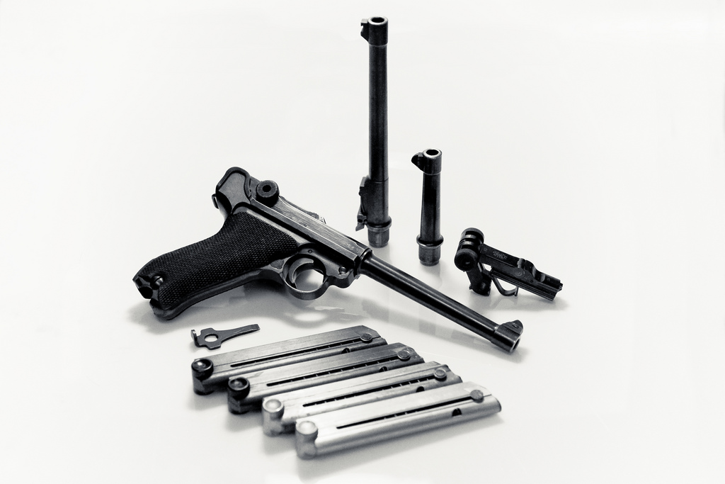

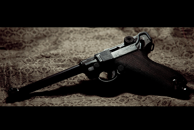

Hello everyone, my name is Ryan. Well I finally got it! My grandfather was in WWII in Nazi germany and brought home two takebacks. One was a Mauser Model 98 and then this one. I have cleaned it up and its in great shape. So far from the markings I believe its a Krieghoff Early type Navy gun. It is numbers matching except the barrels. It has 3 barrels, a 3", 5" and 7" (guesstimate) along with a secondary bolt/cocking lever and 4 magazines. I promised my grandma I would not put any serial number on the internet(she has a real concern about this for some reason) so I photoshopped them out and left the crest stamps.
And a couple photos. I will post more with the markings later to help verify my findings though.

The frame has P.08 on the side, indicates Mauser Army or Commercial Luger of 1941 or 1942 vintage. What does the top look like 41, or 42 Chamber date? 42 or byf or S/42 on top of the front toggle link?

Well, the long barrel is an artillery barrel, but the loose toggle has a sight, so it's not a match...nor is it a navy...What rear toggle is on the pistol??? Does it have a rear sight???
Odd that your grandmother does not want the serial on the Web...Does she expect someone else to claim it???

I appologise, I know where I got the Navy thing from. The barrel that is currently on it has the crown looking hexagon with the letter M below it.
But is the rear sight on the toggle a 2-position adjustable sight or a fixed V-notch sight???
Picture on Flickr is not viewable...
No it's just a fixed v-notch :-/
Okay, to help with identifying it let me just say regardless of what my dad told me last night(lol), the toggle serial does not match the rest of the gun.
I printed out the identification form from the tech info page and I will list it out here.
1. Toggle inscription: BYF
2. Chamber inscription: 42
3. Toggle knob type: knurled
4. Grip safety: none
5. Stock Lug: yes
6. Caliber: 9mm
7. Grip type: Walnut Checkered no border
8. Thumb safety: on in rear position with white Gesichert written under lever
9. Describe markings: eagles matching proof #47 on right side of chamber with the number 135 below two of the eagles.
10. Barrel length: 5.75" with markings mathing proof #5
11. Markings on left of extractor: eagle with circle below but it's pretty shallow.
12. Description of sights: front- side mounted dovetail fixed. Rear- fixed V-notch.
13. I have 4 different magazines so we won't worry about that for now.

What you have is a parts gun and therefore a nice shooter with no real collector value. Was your Grandfather a gunsmith or particularly handy with tools? The entire collection looks like it was meant to occasionally swap out barrels on this single pistol or he intended to aquire two more frames and build up one of each barrel length.

From these pictures, it appears that you have two bakelite fxo magazines, and then the other two, I would be interested in seeing their bases?
One appears to be a flat button follower (made for the police for a short time).

The barrel that is presently installed is a Navy Luger barrel and has the appropriate and extra high front sight base for that type gun, not the gun you have just inherited. What that means is that the gun will not shoot to the point of aim, but significantly low...
The only way to get your Luger to shoot to point of aim would be to install a barrel that had a correct front sight base. The only barrel of the ones in your photograph that would be correct is the shortest barrel. The front sight base correctly matches the standard rear sight V-notch that is on both rear toggles that you have pictured. Place the muzzle of the 4 inch barrel against the muzzle of the installed barrel to see this difference in height.
Changing a Luger barrel is not a job for an amateur gunsmith, or even a gunsmith who has not done it before...and I personally do not recommend that you try it.
...and try to find a rear sight to match the artillery barrel.
The artillery barrel already has the proper rear sight...It does need a front sight, Tom Heller [LugerDoc] probably has a proper one...
...But both your rear toggles have fixed V-notch sights on them, which an artillery does not use (artillery rear toggles lack any sight)...
Tom should have one of those, too...and he has the tools & skill to change them...
then you would a really fun artillery shooter!!!
The Luger frame is easily mis-aligned by the use of improper tools, and can be permanently damaged.

Thank you gentleman. And yes, I am well aware of the legalities, but if I do so it would just be for display in my home so I'm not worried.
And thanks for the tip on the mounted barrel's sight being too high, this was a fact I had overlooked! I think I will try to find the front sight and have the artillery barrel mounted as suggested below!
Thanks and that's what I will do!
Quick question on that artillery barrel. What is the scale the rear sight uses? Meters x10? (I.e. 5 for 50 meters?)
Hi Ryan, Those are 100 meter increments. An Artillery sight is adjustable to 800 meters. Regards, Norm.
