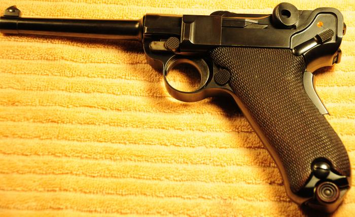

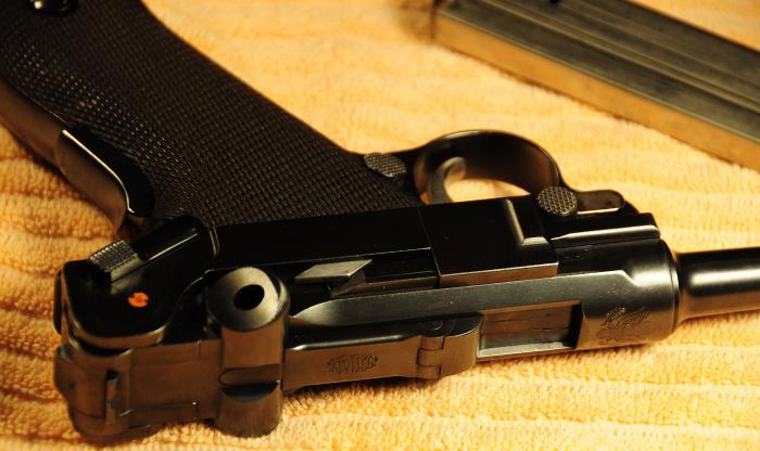

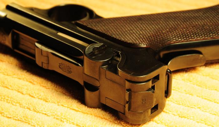

This 1900 AE is up for sale at what seems an attractive price..... it's described as "all original and possibly unfired". I have big doubts about that description, and I'd bet its refinished, which isnt a big deal to me. It looks like a hot blue, not rust, and seems to be more wear to the grips than the finish. I've written the seller to ask if its all matching numbers and for more pics...no response yet. Obvious blips are the red paint in the safety detent and seeming lack of straw on the safety and extractor....it can be had for 1900.00....what you guys think????

Like to see under the safety lever when it is moved to the "red detent" what does the other side look like, should be in the white and the shape of the safety lever when it is in the down position. What does the inside of the receiver forks and mag well look like, bet they are blued. Wow, metal looks in terrific shape, would I like to get my paws on it to restore.

I hope the price is right. I'm seeing mildly rounded edges on the rear corners, and that's a shame. If the mag is genuine Navy, then that's a definite bonus. Matching numbers? Bore?You and Thor need to talk this one out before you throw money at it. Seems like it should be in the $1500 range as is. With the seller describing it as "original and possibly unfired" I'm seeing red flags all over the place...

Yeah, I already had Thor in mind! pricewise....Simpsons (yeah,I know) is selling 2 different refinished 1900AEs for over 4000.00....ya think I could really find one like this for 1500.00???
Thor, if you look close, I think you can see a sliver of the bare metal under the safety, but I doubt that would neccesarily mean its original.

Yeah, not sure about that, but the thumb safety, extractor and toggle lock should be strawed, and they all appear to be salt blued.

Yeah, Thor ,I'm not wearing rose colored glasses ( I hope) I'm sure it's not original, I'm just wondering what's a good value. I've looked around a LOT at 1900's and I've only seen one below 2500.00 and it was a rust bucket. If there are any out there for 1500.00, point me in that direction!

To my eye, the gun that nukem is looking at is in better shape than the one on Auction Arms for $1900 (not a very good "restoration"). But, it sure would be nice if it was a bit cheaper in order to leave some room to have it restored.

Why would the seller photograph this luger with a yellow hue?

Asking price is twice too much. Otoh if all the markings on the Navy magazine are present and original the mag alone is worth several hundred dollars.
