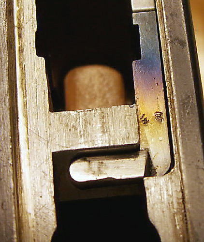

When you have an empty mag in, the follower button on the mag should push a little lever up and hold the toggle back. First thing is to see if you have this hold back device installed
Here it is the piece #48, running along the inner rt. side of the frame, then the cross piece just behind the magazine well.
FN

Thanks FNorm. Finally got around to taking the gun apart yesterday. What I found is that the magazine has a little slack in it. It does not lock tight up into the slot. If I press on the bottom of the empty magazine while pulling back the toggle, it locks back like it is supposed to.
I guess I need to look into why the magazine isn't locking tight into the slot. Is there somewhere I can get another Luger 30 magazine?

The front hole/slot in the mag gets worn and elongates. This is where the mag lock shaft locks it into the gun. A new or different mag usually solves the problem.
