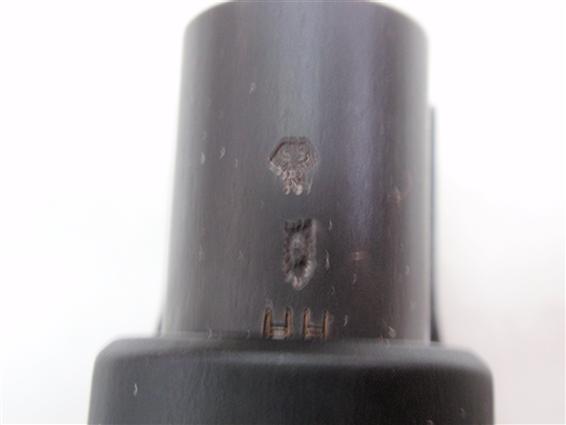

On the subject of VOPO markings/sunburst...
I was browsing GB looking at Sig Sauer P220's and this Browning BDA cropped up...with VOPO sunburst and nitro proof marks...
Browning Model BDA Pistol, manufactured by Sig Sauer for Browning

Hi, I see a Western-German commercial Crown/N proof, a 1977 proof date and the proof mark of the proof house in Kiel (West-Germany at the time).
Not much VoPo about it
So the middle mark isn't the VOPO sunburst???
It's a blurry pic, but to me the top figure looks like an Eagle/N; middle a sunburst; and the bottom looks like "H H"...
Unread 10-17-2010, 01:05 PM   #4
The middle mark is the proof house ID of the proof house in Kiel.
It looks like a squashed bug
HH is the year code for 1977 (H = 7).
They use a simple letter code whereby a digit is replaced by a letter.
(i see that I called the proof a crown/N, of couse that had to be an eagle/N ....hum...)

When I first saw the auction, it occurred to me that perhaps it was a built-up parts gun...maybe with an East German barrel (or slide; it looks like these marks are on the slide)...
