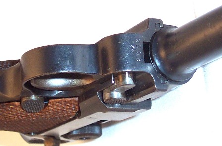

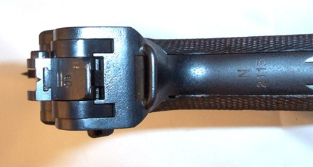

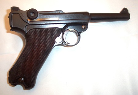

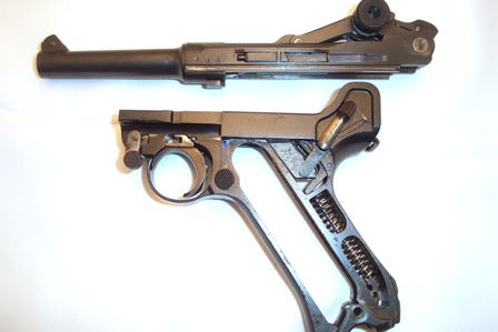

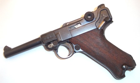

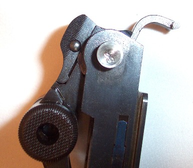

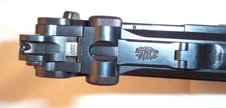

The attached photos are of my Navy rework Luger. It is: DWM, s/n 2593a (numbers are the same size on frame and barrel, small parts have 93, 9mm, barrel which had been cut down (sight area shows no buildup) is evenly cut with proper crown and 4", has been blued, unknown if during rework (no halos and blueing covering light pitting), no number on chamber (does not look like anything has been buffed out), no import marks.
Your comments and critique would be appreciated (good or bad). It will reported to the fake list is the discussion so indicates. Enjoy the pictures, still learning. I think if you click on the picture it enlarges.

Hi Art, Thanks for showing us pictures of your '06 Navy #2593a, Weimar rework. I consider this rework part of your gun's honorable service history, and not evidence of fakery or boosting. There are several similar guns in "The Navy List", the data base I maintain. Send an email to me at normrab@comcast.net , and I'll send you the link. Regards, Norm

Hi Art, There is a very similar Weimar Navy reworked 1906 Navy #6199a, N/1952 marked gun, illustrated on page 95 of "Weimar Lugers". Regards, Norm

That's a nice legitimate Weimar Reichsmarine rework.

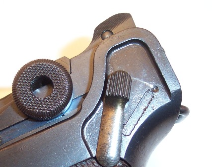

Yep, converted to a thumb safety only...a drop in conversion, but requires modification/replacement of the sear bar.
Would the rear frame strap slot for the grip safety have been welded in as part of this modification??? I'm curious as to how much machining would have been performed afterward on the weld...Would it show up if you looked inside the frame (under the grip)???
I enlarged & lightened the backstrap pic...I don't see any bluing mismatch...(where the slot would have been)...hmmm???...
Unread 09-25-2010, 09:31 PM   #8
Thanks: 1,119
There is no frame strap slot for a grip safety. The wood grip is relieved to accommodate the safety.
Ah!

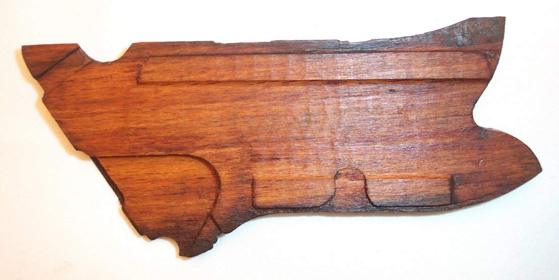

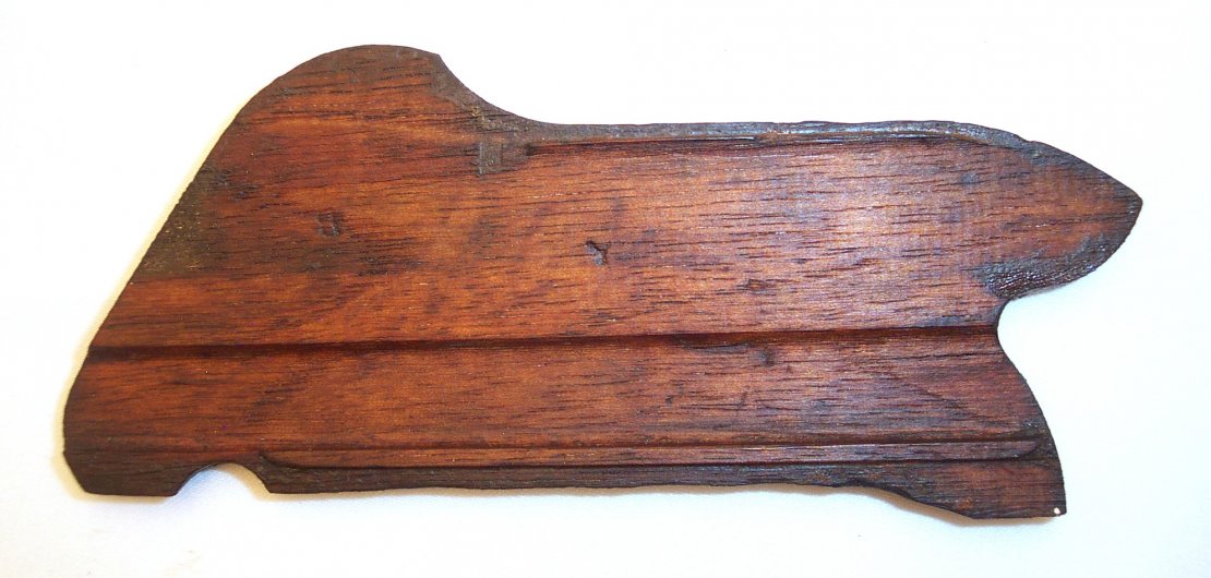

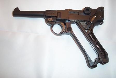

I am posting bare frame and inside of the grips photos for your review and comments.

A beautiful Weimar conversion of a 1906 First Issue Altered Navy, and your photos clearly show the original setup for the grip safety that has been removed.
Unread 09-26-2010, 08:38 AM   #12
Ron, obviously I am not familiar with grip safety Lugers (I've never seen one, and the pic above is too small for me to make out differences), so could you point out the original setup that remains on the OP's Luger???
Grips must not be original to grip safety, correct???
