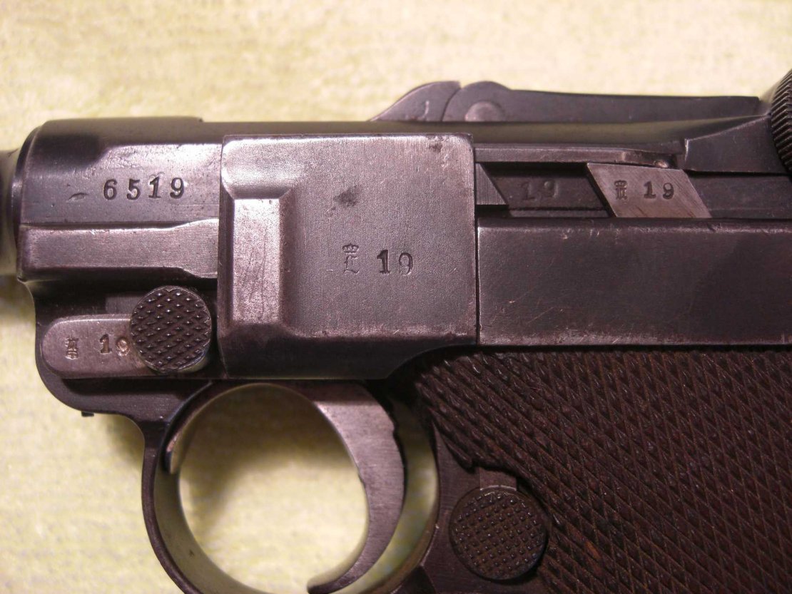

I am including some picks of the Luger and would appreciate comment on what you see/feel regarding basic condition and proofs.

Looks like a nice early WW-I Erfurt P-08.
I can't tell from the photos. Does the finish on the barrel look different than that on the receiver and frame?
I believe that that Eagle over HzA proof mark is an army repair depot rework mark from WW-II. A salt blued barrel could have been installed on your gun at that time.
If your Grandfather has the paperwork that authorized him to return to the US with his pistols, that will increase the value to a collector.

1914 was a rarer year for Erfurts. Only 7000 made. Does yours have suffix? Look on the front of the frame for the serial number, and a script letter under that. There is some controversy about this year. Some hold that only those without the artillery notch, the cut out just above the chamber date, and the long, unrelieved sear bar are true 1914s. All other came some time later

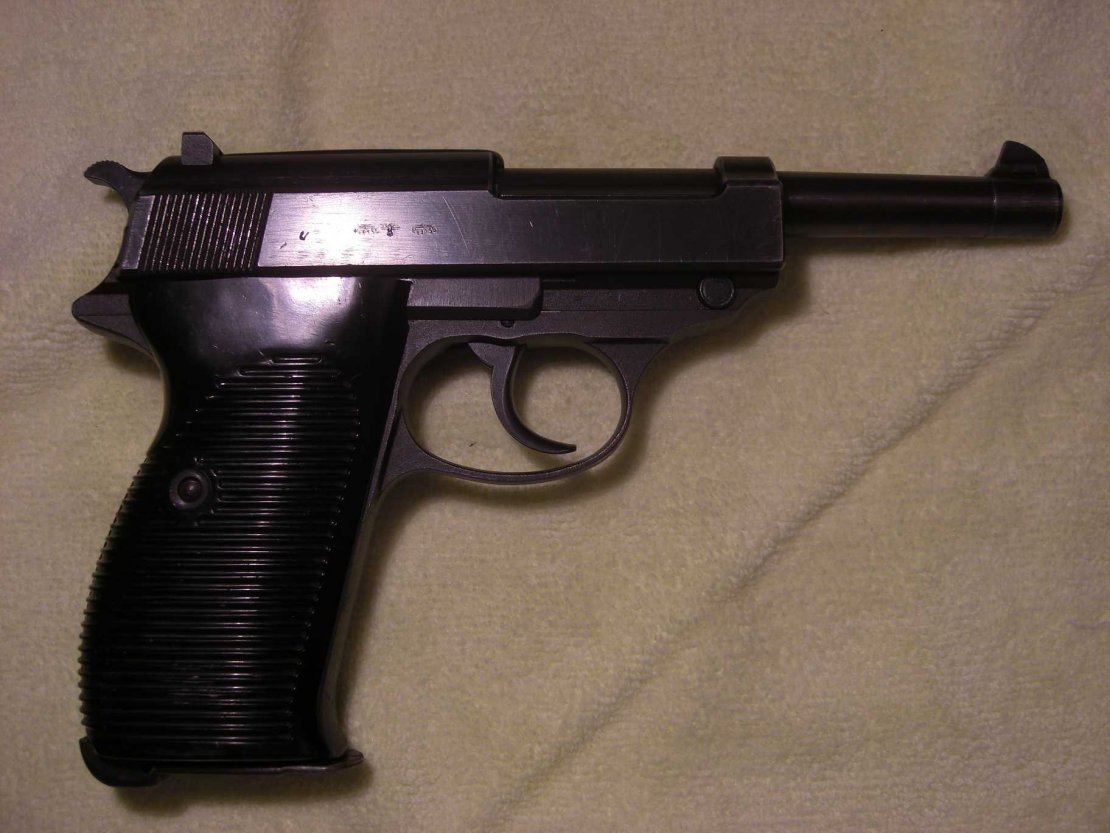

Don't be shy about showing the P-38 either...We all have one, and most are members of P-38 Forum as well...
Here ya go:

Hi Marc,
The Barrel finish is the same as the rest and it has all matching #'s

Very nice pistols. Your 1914 dated Erfurt P08 started out life as an LP08 or artillery model. Total production of 1914 Erfurt LP08s is estimated at 25,000. It was probably modified during the Weimar period.
