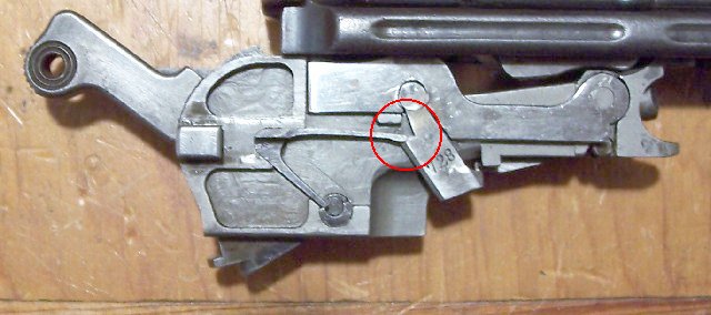

I think it is an early prewar commercial from the little I have been able to study the matter. Here are some pics that might help, some of which show the problem with the hammer apparently failing to engage the sear, or as you say the trigger failing to disengage. Otherwise the gun works fine.
I paid attention to your plunger suggestion. I am using Titegroup, which is a pretty quick powder, a lot quicker than HS6 - gives a quicker pressure spike than the older powders the guns were designed around. Have had functioning problems with too fast a powder in a Steyr-Hahn once and had to go to HS6, but have not heard of this problem in Brooms.
Does the disconnector detail look ok to you? That spring barely catches the ledge of it, and the top is a very loose fit.

The first picture shows the problem. Either the rocker plunger or the disconnector does not work on this gun. As you can see, the hammer falls into the locking notch under the bolt while the bolt is open. This is impossible on a healthy gun with rocker plunger.
Earlier Mausers, Conehammer, Transitional Large Ring, and Italian Flatside do not have rocker plunger, so the hammer is not disconnected from trigger while the bolt is open. On this gun, the disconnector is supposed to be pushed away from the trigger by the plunger when the bolt is unlocked. Without trigger support, the disconnector under force of the "V" sear spring brings down the sear, so the hammer cannot be released at bolt open position on a healty gun.
To figure out what's going on -- take the lock frame out, and couples the bolt lock on top of the lock frame (like gun assembly). Using fingers to push down the bolt lock to emulate unlocking, and observe the behavior of the plunger and disconnector.
Then, put the lock frame into the grip frame without upper barrel assembly, coupling the bolt lock on the top, repeat the previous process, also add hammer cocking, trigger pulling operation into it, you will figure out what's wrong.
From other pictures, the disconnector and sear does not fit well. Also, if I remembered right, the sear of this period is also supposed to be numbered (? don't have my collection at hand, no way to check, I could remember wrong on sear numbering. Mauser changed back and forth on this). Please also note the sear spring's coupling with disconnector is marginal on this one, which is also very suspicious.

Your sear spring/hammer pivot should be resting in the notch atop the sear arm, not pushing it forward from the rear. TH
Unread 03-15-2010, 04:05 PM   #6
+ 1
Spring broken?? Do NOT buy one from Numrich! They are not heat treated; they will bend like coat hanger wire...
Here's what it should look like -
Yeah, I kind of got that impression. It would require a new longer spring to fix that, or else TIG weld some more metal onto the disconnector.
The problem here is almost certainly in the disconnector - I peened the sear out a little bit to tighten up the fit of the disconnector on the sear and it changed the problem - it made it worse. Appears to be fitting just a little too tight, and restricting its movement - easy to fix, but I'm not removing any metal until I am sure since I don't know if I can get any more parts if I mess this up.
I don't see much chance of getting a new disconnector from what I have seen, nor a spring, so I guess I will have to work with what I have. Looks like the sear needs to have more downward tension than the setup is presently providing. I need to understand exactly how that disconnector works before monkeying with it further - I still don't see exactly how it interacts with the trigger below it, does the tigger hold it further back than its position in the picture above? Sure would be nice to find a cutaway drawing or something that shows the operation of the gun. Anybody have one?

If your hammer is not cocking correctly on recoil, it may not be the sear arm (what you are calling the disconnector) that is at fault. It may be that your rocker plunger (part #11 in GPC exploded view) arm may be too short to activate the disconnector properly. It took me several days to find that this was the problem on a Red Nine that had this problem. TH PS: I do have most ORIGINAL broom parts in stock

Found the problem, it was visible in the photos I posted - the sear was not properly fitted to the pistol, and was not able to sufficiently engage the hammer. Just had to stone the bottom of the sear a bit to allow it to drop to the sear stop - you can see how much space there was before. I agree that the disconnector/sear arm spring enagement looks a bit flakey, but it doesn't come off and appears to do its job.
The pistol works fine now.
