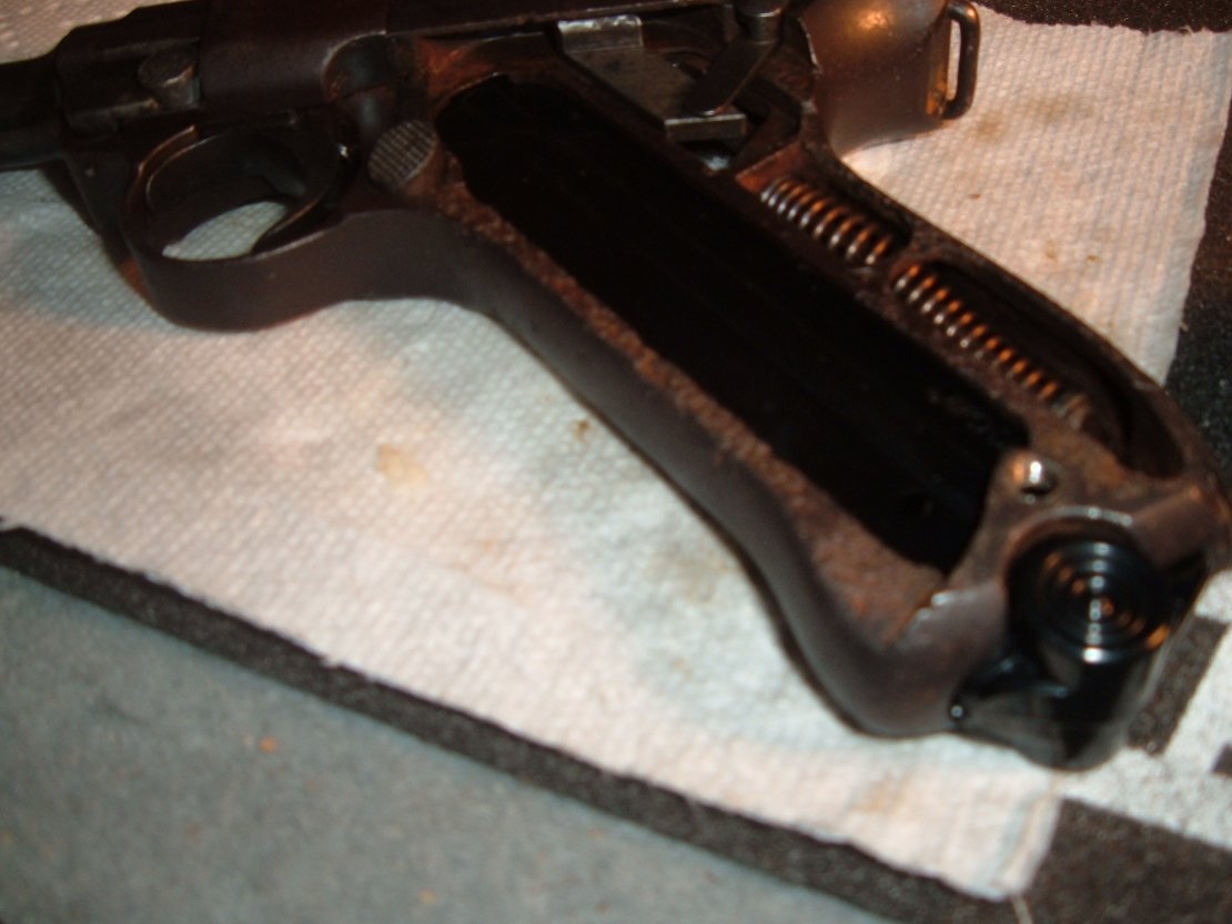

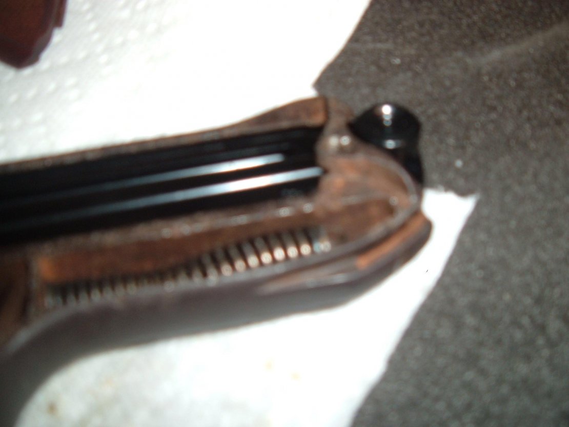

I didn't know I had such pitting until I removed the grips on my Luger.
I would like to be able to fix the pistol up but I am not sure how to deal with deep pitting or how to tell how much is too much.
I took some photos, but they are not real clear. You can see the rust for sure.
[ATTACH]luger -gunsmith 004.jpg[/ATTACH]
Any ideas on how best to stop the rest and then re-blue or ?

I am playing with this. The traditional solution is removing rust chemically, TIG welding over pits, and then machining it. Of course, not easy, currently I can only make things looking worse, not better. But, anything has a starting point.
There are professionals offering service in this domain.

1. Do not reblue.
2. Soak the rust with oil...even 3in1 will do.
3. With plenty of oil, remove the active red rust with 0000 steel wool. Do not be over agressive when rubbing...patience will reward your efforts.
4. Repeatedly wipe down the treated surfaces with a clean cloth until you can't remove any more color. Wipe down one more time and lightly oil or silicone spray and replace the grips.
5. Live with the pitting under the grips. It is part of the gun's unfortunate heritage, but it is history none-the-less.
6. Rejoice in the fact that you have preserved one more artifact from an earlier era for future generations.

Unread 01-09-2010, 08:42 AM   #5

I don't kinow anything about Lugers (obviously) and I have a book on order but it's not here yet.
Can I do the rust removal and then have the pistol blued?Some parts have never been blued or coated.
I am not going to hold anyone legally responsible for their answer, but can you tell if the pistol is safe to shoot with the pitting as it is?

Blue over pits makes the appearence worse, not better.
If the rust and pits are on grip only (not uncommon, because wood panel attracts moisture), I don't think they affect shooting. But please note that with all those rust on grip, the main spring on this gun is shiny, looks like a replacement. If this replaced main spring is out of spec, the gun would probably have functional issue.
[Side Q: What's the specified parameters of main spring on 9mm Parabellum. Initial tension, how many newtons per centimeter compression, etc?]

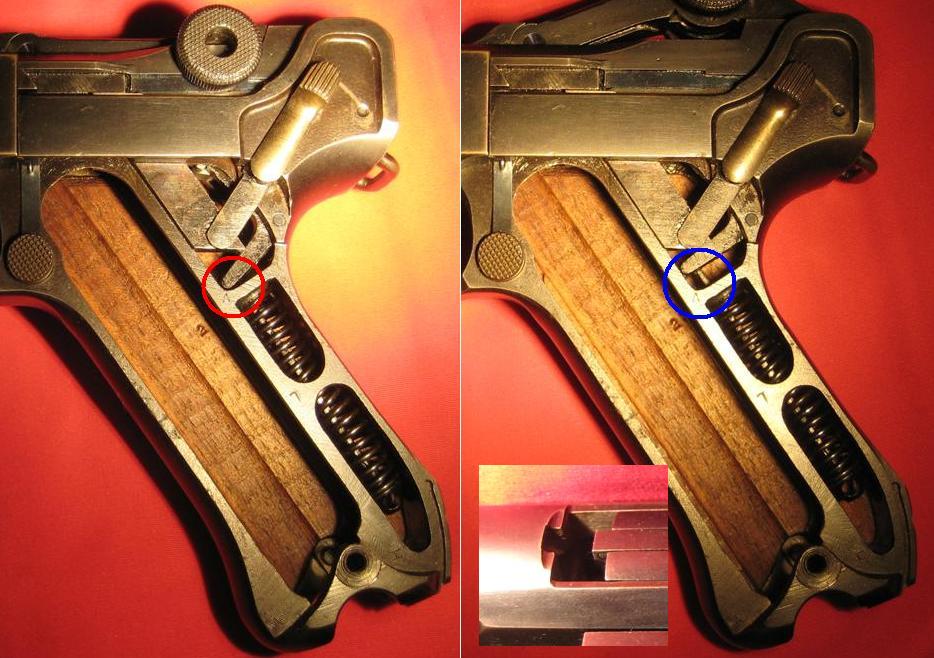

alvin,
MY main concern is, will the frame stand up to repeated trips to the range because I bought it as a shooter?
Sometimes the toggle doesn't want to close all the way when I pull it back about a half inch to set the trigger.
Is this normal or could it be part of a new spring issue?

It is normal. Only partially opening the action does not place enough tension on the mainspring to completely return the toggle to battery. Not only does the action not have enough inertia to fully close, it is also working against the firing pin spring while closing.
The pitting on the grip frame, in itself, will not make the gun unsafe to shoot. There is plenty of metal left. Removing the pits and rebluing the frame isn't going to make it any stronger.

To prove Ron being right, I tried on a gun. At you can see, a few millimeters compression on main spring (RHS) won't close the bolt.

Way to go Alvin. You are getting very good at understanding and illustrating the finer points.
