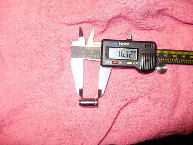

I've called ten gunsmiths in a 30 mile radius of my house and no one has the tools on hand to check headspace for this pistol. I will keep trying until I find the right gunsmith. No worries, since I'm having problems Ill get it checked out.
About the gages that I'm using, they are rented from Elk Ridge Reamer Rentals. This is a company that specializes in renting tools to gunsmiths so I have to assume that they are correct. (Imagine the liability of shipping bad gages.) They appear to be milled steel in roughly the shape of a round. The are hand engraved: "30 Luger GO PPG 3.00" and "30 Luger NO.GO PPG 3.00".
I am using page 28 of this as a guide: http://www.saami.org/Publications/205.pdf
These are hard to measure, but distance from the rear of the gage to the beginning of the necks are: (See photo)
GO - 16.32mm
NO GO - 16.59mm
According to the SAAMI document, for a shell this distance is 15.893mm. Is that difference the required headspace?
I don't have any ammo for this. If FedEx is to believed, that will change Tuesday. I have to say though, that I am not comfortable using live ammo to test anything. I have Zoom snap caps for this purpose for the other firearms but am unable to find them in this caliber. I'll see if I can talk a reloader into making me some dummy rounds.

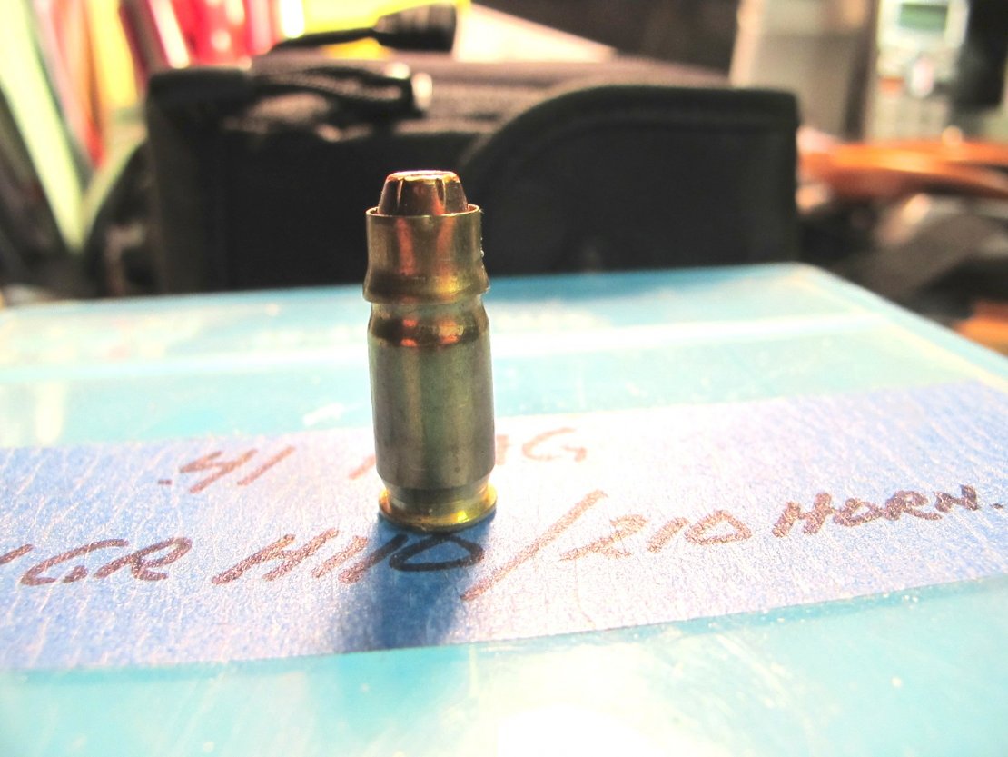

Something that you might check, is to see if there's a separated case stuck in the chamber. It's a long shot, but it does happen.
Here's an example. Fired a .30 shooter with a handload that I have used in every .30 that I have owned. The previous round separated ejecting the lower half of the case. The subsequent round jammed itself into the upper half that was still in the chamber. When I finally got the toggle open this came out.

I went to the gunsmith yesterday. Here is my story.
I called the nearest Gander Mountain and talked to one of their gunsmiths. Yes, they did have a GO gauge for a 30 luger and they could look at it while I wait. It's a 40 mile drive for me, but they have what I need, so I head off.
I stripped the pistol to just the barrell/reciever and bolt slide before I got there to avoid having to check it in. I also removed the extractor and firing pin.
I handed it over the guy at the desk after telling him what I needed. About ten minutes went by and a really nice guy named Tim called me back to the window.
"We don't have any headspace gauges for this."
Grrr. I explained that I called beforehand and someone assured me that they did have the gauges, but it didn't matter. They didn't have them. That's life.
So, I told him my whole story and handed over the gauges that I had rented. I wanted them to have their own gauges for independent verification, but what can you do?
After about ten minutes, he called me back over.
He said that the gauges were the correct ones and that they was nothing in the breech or barrel preventing them from seating fully. That was kind of good news because it meant that I wasn't just being an idiot.
He said that it was very close and it may need "a couple of thousandths" reamed out.
Here are his three theories on why it failed the GO gauge:
1) It was always like this. Perhaps it came from the factory with a minimum of headspace.
2) Maybe the pistol is at the minimum of headspace and the gauge is at the max tolerance for minimum headspace. For a GO gauge the manufacturer would want to be a bit longer than a bit shorter. Gauges for rimless cartridges are hard to measure because it has to be from the "datum" line which is half-way down the neck.
3) Maybe it had headspace problems in the past and a _very_ skilled gunsmith milled down the collar but didn't ream it quite enough. There wasn't any obvious signs that this had happened, but a good gunsmith could do it.
He said that they didn't have any ammo to try with it but if it fully closed on a round and the bullet didn't show any signs of being forced in, he'd fire it. He'd be happy to order the reamers and do that work, but he didn't think that it was necessary.
I reached for my wallet and asked how much I owed him. "No charge. I couldn't fix your problem. Next time bring me something that I can fix." Did I mention that he was a great guy?
I should be getting some ammo today or tomorrow so I'll see how that goes.
Rob

Unread 02-03-2010, 04:29 PM   #17
MileMarker81
Join Date: Jan 2010
Posts: 7
Just to be on the safe side, hold the gun well away from your face and body for the first couple of shots. Better still, find cover and fire the gun around a barrier with your body and face protected. Ideal would be a ramsom rest with a remote triggering system.
Not paranoid, just have seen too many things happen.
Sounds like great advice to me. Will do.
The ammo came today and it fits well. The bolt isn't forcing it into the chamber and it's closing all the way. I have to assume that the gauge is long.
