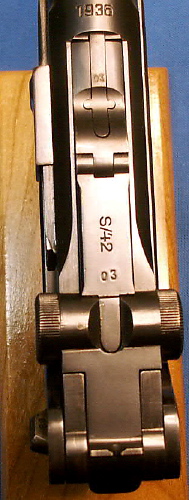

I'm going to go way out on a limb here. From your picture, 1936 and 7.65 do not jibe. Ask some questions of the seller:
1. The top toggle marking. Probably has a script DWM on the toggle.
2. Look for a crown over an N on the left front of the slide. Somewhere on the piece there may be a stamping, 'Germany', or made in 'Germany'
3. Get the serial number off the front of the frame, including any letter suffix.
This forum can tell you a lot about a luger, but we need some facts/pictures to work with.
FN
For reference, here is what the top of a 1936, military 9mm looks like:

Agree, Ed, But from the picture, again out-on-a-limb, I'm thinking alphabet series. I don't know how/why 1936 keeps popping up.
FN
