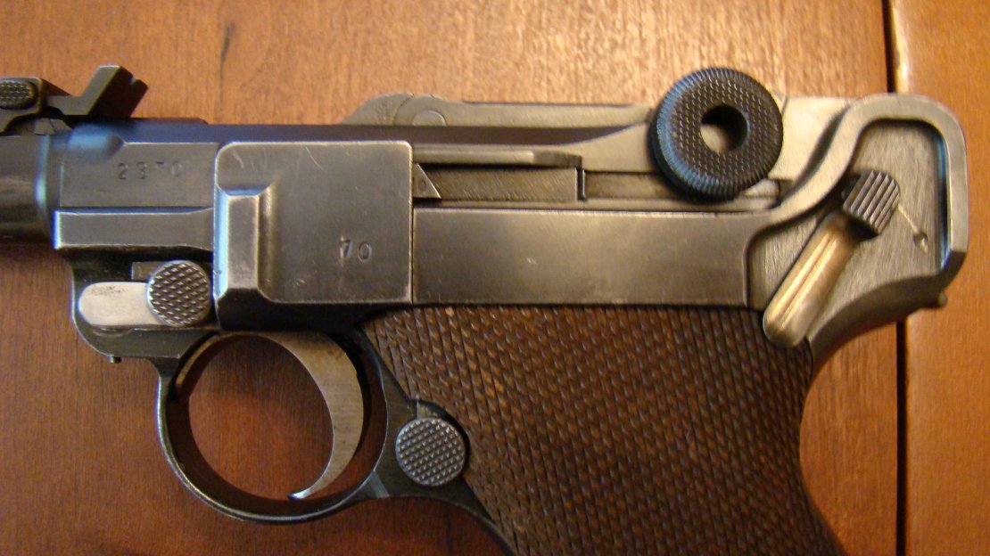

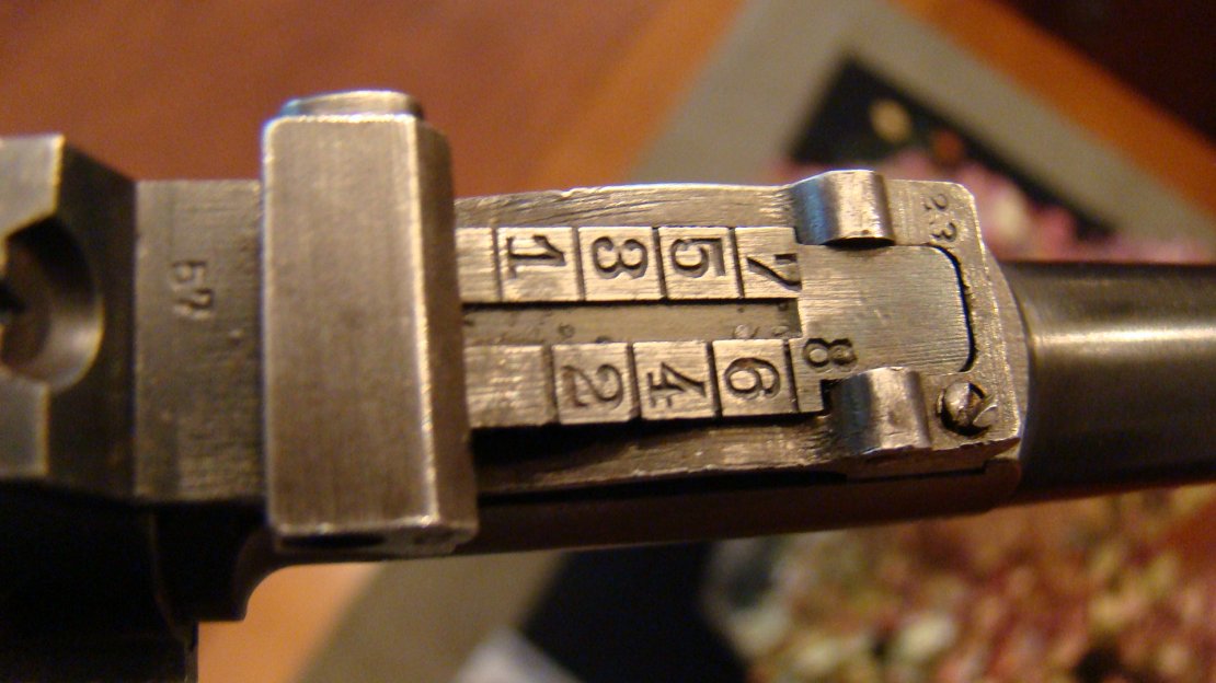

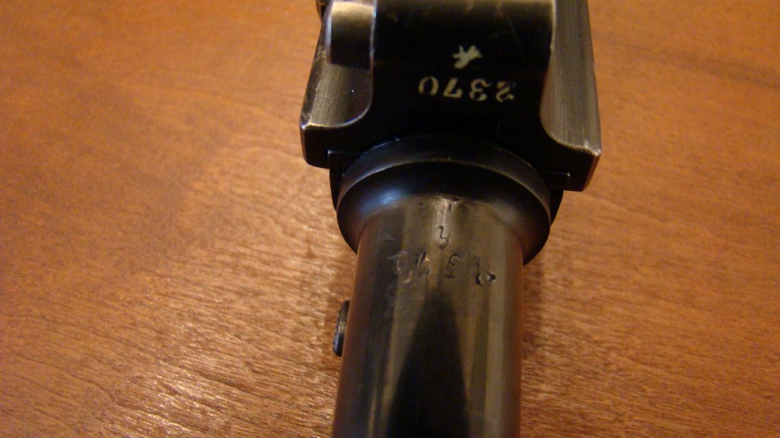

Hi,
I finally got around to doing some pics of my new arty. I'll post them three at a time.
Recap: DWM 1917, has mismatched numbers on rear sight.
Anybody notice any other "areas of concern"? Thanks.
Bob

The take down lever is not correct for an original but might be explained if the pistol is marked "GERMANY". There also appear to be some issues with the barrel. I would suggest that, using a light and glass, you examine the markings on top of the barrel underneath the rear sight. Those numbers will confirm if the barrel is original to the pistol.

Have to agree with George. The barrel shows signs of being worked on, a possible replacement.

Hi Bob, I guess no one wants to be the bearer of bad news, but since you ask, here goes. The barrel looks to have been renumbered to match the frame. This, of course, would also explain the mismatched rear sight. Regards, Norm
Unread 01-04-2010, 10:04 PM   #13
Bob, I like every Artillery I come accross..Some better than others. Like Norm I don't want to be overly critical. Many collectors have NO Artillery so you are lucky to have one!
The rear sight ramp, with the graduated numbers has been monkeyed with. It should be in the white with the numbers blackned. It appears to have been blued?
It's odd that the takedown lever is marked on the underside in the commercial manner...
Like George says, take a close look at your barrel. It's been messed with in some way.
Get a nice original stock and holster for it and see how it likes the range!

Is there a notch cut in the top of the receiver for the rear sight?
It is most likely there I just can not see it in any of the pictures.
I would like to see a better picture of the end of the rear toggle?
thanks

OK, I asked for it. Too bad you guys can’t hear me banging my head against the wall.
Thanks much to all who commented. And to LugerVern, yes the receiver has been notched for the rear sight, the rear toggle has no V sight.
I just got done looking at the afflicted area under a medium-power microscope, and have determined the following:
· The area under the barrel and receiver have an index mark; it lines up, but wasn’t struck at the same time (that is, looks rematched)
· The area under the barrel has a bore diameter marking of 8.84; however, the top (toward the muzzle) approximate one-half of the stamping has been filed and/or buffed out
· The serial number (2370) has been badly struck over partially filed or buffed-out numbers, which appear to be 1741
· The 0 is a different font from the 0 on the side of the receiver
· The h below the serial number has been buffed almost to obliteration (and why is there a letter here? I thought they were only marked on the front of the frame?)
· The h in the serial number is a different font than the h on the frame, which actually may be a k
· The eagle (?) marking on the side of the barrel is different from the one on the right side of the receiver
So, 1) the original number 1741, the h, and the 8.84 were partially filed (file marks observable) and then buffed; then 2) the number 2370 was very sloppily struck over the former numbers; and finally 3) the affected area was touch-up blued.
So the barrel is a force-match to the rest of the gun. Also explains the mismatched sight parts. But who would go to all the trouble to renumber a barrel and do it so badly? And to leave remnants of the previous markings? Seems to me that you could remove the serial number and keep the 8.84 intact, but they didn’t. Like they didn’t care what it looked like.
I’m probably reading too much into this, but this looks to me like an arsenal repair/rework job. If it was some present-day scumbag trying to boost a gun they would have done a better job. A German armorer wouldn’t care what it looked like, just so it’s fixed and functioning (and properly serialized).
Any comments? Thanks for reading. This post is entitled, “Grabbing at Straws”.
Bob

Unread 01-07-2010, 04:14 PM   #16
I couldn't disagree more. This was a hack job by bubba. A German armorer would have the proper tools & CARE what it looked like , proud of the end result.
Don't fool yourself into thinking this is an arsenal repair/rework job.

No. Simply elevate the sight to its maximum and then using a light and glass determine what the numbers are on the top of the barrel beneath the sight. I am not referring to numbers on the sight base but on the barrel.
Unread 01-07-2010, 05:54 PM   #18
Bob, DO NOT attempt to remove the sight from the barrel unless you know exactly what you are doing! These sights are actually fragile and some are held in with set screws. A good Friend broke a sight base in 4 pieces because he was un aware that a set pin existed. In his defense he was un able to raise the sight ladder to see it..
Just do what George says...

Weasel505
Posts: 46
Default Just gets better and better
Thanks for the warning about removing the sight. I've gotten so wrapped up in this I probably would have tried it.
From what I can see under the sight, with the sight raised to maximum, is:
- stamped perpendicular to the barrel (i.e. like the date), the numbers 442
- stamped parallel to the barrel, just above the 442 (toward the muzzle), the number 3. The 3 faces the rear of the gun.
Once again, any comments, O Learned Ones? To answer my own question, yes, I'm a bit disappointed, but not terribly so. The pistol is in such great condition. And if this is a reblue job, I'll eat it.
I guess I'll just have to be happy with owning the finest friggin' shooter-grade arty ever.
Thanks for the help. You guys are great.
Bob
Weasel505 is offline   Reply With Quote
Unread 01-07-2010, 07:05 PM   #20
Bob, based on what you see under the sight I would say that the barrel is from another gun. Just shoot it and enjoy yourself.
