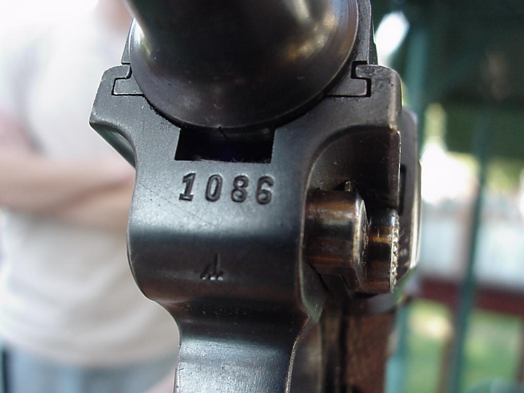

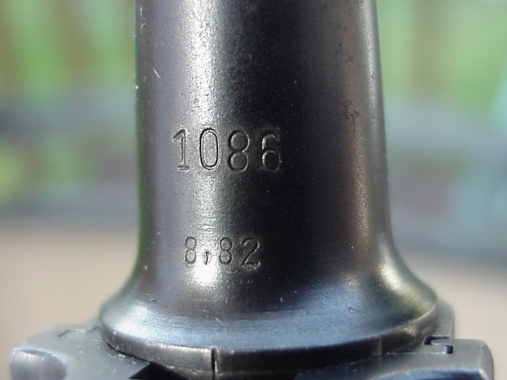

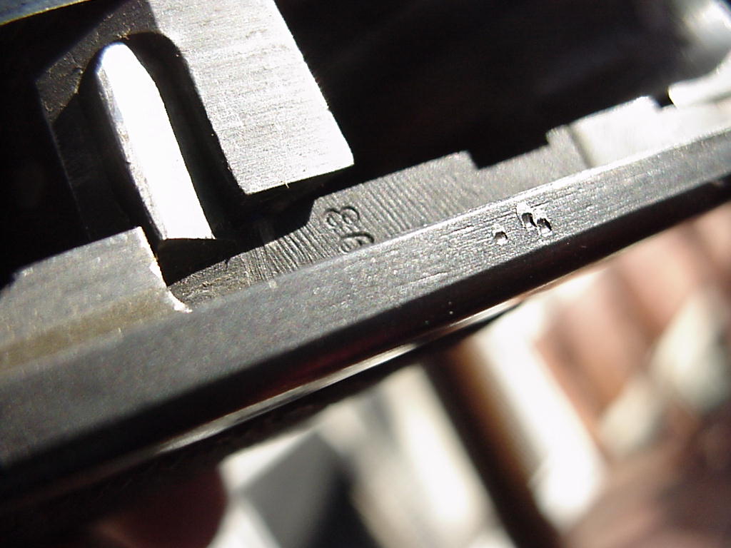

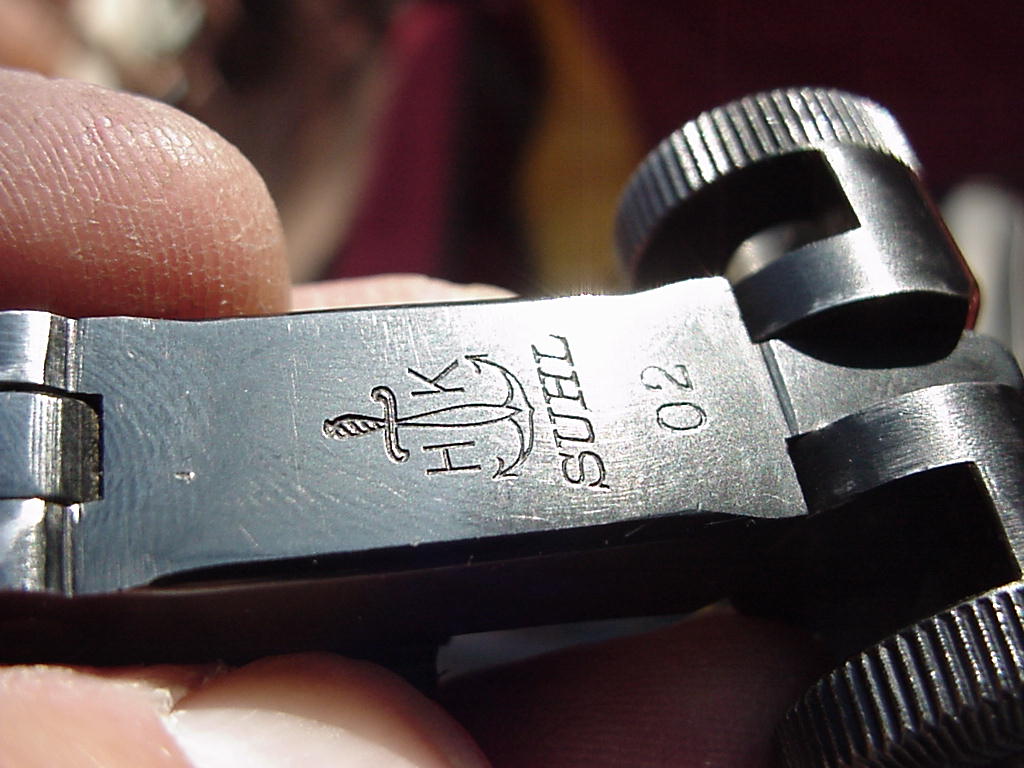

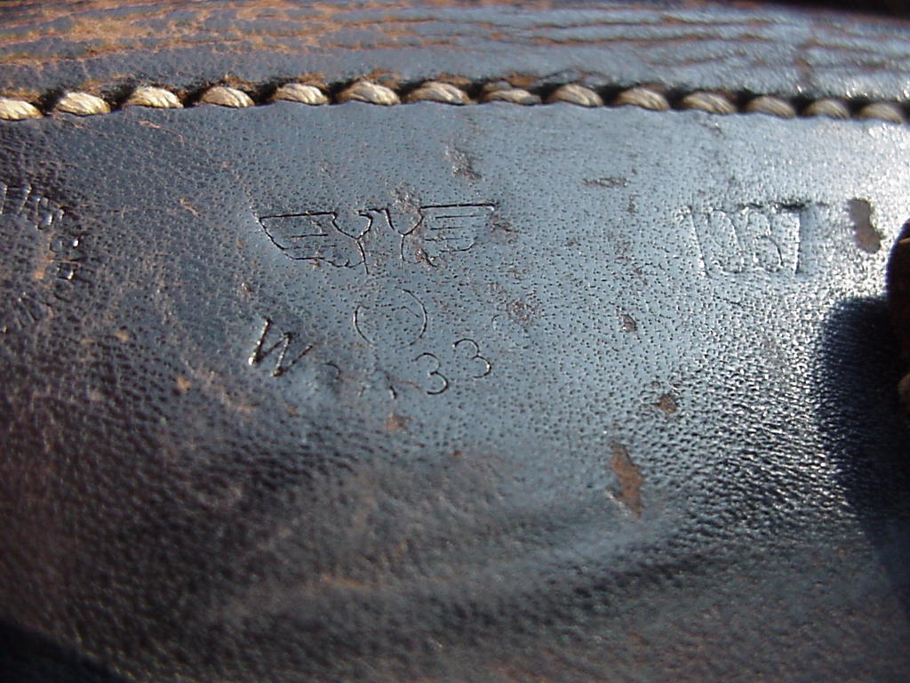

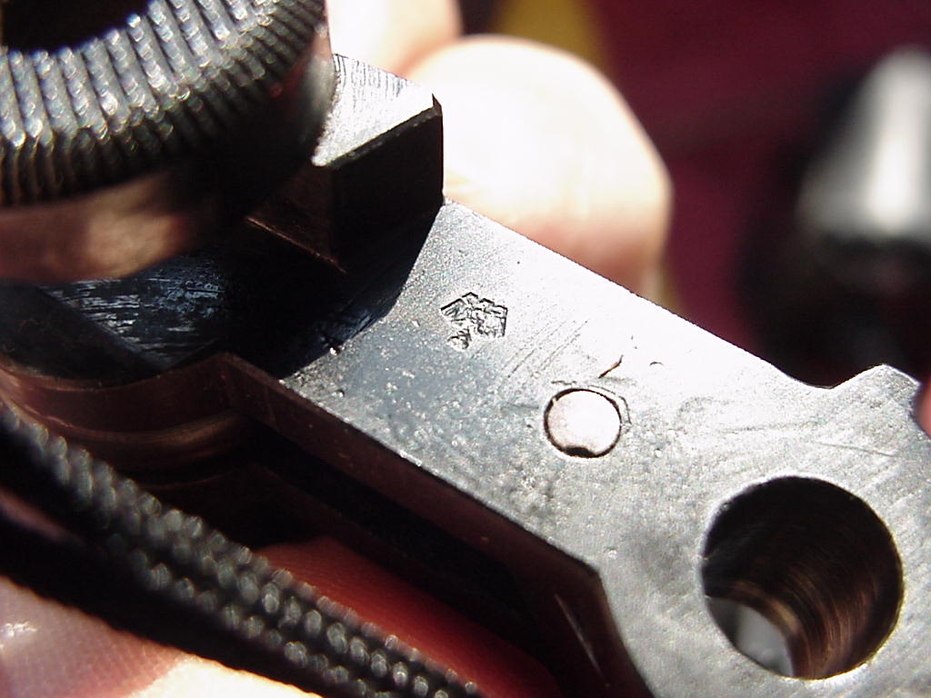

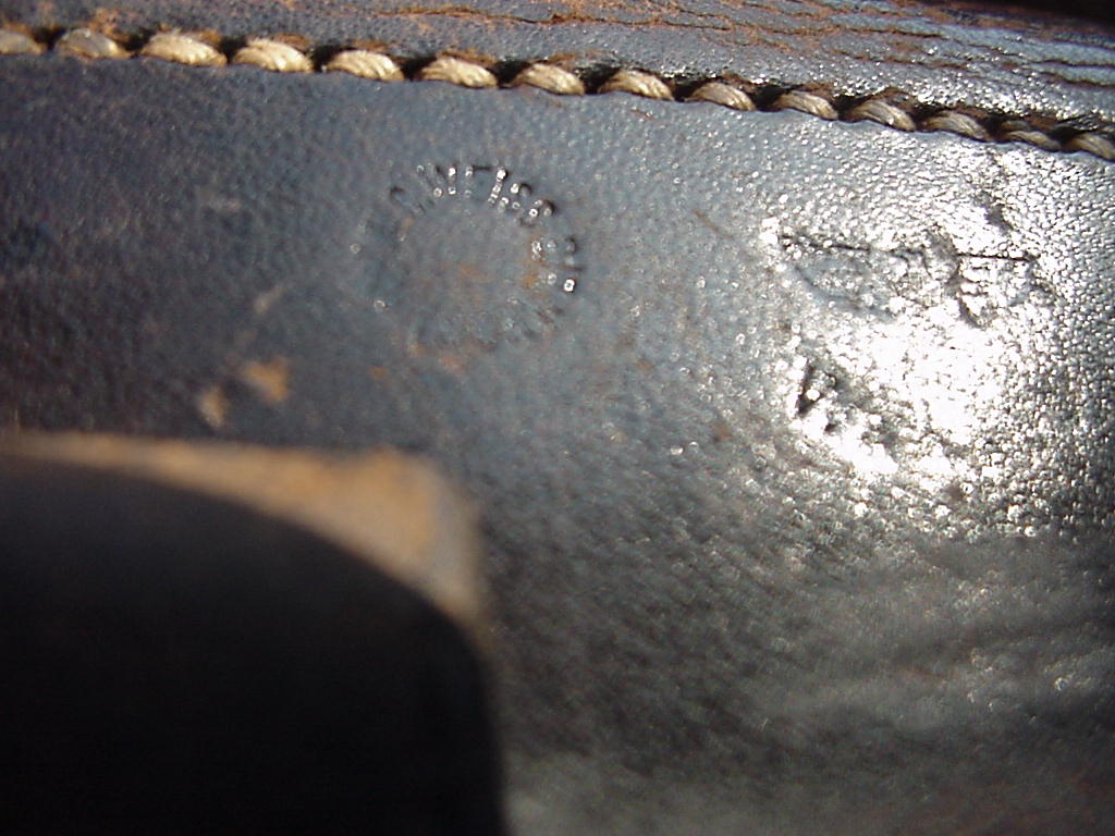

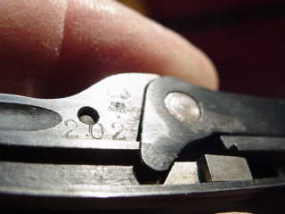

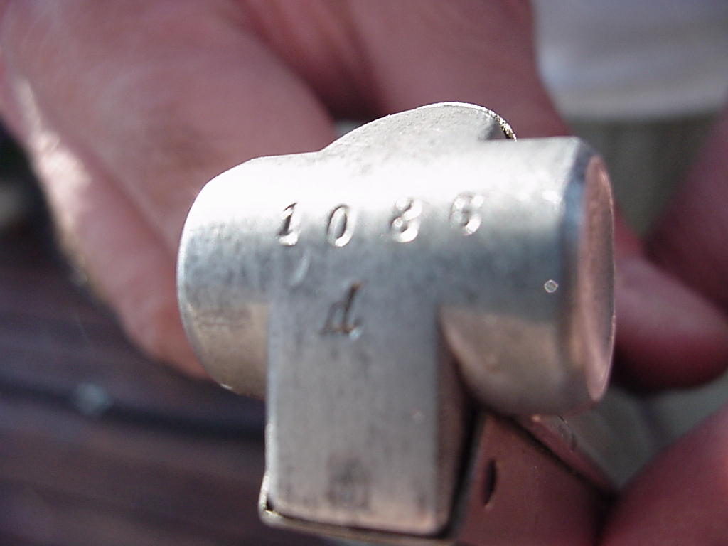

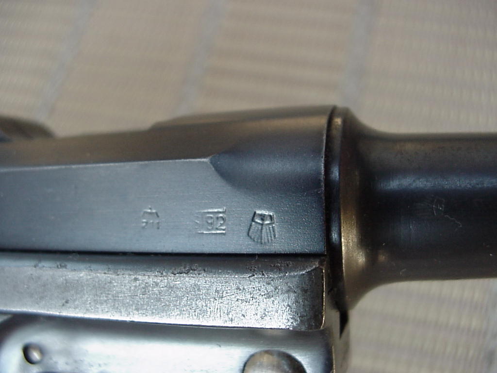

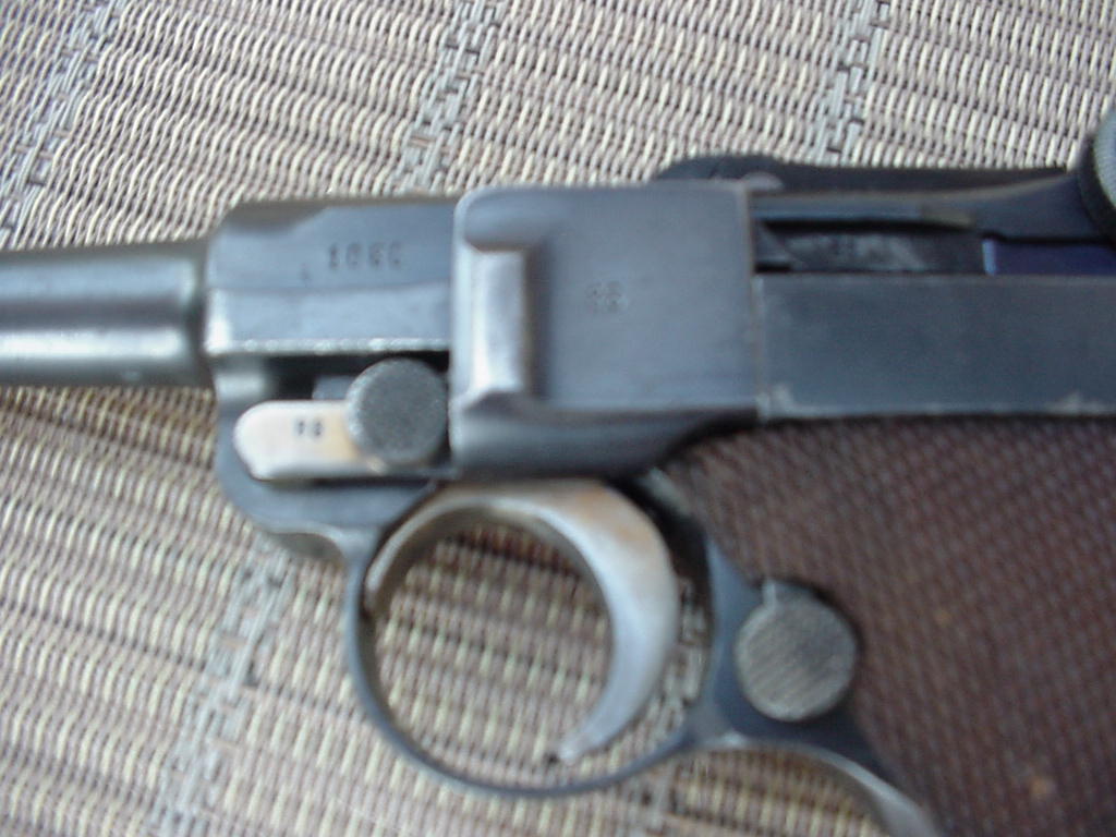

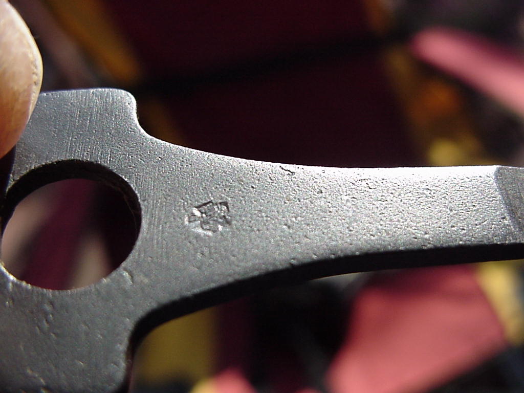

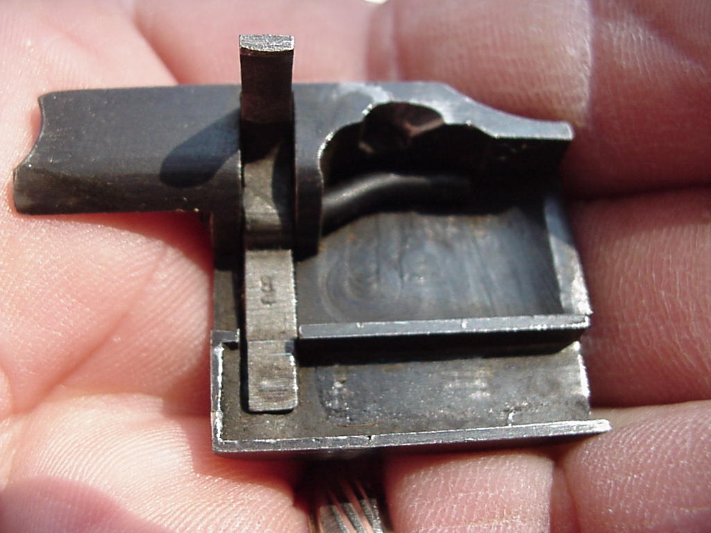

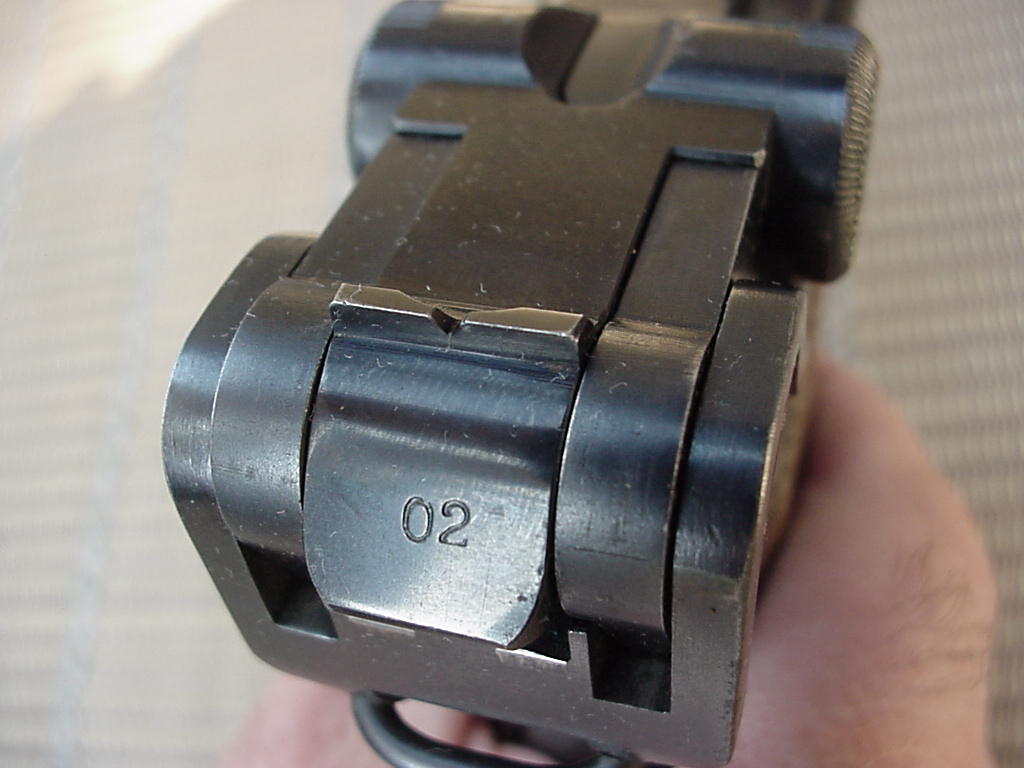

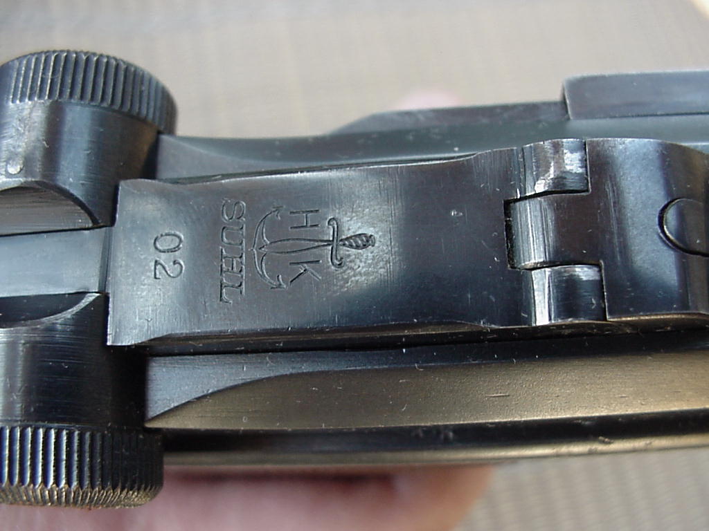

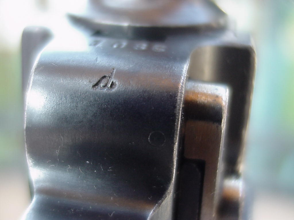

An aquaintance had this luger his dad found on a greyhound bus years ago, probably in the early 60's and was showing it to me. My pictures didn't come out too great, but it has the suhl marked togle and a G dated on the top of the barrel picture came out blurry but it is G dated. The toggle doesn't match the rest of the gun. The rest of the gun is matching numbers except the firing pin which is un numbered. So, my question is this a G dated military with the HK toggle put on later, or is it a G dated krieghof? I hope you can tell from the pictures.

I'm going to guess a Mauser with a HK toggle. The proofs are OK, but not sure about one of them. The serial number puts it in the last third of the G dates. (930a-5000f)

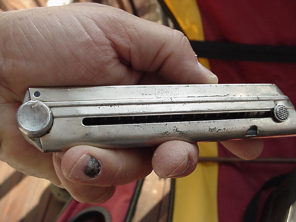

What is the proof on the bottom of the mag?

My dang picture is too blurry to see. I'll call the guy and see what it is. So, it most definetly isn't a G date krieghoff? Just a G date military with a added on toggle, right?
