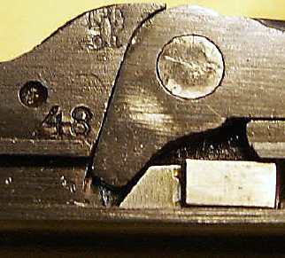

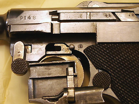

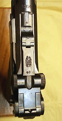

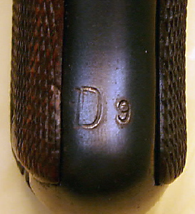

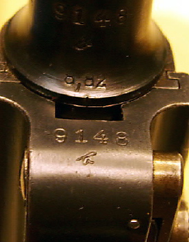

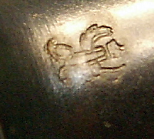

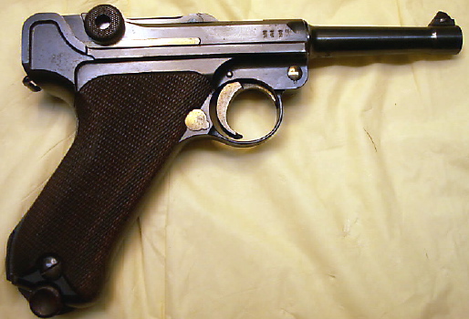

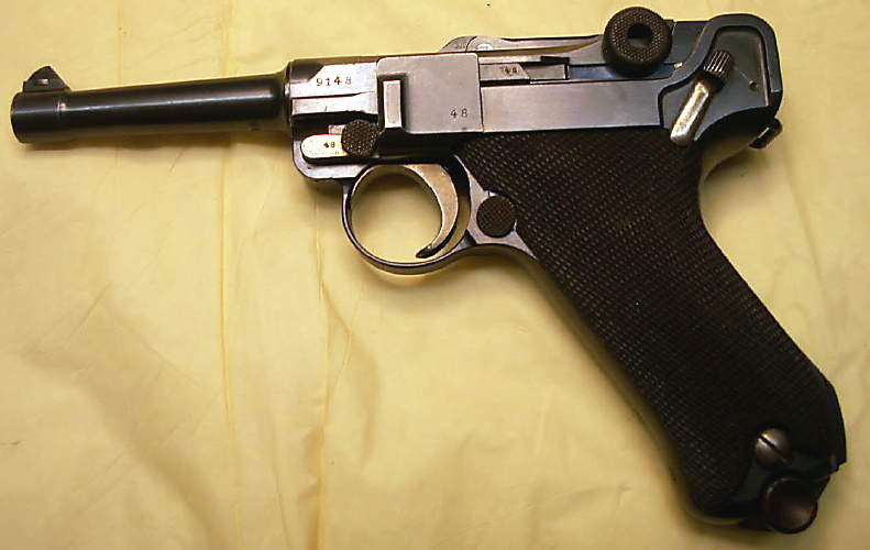

I love gun shows. They're there, ya just have to hunt for them sometimes. All matching and pretty. Maybe someone can explain the front strap marking...?

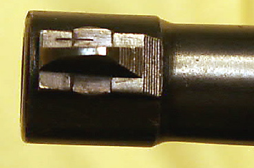

Barrel and sight witness

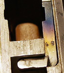

Ooops. It is a DWM magazine, correct for that period, but unmarked. It does look like the pin has been taken out.

The grip strap marking is probably not police.

A beautiful 1914 marked to Dragoon Regt. 9. Most likely a provisional mark, or a Stab (staff) pistol due to the lack of a Squadron or weapon number. A very desirable Cavalry unit mark.

If it ain't aviation, I don't know much about it. What's a Dragoon? Mounted Infantry? Where to find out more about the 9th?
There is so little wear on the muzzle and side plate, it would make sense that it was a staff weapon. Or at least someone who didn't draw/use it much.
