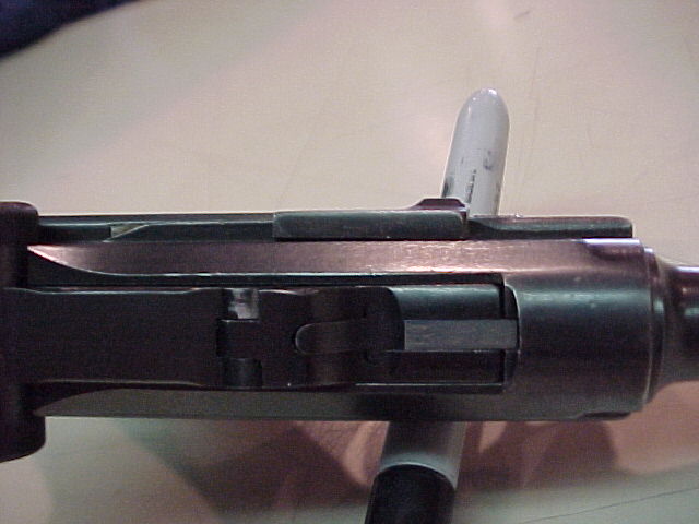

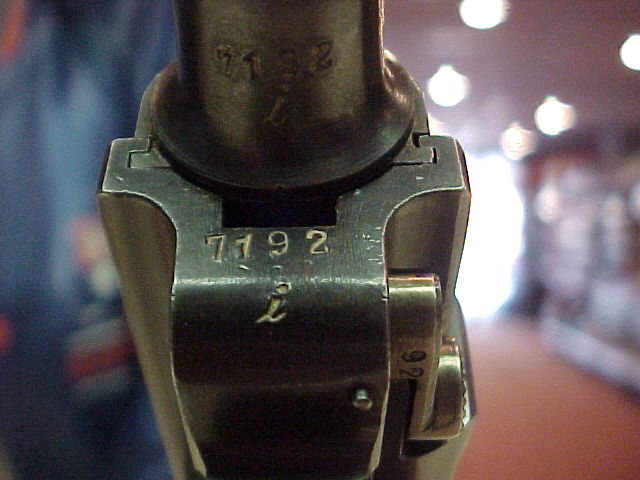

A friend of mine recently acquired a very rare H/K. I was able to fondle it at the last local gun show that he brought it to. He asked that I put it on the forum to get feedback. He was a friend of Randall Gibson. When Randall Gibson started to get ill, he sold a large portion of his dagger collection to him.
Here is his letter to me with one photo... more photos in a few days. I told him how much you guys enjoy Luger porn.
Mike,
Enclosed is a photo of the Luger Randall Gibson in his book 'The Kriegoff Parabellum" describes what he called "merchandise Lugers". My H/K Luger #7192i fits into Randall's recorded range of 2000i to 10,000i (pg 139). The subject Luger, unlike those described in Randall's book, has neither the DWM logo (blank toggle) nor the back frame "Kriegoff Suhl". The chamber is undated. The caliber is 7.65 and is marked Germany on the right side frame rail. It has C/N proofing and is marked H/K on the right side receiver (see photo) and the same H/K inside the side plate. There is a "K" marked under the forward toggle link.
The Luger was bought at an estate auction in Midland, Tx then shown to Randall. The pistol is unlike Randall had ever seen and his examination was very favorable.
Randall provided more info about such Lugers on pages 142 and 143.
I'm anxious to know what you can find out.
Thank you very much,

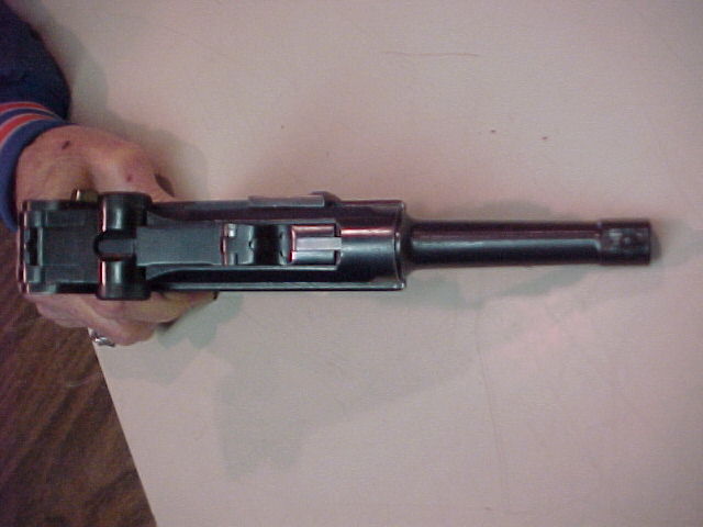

Unread 08-02-2009, 07:03 PM   #10
MFC
MFC's Avatar
Location: Louisiana
Posts: 1,237
Thanks: 183
Her are the rest of the pictures.
Mike C.
Unread 08-02-2009, 08:08 PM   #11
drbuster
drbuster's Avatar
Posts: 1,432
Thanked 71 Times in 56 Posts
Thanks for posting more photos of this interesting luger. I'm not sure they help to answer any questions about where this pistol came from and whether Krieghoff played any role here. On the surface, it is a 1920 commercial luger with "Germany" stamped on the right frame area and an upright C/N commercial proof. It is generally accepted that lugers "reworked" by Krieghoff had lazy C/N proofs but I'm not certain whether any exceptions to this occurred. The toggle is blank which poses many questions. Is there a number stamped under the rear unmarked toggle? Note the H/K marking is also inside the side plate, which adds some credibility to the marking, but as Pete Ebbink stated in an earlier post: Randall Gibson doesn't show or describe this exact marking anywhere in his book. The serial number is right in the middle of the known so-called DWM/Krieghoff "i" series, so if these were sequentially produced and sent to Krieghoff (not sure this happened) then this luger was not early. This will remain an enigma and probably never be answered. As to the late Randall Gibson's alledged acute interest in this luger, this is only conjecture as the poor fellow is not around to ask any longer.

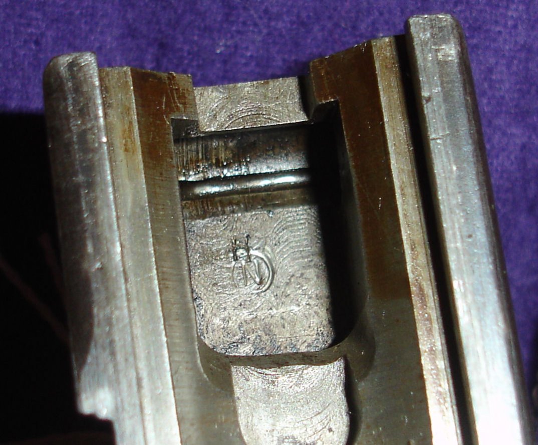

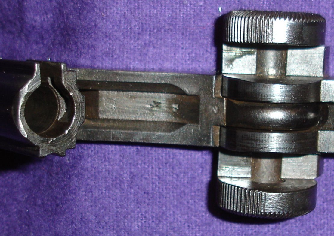

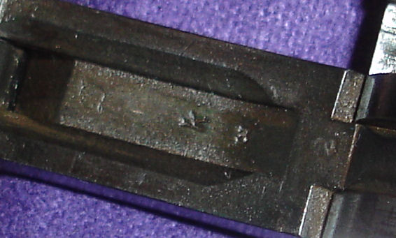

Unread 08-17-2009, 02:36 AM   #16
MFC
MFC's Avatar
Location: Louisiana
Posts: 1,237
Thanks: 183
More pics...
The #2 appears twice under the forward toggle, along with a K and a cursive capitol D.
H and circle N in the front frame well.
Small C/N proof on right side of toggle.
Mike C.
Unread 08-17-2009, 10:53 AM   #17
The blank toggle, inspector marked with a "K" inside, is typical of 1929 BKIW production. Since this part is unnumbered it could be a later replacement and reproofed, as indicated by the same horizontal C/N on the right side. This piece is not consistent with a mid "i" block commerical made in the 1919 to 1921 period. The only reason that I can think of why the inside of the side plate is H/K marked, is if it was also a replacement. Close study of the serial die sets used is indicated. IMHO, if the "i" block luger is not back or side frame marked, it was not marketed by HK. TH
Unread 08-17-2009, 12:45 PM   #18
If I elaborate on Tom's observations I would be tempted to describe this one as a pistol that somehow was serviced (repaired) by Krieghoff. Perhaps with a toggle and sideplate replacement. This would incline them to mark the pistol for warranty purposes.
Unread 08-18-2009, 12:55 AM   #19
MFC
MFC's Avatar
Location: Louisiana
Posts: 1,237
Thanks: 183
Thanks for the replies guys,
Gibson notes that a Kriegoff commercial horizontal C/N proof is smaller than the DWM C/N proof. The smaller proof on the toggle seems to fit into both of your observations.
The toggle is numbered 2, which is the last digit of the S# (usually last two digits), so it may just be a coincidence. Has anybody seen the script capitol D or the stamps in the front frame well before?
Mike C.
