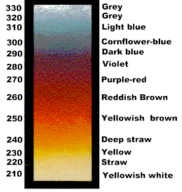

Hello Jeff,
the color is a result of the metallurgic act of steel-tempering e.g. Straw-Color. If tempering is done at higher temperature the straw-color changes to purple. Steel will be more elastic and less prone to break.
If not done so during manufacture it may have been applied during a refurbishing act.
See attached tempering table.
Hope this answered your question,
Thomas

Hi Jeff,
these are degrees Celsius, however I did some research and I believe, that the colour you described might rather be the result of some blueing or coating technigue. The typical straw-colour is caused by the tempering process.
Thomas

Some early hot dip Mauser PO8s (1937-39) with have ejectors &/or extractors with a purple color caused by improper temperature bluing. TH
