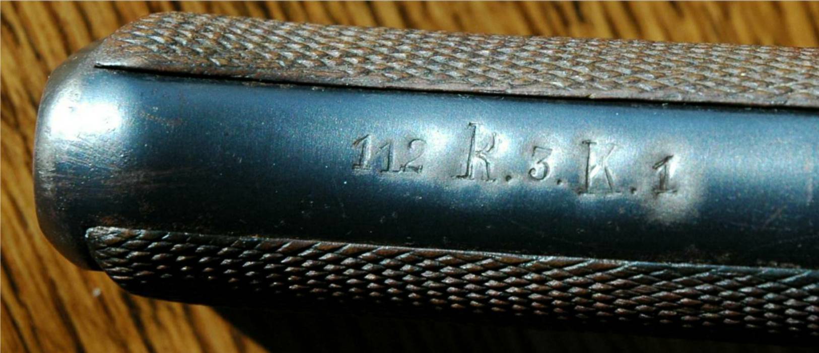

Hello!
This is my first posting on this site. I have a 1915 dated DWM with the following markings on the front grip strap-
112 K.3.K.1
Can anyone point me in the right direction to research these markings?
Thanks in advance!

Hi Bob,
Welcome to the forum. Are you certain that the first K isn't an R ? If it is, then your pistol is marked 112th Infantry Regiment
3rd Company weapon #1.
Are you able to post a good clear photo of the mark?

Well, here is a clear picture of the markings, (assuming I uploaded it correctly to the website.) After re-examining the stampings with a stronger magnifier, I saw that the responses from the forum were exactly correct. I misread the first stamping as a "K", when it was really a partially stamped "R" Thanks for the help!
larger picture:
http://forum.lugerforum.com/lfupload...tmarkings1.jpg
ADMIN: fixed pictures, ebt

Bob,
No problem. It's a common error on some unit marks.
The 112th Infantry was part of the 29 Infantry Division. And saw heavy action with heavy loses many times during the war.
