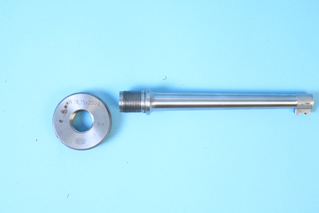

During a recent visit to Oberndorf (see "visit to Oberndorf" in my web site), I had the possibility to buy a set of Mauser Gauges used to inspect the Mauser Parabellum made in the 1970 â?? 1999 period by Mauser. Initially Mauser bought the gauges used for the inspection of the 1929 Swiss model from Bern. Mauser reused them for inspecting the new production. Not all the Swiss gauges were adequate to inspect the new production and therefore Mauser made new gauges. Hereafter some pictures of the gauges with some examples of the use. These gauges were saved from the destruction by Mr. Otto Repa, responsible of the Mauser Parabellum assembling from 1970 till 1975 and then quality responsible from 1975 till 1979. For the collector, the finding of such gauges is a rare event and could be considered the icing on the cake for any Mauser collector.

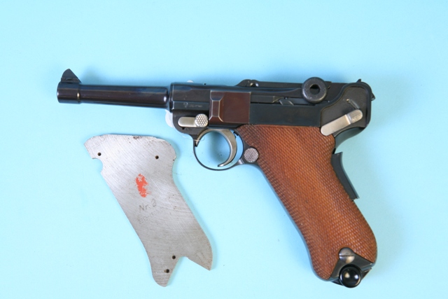

Mauro... a very nice addition to your Mauser collection.
Is this gauge used to measure the frame? or measuring grip panels?
Unread 09-17-2008, 06:59 PM   #3
mauro
FIREARM HISTORIAN AND AUT
mauro's Avatar
Location: Belgium
Posts: 1,535
Thanks: 106
John,

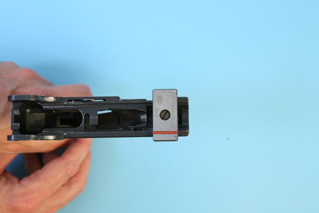

I guess this gauge is to verify that the frame shape is correct and it can host the grip. I was not able to verify it because the safety lever needs to be dismounted and I do not want do this.
Thanks,
Mauro
Unread 09-17-2008, 10:17 PM   #4
Mauro, is the gauge dual sided? So it can be used to measure both sides of the frame? If I remember correctly, don't the Mauser grips of this period use pins to secure their position on the frame? Do the holes in this gauge correspond to the holes in the grips?... and are their holes on both sides?

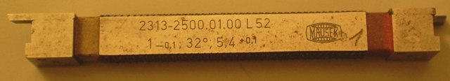

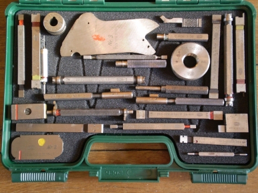

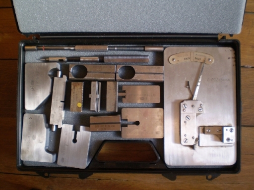

The grip gauge is not dual sided to me. I guess that the second one is simply missing. The gauges set contains 97 pieces but is not complete.
Hard to say how many gauges were made. You are right, the grips of the 06/73 model have a hole for a pin that goes trough the frame and fix them properly.
Steinar,
Most of the gauges have the Mauser Banner and some of them also the JW mark. All of them have a serial number.
We try to investigate the meaning of the composed serial number. The first part, what I call the "family" indicates most probably the gun for wich they were made. I have two set in my collection, one for the Parabellum and the other one most probably for the carbine model 66.
Then there is another number that indicates for which particular item the gauges are for. For example, all the gauges applicable to the breech block have the same number and so on...
In the picture you can see: 2313 means Parabellum, 2500 breech block and we still don't know the other numbers...
I guess that at least two sets have been produced because I have a couple of double gauges.
We are still investigating the matter and we do not exclude finding more interesting information. If yes, I will share them with the forum.

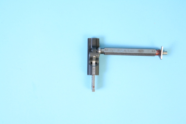

There is a barrel thread gauge shown in your photos that is marked:
W 18.5 x 20 Gg
Gut (good)
...and the Mauser trademark
Is this the European metric designation for the barrel/receiver threads used in the 06/73 Mauser? Are they the same as the barrel/receiver threads used in previous Lugers?
Unread 09-18-2008, 02:44 PM   #8
John,
The tools are indeed rather elegant good/no good tools. Some show the tolerances (for example + or - 1mm), others don't. Many have the good coded as a yellow color, and the no good side as red.
The L (for example with L52) means "Lehre nr. 52", or "Tool nr. 52". The tools appear to be numbered in groups, attached to certain main parts like Mauro mentioned.
I don't know whether the threading is Euro or US style, but the design of the barrel thread area differs from the pre-1945 design. The newer design allowed for easier placement of the barrel without having to remove material from the shoulder in order to get a good alignment.
The holes in the grip tool do not correspond with the pin holes for the grips, so they seem to have a different purpose.
