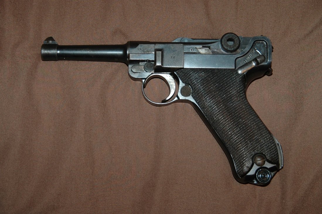

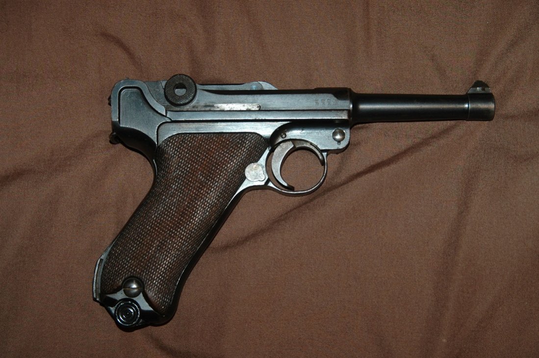

I bought the Standard Catalog of Luger for the Kindle and here's what I know.

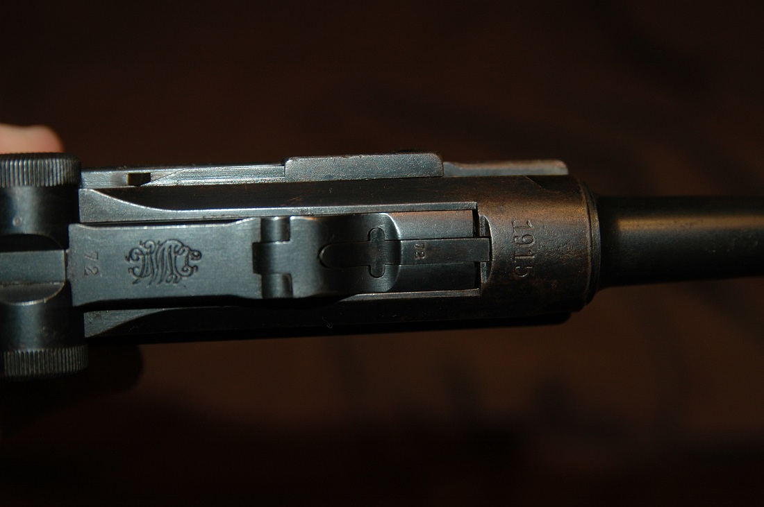

It's a 1915 DWM. All parts including internals and grip panels match. It has the proof marks listed proof 2 number 15 as listed on this website. The rear most toggle pin is lacking a number steamed into it however.
But it doesn't seem to be a reblue and it has no unit markings on the front strap. Just what I think is a M under the the trigger guard. They don't appear to be removed. They just appear to have never been there. I thought I understood that military proofed P-08 would have to have unit markings. Why wouldn't this one?
Thanks for your help,
Dave

Quite simply they were not all unit marked. Some units were exempt, for some such reason of German bureaucratic mindset.

Hi Dave, Welcome to the forum and congratulations on your new Luger. Less than 10% of 1915 DWMs were unit marked, and no Imperial era (WW1) Lugers had numbered rear toggle axles. Regards, Norm

You did fine for your first Luger. Your seems to be in collectable grade, which is always nice. The only thing I would change is the magazine, as it seems to be an aftermarket example. The correct one for this DWM 1915 should have a wood bottom and nickled tube.

Pretty nice 1915!
Notice the full length sear bar, this started to change in 1916.
