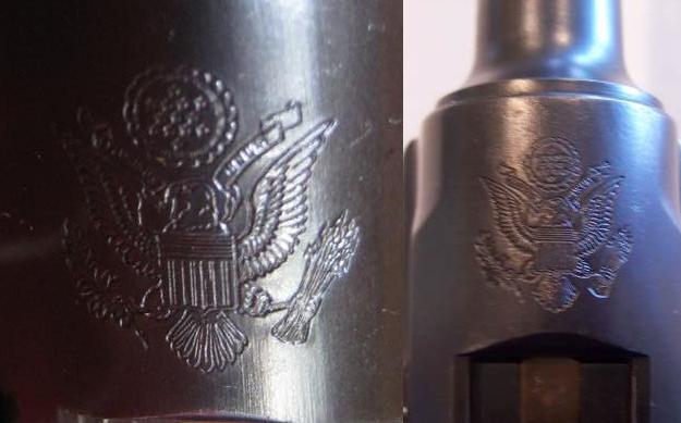

http://www.gunbroker.com/Auction/Vie...Item=103798045
It's not in Dwight's database, but it's Bannerman.

wow, a bit expensive. looks good, but I worry when a Test Luger is so nice?

Can't tell for sure from photos but looks redone to me. Straw doesn't look right either.

Is the chamber area (around the Eagle, picture 2) too smooth?
Or, is it supposed to be so smooth? or, picture problem....

Gut says it is a restoration, and not a particularly top-notch one. I believe it is a Test Eagle, but the starting bid is at least twice what it is worth. Just my opinion. Hope I don't get a nasty letter from someone's lawyer.

I have taken this into consideration; but you are talking 5, maybe 10% of the total, so maybe 100 weapons that 'could" be in much better shape, and actually I believe the number to be much smaller.
I have posted this before, but any 80-90 year old luger (especially tests) that are very, very nice, I beleive have a very good chance of being improved sometime in its life. yes, I have some very nice lugers myself, that I feel are righteous; but each nice, nice one needs to be looked at very carefully.

My gut is in the same place as Ron Wood... I think it is a restored gun... for me it is just "too blue" on the sharp edges to be original finish after this many years. That said, it is a nice gun, but way too expensive for the breed IMHO.
