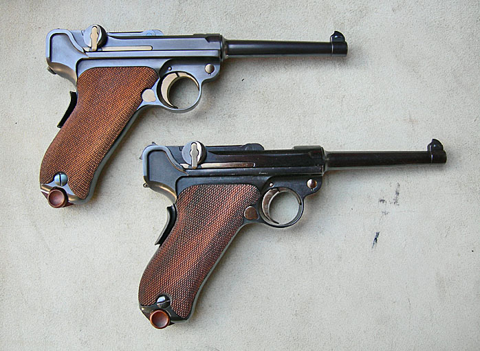

Default A pair of 1900's
Recently aquired a 2nd 1900 AE and when I received it noticed the the serial number is only 83 digits from my other one. Both of these have been "restored" but one is rust blue and the other is "dip" blued.

Very neat Hugh,
They were probably made the same day and there back together again after all those years.

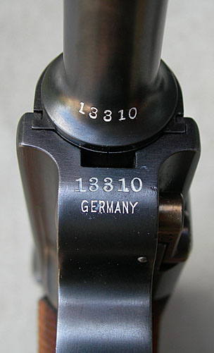

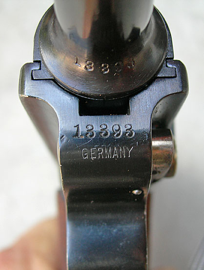

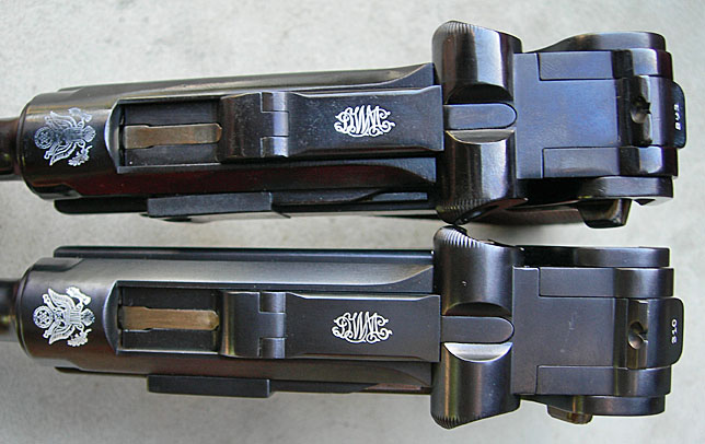

Default Serial Number Placement
Checked my two, & even tho they were made the same day or at least the same week, there is a difference in the "2 or 3 digit" placement:
SN 13310: last three digits on breechblock, rear toggle & grip safety,
last two digits on sideplate, bolt, trigger, middle toggle & grips.
SN 13398: last three digits on sideplate & grip safety,
last two digits on breech block, middle toggle, bolt, trigger, grips un-numbered.
