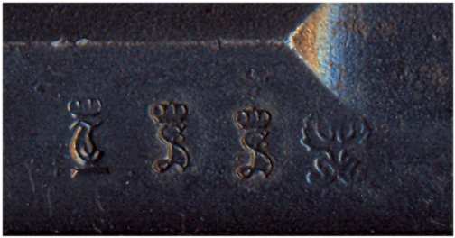

All of the acceptance proofs you speak about are stamped in seperate operations . When the pistol passes it is proofed. This takes place 4 different times. Each strike is made on it's own so a variable amount of force would be normal.

There are only two things that I would like to comment on here and they are the proof mark on the stock and the 9's on the grips. I looked at the 6-7 stocks that I have and none of them have the proof mark that is on this stock. It might not be wrong, but I will have to go through my 'World of Lugers' by Constanzo to see if I can find it. So put a question mark there for me.

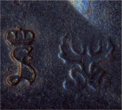

P.S. Pete & Vlim raised good points there. I feel the inspector marks and proof on this gun are not only correct, they can be used as a reference to judge other 1917, IMO. Looks like light rust was removed from the rear sight leaf of Vlim's gun in the past.

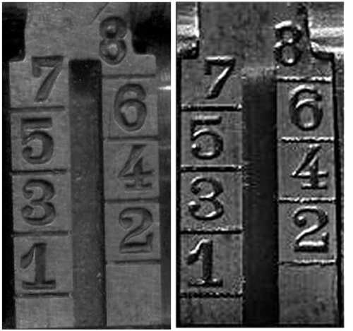

I agree with you that the sight on my guns shows some traces of wear, but I think the wear that is visible on the rear sight leaf is mainly the result of holster wear. It's the highest point on the gun and since it has been with a holster for some 90 years before it came into possession of a collector friend of mine (and later in my hands), like the blue on the side plate of a P08, this area will show the first signs of wear after being handled in combination with a holster relatively quickly. Similar wear is visible on the left side of the muzzle on an honest LP08.
Basically, an LP08 with a minty rear sight, no holster wear on the left side of the muzzle area, no holster wear on the side plate area and most importantly blued over inspector markings on the receiver, should raise some serious questions, as this all points to a reblue scenario.

As an extra for those who missed the other discussion, this is a detail photo of an inspector's stamp and the firing proof on a 1917 LP08. It clearly shows the inspector's stamp was applied after blueing, the halo that resulted and even some shallow rust in and around the stamp (which is only visible under magnification with an intense light source). The firing proof was stamped before blueing and blued over. Also note the sharpness of the edges of the inspector's stamp and the texture of the metal.
This is the side by side comparison of the sight leaves of the LP08 on auction and my 1917 LP08 (both are about 700 guns apart).
