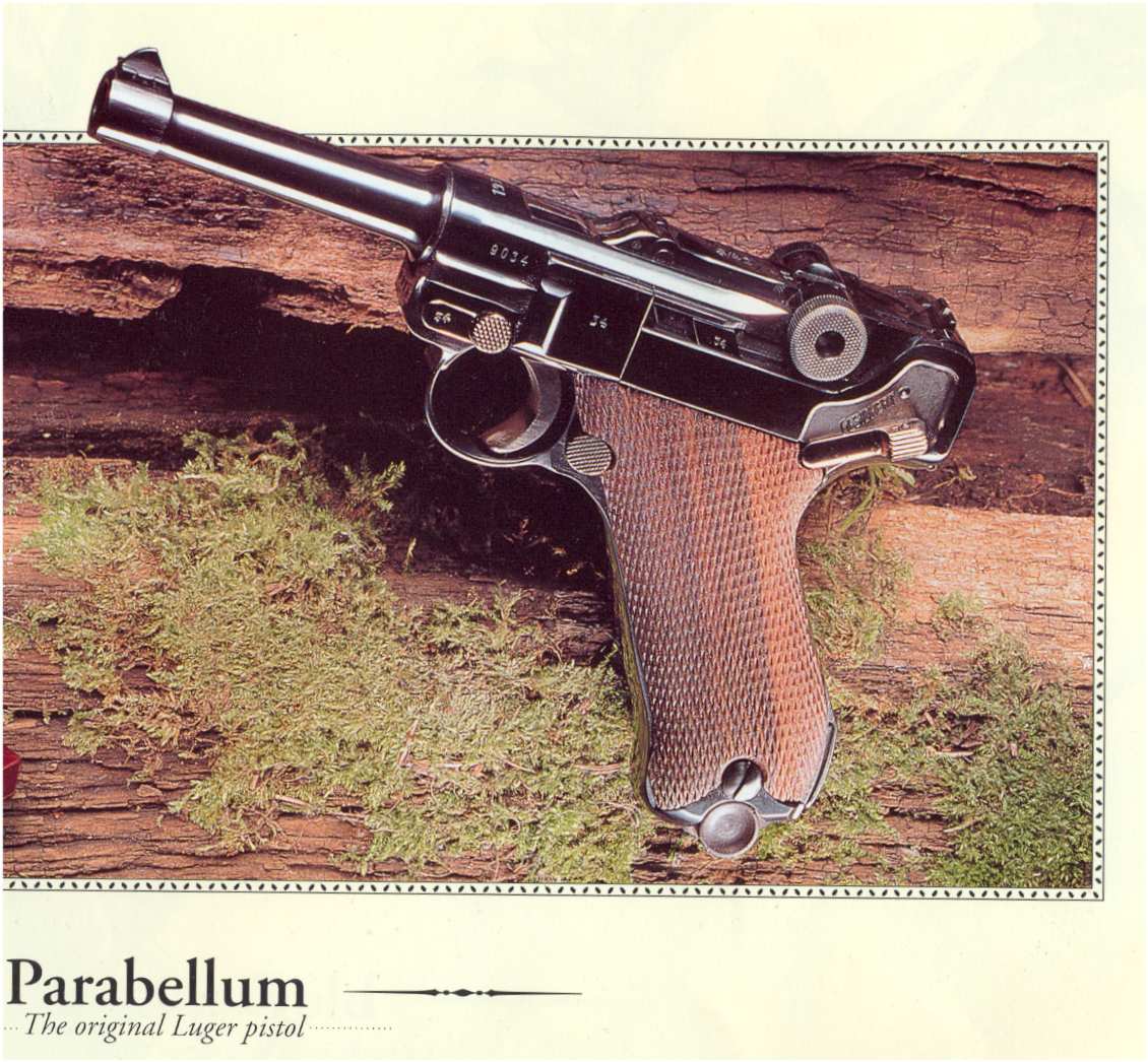

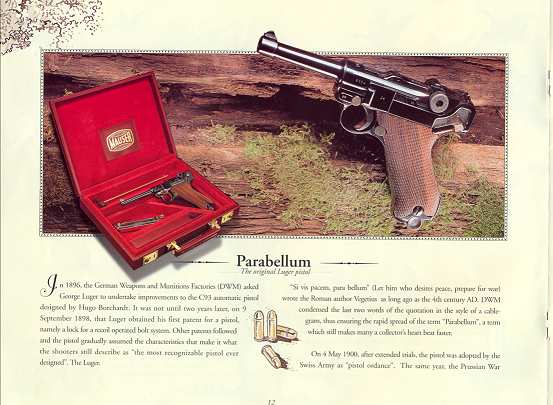

I want to make an additional remark here, it seems 'fantomark' is discussing a restoration done by Mauser themselves and yes, they exist.
Mauser themselves refurbished original Mauser pistols during the last years of the existance of their pistol producing branch in Oberdorf during the late 1990s (1997 - 1999).
These 'original' Mauser redo's are pretty rare and not to be confused with your average restoration offered by regular gunsmiths, etc...
These real Mauser restorations should be viewed in the same area as the post war Mauser Parabellums, perhaps a little bit higher.
Page from 1997 Mauser brochure:
Detailed view of the refurbished P08:

These guns restored by Mauser represent a last ditch attempt by Mauser to produce (or refurbish) a luger that was marketable. The fact that it was done by/for Mauser and only for a very short time makes it a collectible in it's own right and that will lift the price well above that of a normal reblue.
Tacky or not (no pun intended), it's part of the Mauser heritage.

G. van Vlimmeren is right: this is an S/42 dated 1939 restored by Mauser .
Finish is actually a "glossy Black" with Strawing as per the photo in the 1997 leaflet supplied by G. van Vlimmeren .
It comes with an original Mauser box as illustrated, but with no accessories.
