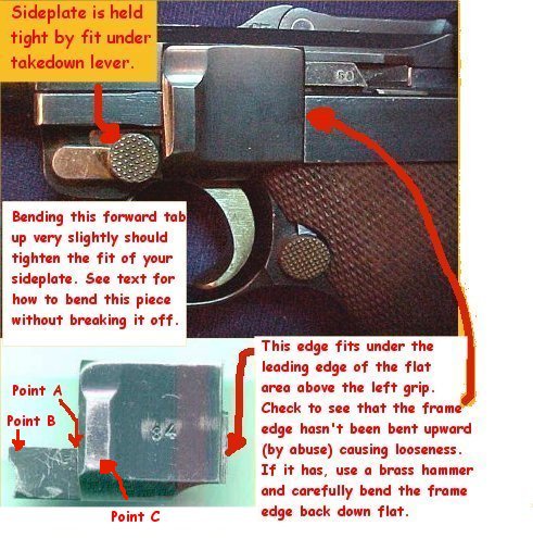

I uploaded some pix but do not know what happened to them. In all this looking at the gun I think I now know what is wrong. The sideplate is loose. When the trigger is pulled the plate moves outward just a bit and the piece on the inside of the sideplate does not hit the front of the sear bar. When I hold the sideplate tight it works. What can I do about this ?

Regarding the loose sideplate. this can be corrected by judicious and careful bending. it doesn't take much work to fix this, but you have to have confidence in yourself.
The bend of the tab should take place at Point A.
Place a small shim, a popcicle stick should do, under point B.
Then carefully and gently stike Point C (the raised portion of the sideplate) with a rubber mallet to ever so slightly until you have achieved a bend at Point A of about 1/32 of an inch or even less. Do this and then try the fit on the sideplate. keep doing it until you have a snug but not TIGHT fit.
This should cure your unreliable striker drop.
If you are careful you can do this, but at your own risk ... If you are not comfortable making these adjustments, take it to a gunsmith.
Good Luck! ... and let us know how you made out.

I brought the gun to my local shop & he did pretty much as you suggested.Seems to work fine. Only trouble is he says the gun is pretty worn out & that I could use a new spring to hold the take down latch. I don't shoot it much just a couple of time a year & then only about 50 rounds at a time. It is really accurate. Thanks again for the help. As for the photos when I try to upload a single picture it says maximum file size exceeded. What is with that ?
