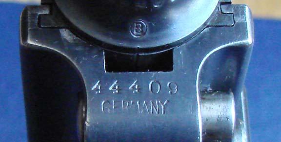

I saw this 1906 AE on A-A. I am not bidding on this one. But I am very curious on one mark.... Could you tell me what's the meaning of that circled B under the barrel ? Thanks!

For completeness, this ad will go away someday. I copy the photo here:

The circle-B under the barrel is a characteristic of 1906 Lugers found sporadically between sn44409 and sn46920. All those reported but one (a Swiss commercial) are American Eagles.
Between 1907 and 1911 DWM produced 5,000 1906 pistols for the Brazilian army. These pistols are marked with an encircled B on the left receiver and underneath the barrel. It is strongly speculated that the markings on the barrel are inspection marks, and DWM used extra Brazilian-inspected barrels to assemble some of their commercial guns.
Threre is precedent for this with two serial ranges of model 1900 guns using Swiss marked barrels.

I am hoping, one day, we will come across a commercial Luger with a Portuguese marked barrel (encircled triangle) as well.
That would be neat.

This gun is a good study. Owner says original finish, but I wonder about the following :
1. Depth of the lower part of the AE at the tail feathers and one of the talons may indicate some loss of metal during re-do.
2. "Germany" seems to have loss some depth of the stamping along its bottom half and then there is no "halo" around the stamping.
3. Deep dent on the back grip strap may (cannot tell with the photo glare) have blue in the dent.
4. What is curious is that the circle/B stamp on the barrel shows "halo".
So...maybe some touch-ups to parts of the gun...???...
BTW...front sight blade is not DWM-original...some 1920-50's after-market one.

Concerning your comment about the deep dent having blue in it. It is my understanding that dents and stamps that were applied after blueing can and do have blue (in) them, even when they show a halo. Of course pits, gouges and scratches aren't supposed to have blue in them. Am I wrong about this?

Pits normally have rust and crud in them.
A dent should have a little "white" showing where metal to metal struck and some metal displacement...but you are right...the blue would still be in the dent as well.
Some dents are really scratches or gouges...which would have more white than blue in the upset area...
