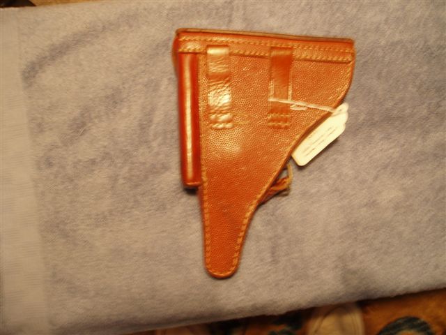

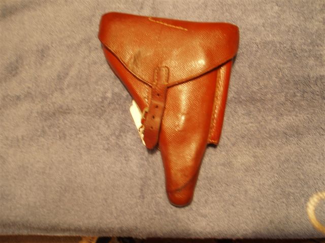

I just picked up this holster and would like any ideas Forum members could offer about it. It is totally UNMARKED. It has thread holes on the front where it appears a former strap has been removed, perhaps similar to an artillery closing strap. Leather is in beautiful condition. Buckle part of the closing strap is also unusual, as it is not sewed on tightly to the body but has about 1" of loose leather. Leather is an unusual pebble grain. If anyone has "Luger: The International Pistol" book, the leather is almost exactly the same as on page 95 of the book. The holster came with a 4 digit ns serialed 1st Issue millitary, also in very nice condition. I have not seen an early Luger holster with this type of leather before. Is it an early holster ....or what? Any ideas/comments?

Herman, Your holster certainly does appear to have been reworked from a pull down closure strap (presumably with a stud on flap) to a later PO8 style strap & buckle system. I wonder if the new closure strap is sewn over the previous hole for the stud, or whether the whole top has been replaced? If so, that is where the previous issue/maker marks were placed. I see stitching holes where a cleaning rod pouch was previously installed, so that would rule out conversion from a Navy or LPO8 holster, so probably just a later conversion of a non-standard WW1 PO8 holster. TH

Tom: I have relooked this holster again. I don't see the stitching holes for the cleaning rod you mentioned. Also, there is no evidence of a closing stud ever having been on the flap, no evidence outside or on inside. Stitching on the closing strap and buckle strap is orginal and very nicely done. That leaves the question of the stitching holes on the front body. I can't help but think this holster was made/converted from something else and the holes on the body front are left over from whatever it was made from. I don't think that once this holster was put together it was ever modified again. I think the stitching holes were there when this holster was put into its current configuration. Here are a couple other points: the corners of the flap are SEWN with four stitches, not totally moulded like most holsters, and the mag pouch is not pebble grained like the rest of the holster, but has more of the courduroy texture and appearance we saw on another recent posting on the Forum. I really like this holster, I just am not sure what it is. Thanks for your input.

It is my opinion that this is a commercial aftermarket or reproduction holster. The belt loops are installed to make the holster hang straight and they are normally installed at a slight angle... It looks too new inside to me for a holster as old at the gun... Just my $0.02
