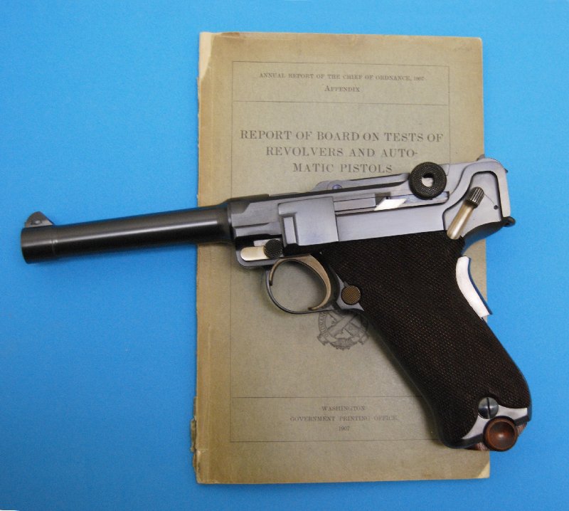

Default 1907 Test
The booklet is an original copy of the 1907 test trials report...a little worse for wear but complete and original. The Luger is a Krause replica of the .45 Luger so not original (but a good fake!)

Do you know if such instructive booklets were printed for the 1000 test lugers?
Unread 12-14-2007, 12:19 PM   #14
This is not an instructional manual. It is a report of the results of testing the Luger, Colt, Savage, etc. in 1907.
You had asked about manuals for the 1000 Test Lugers a few months ago, and my response at that time was that I doubted that there was a specific manual published for those Lugers. If there were any manuals provided at all they most likely would have been the standard DWM commercial booklets available during that period.
