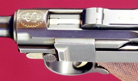

Here is the M2 on my gun :

1. The refinisher (who did a nice job) seemed to have a chance to do a nice blue on the chamber and seemed to have work 'around' it altogether...I cannot, for the life of me, try to figure out why he/she would have skipped a reblue of the chamber...on your M2 pistol.
2. Wooden magazine has that tell-tale "ridge" of wood running through the bottom that is usually a Swiss '24 Bern magazine attribute...but someone seems to have tried to add "Navy" concentric rings (poorly though...).
BTW...here is a photo of a Luger that has been "freshened-up" along its bluing, but the area around the chamber engraving was left alone...as not to impart damage to the gold inlay...
On your gun, I am not sure what the refinisher was trying to retain...buy not doing the chamber...

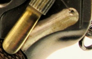

Is the somewhat irregular shape of the polished area at the thumb safety worrisome to you...especially along the upper edge ?
Unread 11-24-2007, 10:47 PM   #11
Yep...a little. But it doesn't look like a run-out made by a tool, too irregular. The polish is nice and uniform with evidence of a constant feed on the cutter. If it had been hand polished or the cutter wavered, you would expect a broader arc on the run-out. A bit worrisome but the rest of the polished area looks pretty good and has a nice patina. Have to give it at least a half thumbs up.

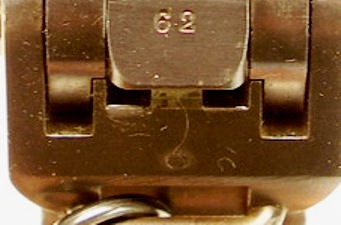

I have played around with a couple of your photos and cannot see the halo in enough detail...
Here is one of your photos, zoomed in...I keep thinking I see a Swiss cross proof on the back of your Luger...which is certainly not the case...just the limit of zooming in on the photos you have posted so far...
