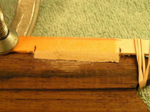

In the back of both Luger grips there are supposed to be milled surfaces that will hold the grip in position relative to the frame. The right grip had this entire milled internal surface missing from the rear edge, and this explained why the grip was always slipping and sliding around regardless of how tight I tried to tighten the right grip screw.
To solve this problem of the missing milled surface, I used a popsicle to make a form, and held it in place with a "C" clamp on one end and rubber band on the other end. I put a piece of leather underneath the "C" clamp on the side with the checkering, to prevent damage to the checkering. Then I put ink pen marks on the surface of the popsicle stick to indicate the where the ends of the reconstructed milled surface were to begin and end. Next I used DAP brand Plastic Wood and a small putty knife to build a ridge to replace the missing milled surface. All of this has to be done with attention to accuracy, since once the Plastic Wood ridge dries, it must fit inside the frame perfectly. Below is a picture of the complete setup, with the Plastic Wood in place, neatly held in place by the popsicle stick. Be careful when you pry or break the popsicle stick away from the dried Plastic Wood.

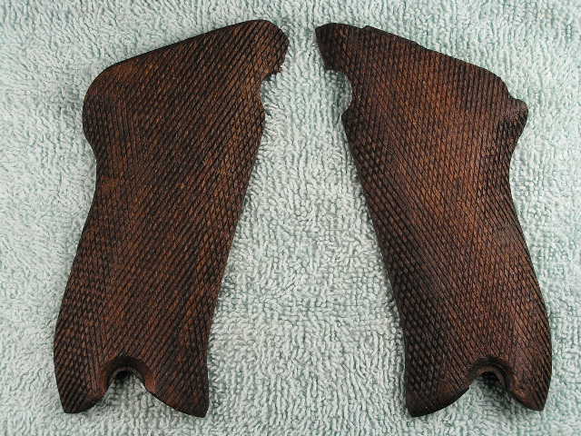

Here is a picture of what the grips look like now. If I had known they were going to look this good, I would have taken a "before" picture too. Special thanks to Mr. Pete Ebbink who suggested I use Watco brand Danish Oil applied with a toothbrush to the bare wood. I am pleased with the results.
Mauser720 - Ron
