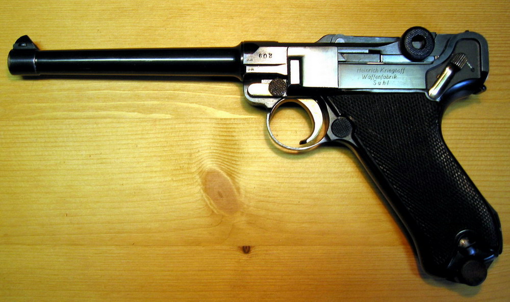

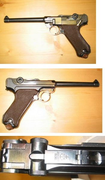

Seems to be a nice P code commercial Krieghoff

This gun is in europe.
It is to share pictures of an unusual Krieghoff, and to determine type and value.
I will try to have more accurate pictures in a few days.
Thank you for your help

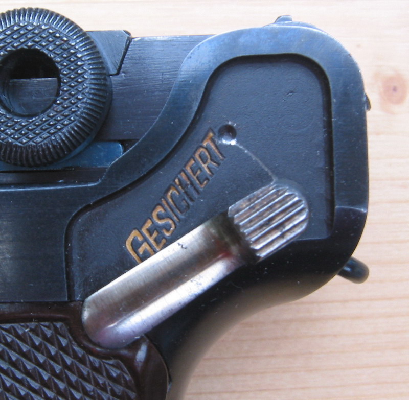

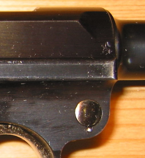

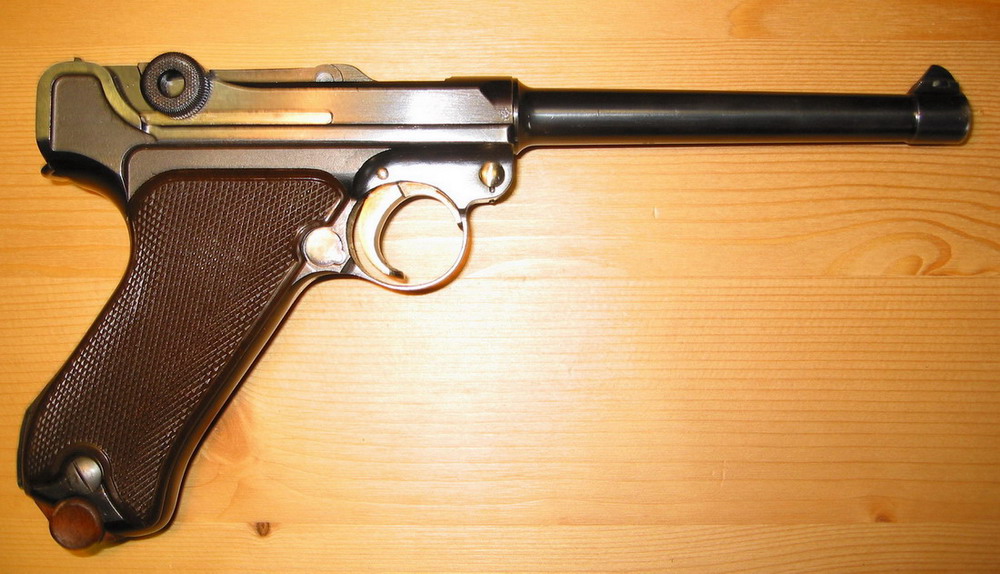

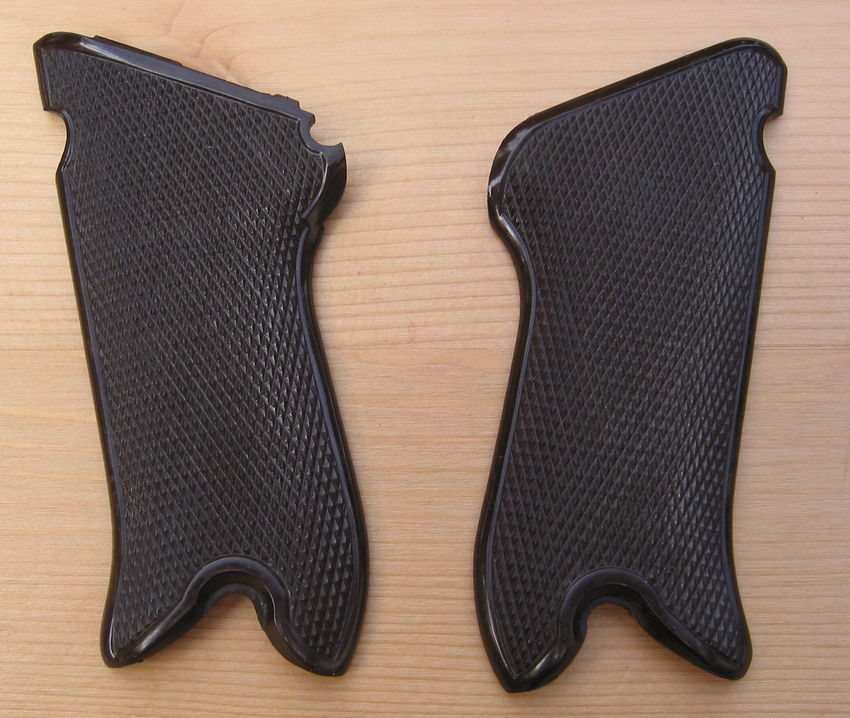

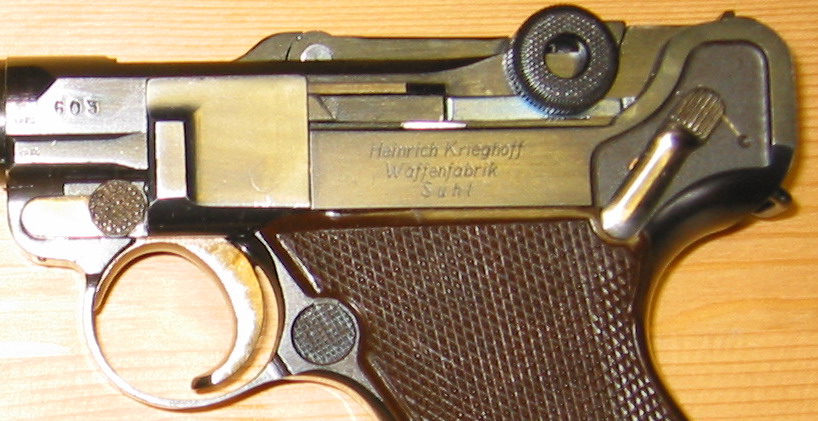

New pictures of this Krieghoff P series
caliber 7.65 mm
barrel 150 mm
brown plastic grips

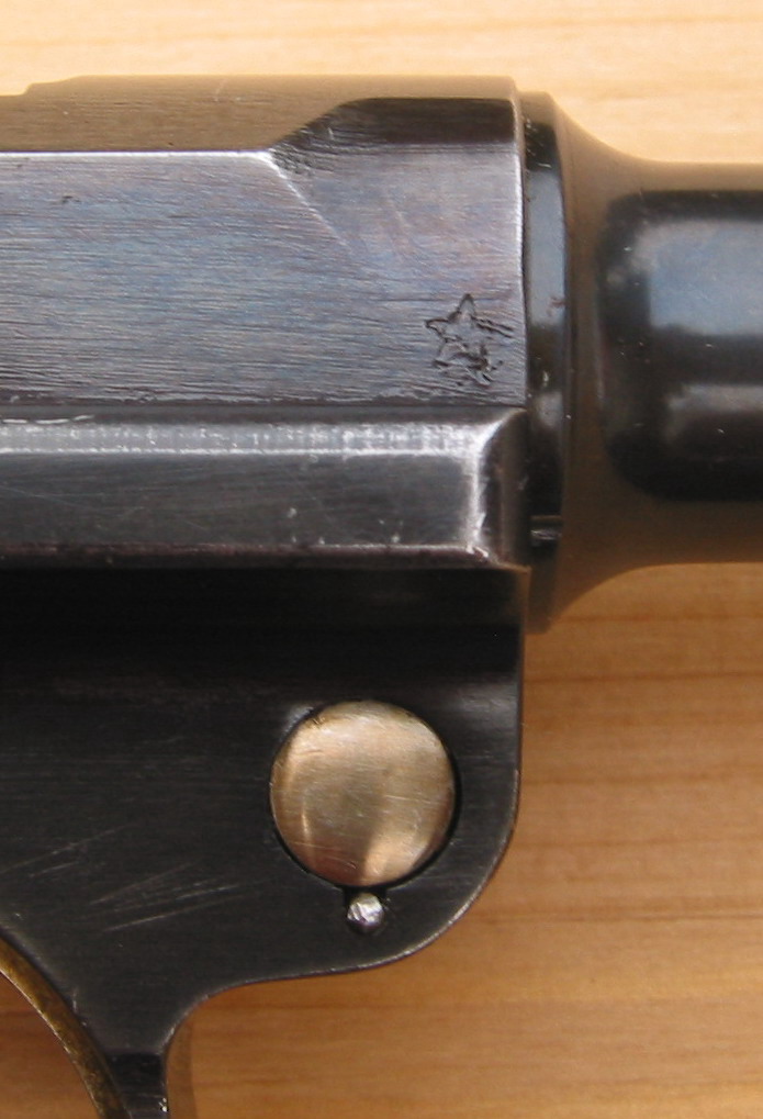

five pointed star rejection marking
Looking for this Krieghoff in the Randall Gibson book (second edition, page 196), I thing it is a P code series I, the same one than 10e.licorne lower in this forum.
Can somebody help me to determine if it is right and the value
Many thanks and sorry for my bad english

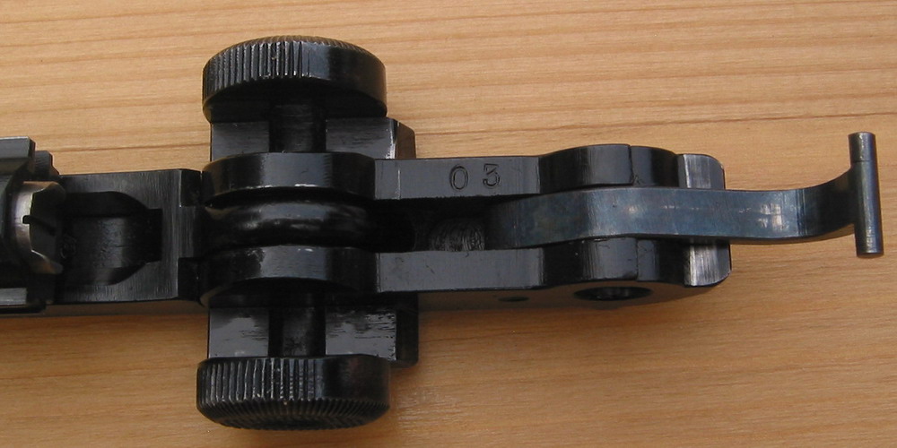

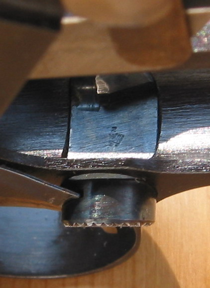

Hi JM,
Your English is very good! But the pictures are better!!
In short - from the photographs above - while I *might* have a few issues left unanswered - the HK above looks like it is probably correct. These issues are:

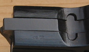

Take-down lever - your picture is only fair. I am looking for the correct polishing marks, which I can not see in your pictures;
Internal pictures. These are not present, so I do not know if the internals are correct as marked;
Polishing on toggle links. Appears correct from the pictures? TL Stamp looks correct as well - but again - only first hand inspection woud tell..?
OK - so *if* it is verified - what would it be worth?
In that barrel length in the represented condition - it would sell for approximately $15,000 - $20,000 US.
However - that is if it is all "correct" in straw/blue - and the internals are correctly stamped for an Early "P Code". Only a personal inspection by a noted collector could determine those, however (there are some pretty great fakes of "P-Code" Krieghoffs I've seen..!!)
From these few pictures - I'm more inclined to say yours is not a fake - but again, I can't say it isn't until your HK is verified by a collector who knows Krieghoffs and also knows what to look for.. Since you are in France - and I am in the USA - that person probably would not be me!!
John D.

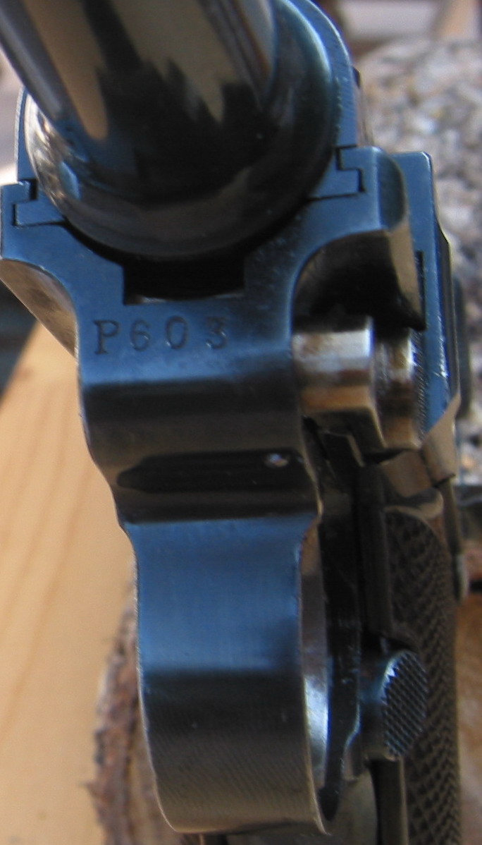

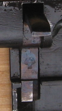

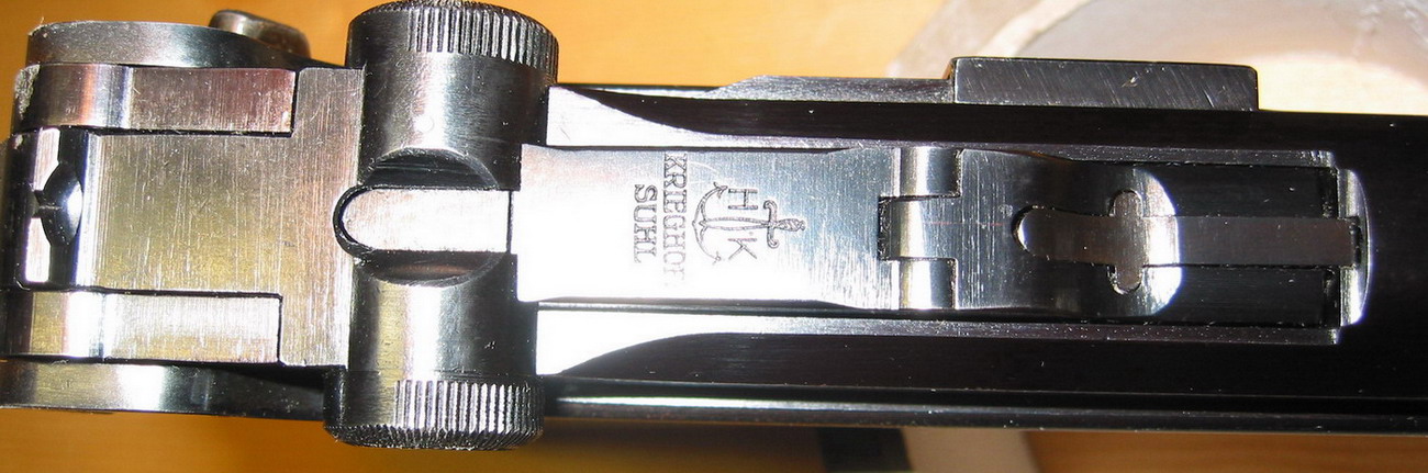

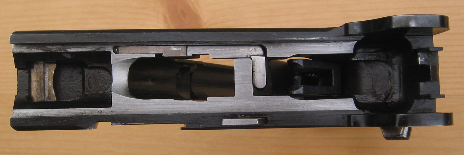

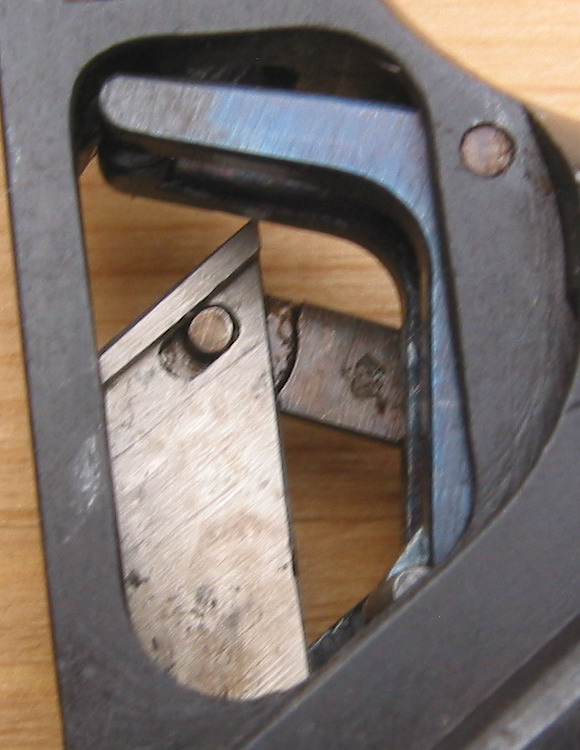

Hello John
Many thanks for your answer

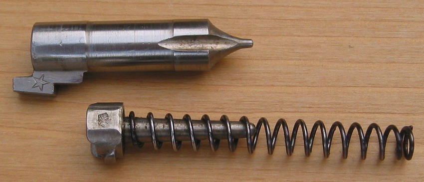

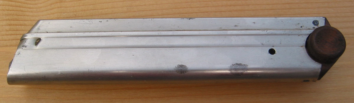

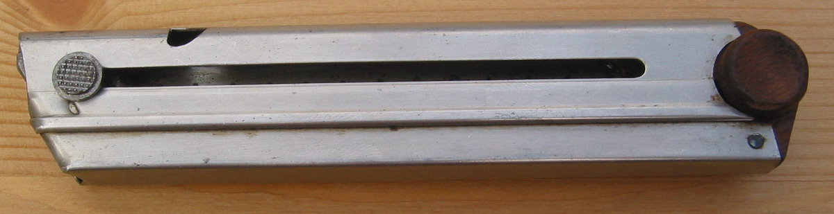

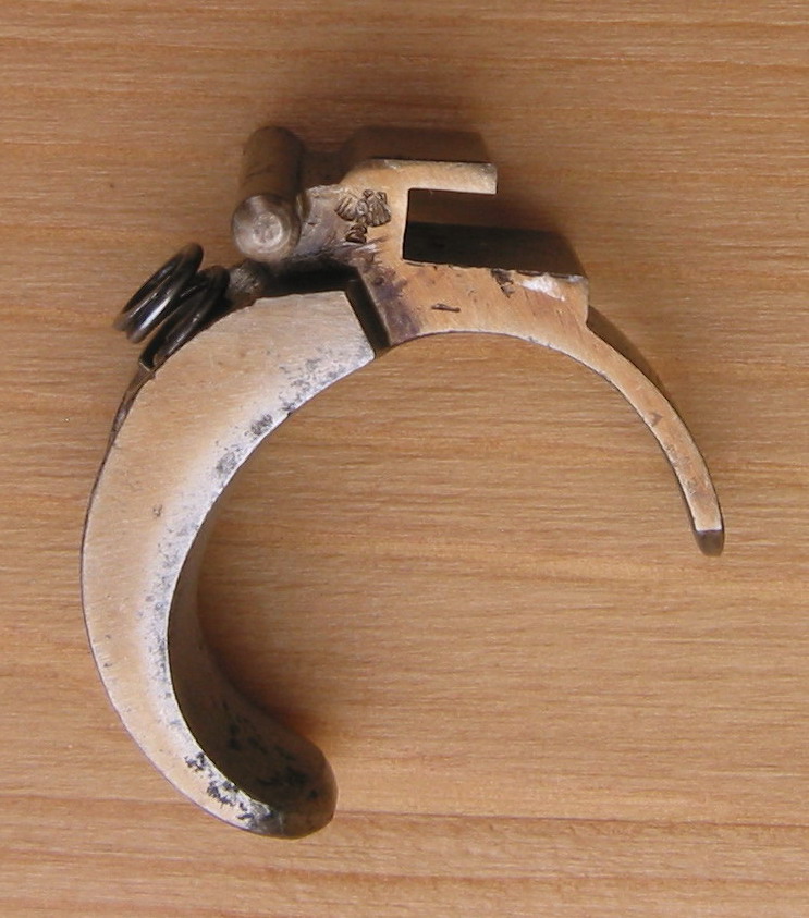

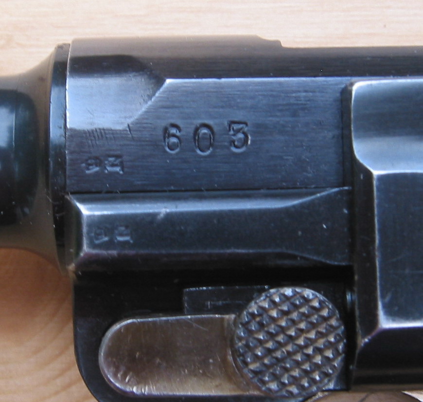

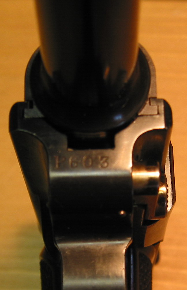

On the following messages, you will find detailed pictures.

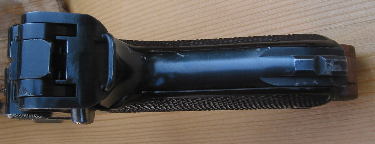

The magazine number doesn't match
Is there any other hidden marking ?
Thank you for your opinion
Best regards
Jean

Merci, Jean!
Les images montrent exactement l'endroit que je veux voir. Votre Krieghoff regarde etre correct, de ce que les images montrent. Merci pour poster les images! Par ce que je vois - c'est magnifique!
Je dirai encore - je crois, vraiment - que 15,000 - 20,000 US est un correct prix sur votre HK. Il n'est pas un problem avec le magazine - c'est typique avec the "P Code". Il y a becooup les types qui arrivee avec the HK "commercials" - et, cette type, c'est "daccord" (Je ne sais pas le mot en francais) pour en la. Aussi - c'est un variation premiere en la "P" code.
Je souhaite que je pourrais regarder votre luger....
Merci une autre temps, Jean. C'est tres bon...
John
