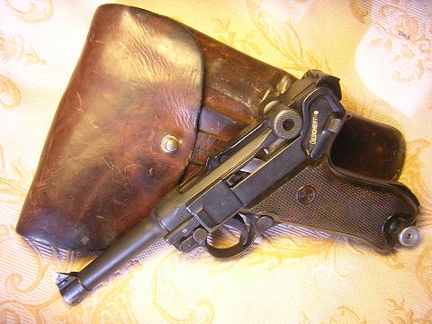

Default Finally got pictures!
I'd like to know a little about the history as well as the value. It doesn't look to be in quite as good of shape as I originally thought.

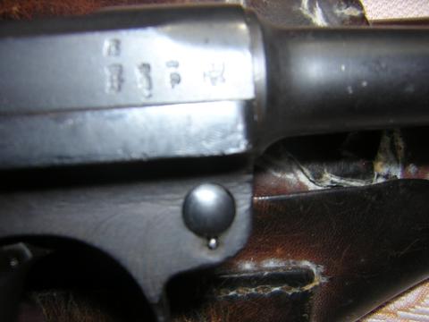

There is an eagle stamp on the barrel that is identical to the one on the right side of the chamber.

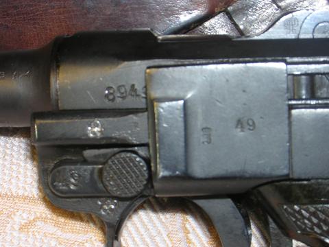

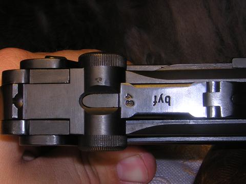

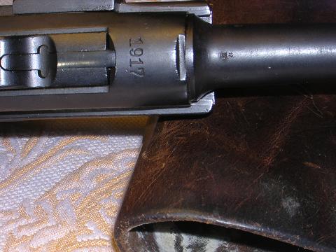

smith, these have the "typical" east german grips, plus it is obviously a mismatch. The reason I say that is that although the toggle number is the same, byf equals the code for Mauser, and they did not exist in 1917, plus the other markings / proofs on the gun / right of the receiver are Erfurt, which ceased to exist in 1918.
Value would be around $500-$600, the holster another $50-$125, although it depends on who made it an when. I don't believe it is a luger holster, possibly a p38 (might be post war, and value would go down if it is).

That can't be! This was Hitler's personal Luger.
So at some point someone replaced the toggle with that of a mauser that had matching serial numbers? Would it be worth my time to track down a matching toggle? Any idea who would have used it originally? There are no ownership markings as far as I can tell.

I think that Hitler had a Rohm 22 ;>)
This was mostly likely a east german import, so after WW2 it then served the DDR, they "matched" it. I would keep it as is, because its history continued after WW2 and served in the communist gov't.

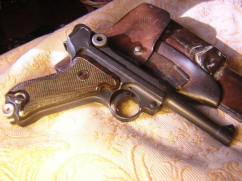

In your pictures, your luger is not assembled properly. Looks like the toggle link is not matched to the toggle spring.

Yeah, I took it apart and have been having an awful time trying to get it put back together. There must be a trick to it.

Ben,
VOPO Lugers are gaining in collectability in their own catagory. Some collectors specialize in communist block weapons. I would leave it as is. The toggle was probably renumbered by the Russians before it was issued to the East Germans. The plastic "Bulls Eye" grips are EG issue.

I got her reassembled the other night thanks to everyone's help. That video really helped. I wasn't inserting the magazine so the toggle wouldn't lock back. Thanks.
