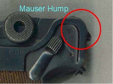

If the rear of the frame doesn't have a Mauser "Hump", it's from a 1936.
If the rear part of the left side, just in front of the safety lever is marked P.08, then it's from a 1942.
If it isn't from 1936 or 1942, then it's either from a 1938 or 1940!!

The absence of the Mauser "hump" only tells us that it is -not- a post-1936 Mauser frame. No information so far prohibits the frame from being DWM or Erfurt--which is why pictures are useful.
The serial number information is found in Jan Still's Third Reich Lugers.

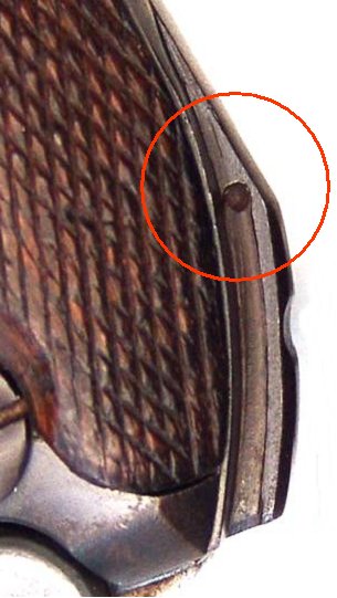

Hey guys, don't forget the Mauser "hole" found on the groove of the stocklug near the top. It's pretty consistent except for "K" date frames.
Hmmm, maybe this is a 1936 Mauser frame then. Thanks Dr! With the stocks removed, on the left side of the frame I see a hole there. Right above the magazine release where the stock lug fits in the groove.

Quentin, Doc is right about the hole in the stock lug. Your pictures show me that it is probably a DWM Frame, not a Mauser! If so it could be a 1915,16, 17, 18.

Guess I don't understand exactly where you guys are talking about. Would that be visible on the right side or left?
"Mauser "hole" found on the groove of the stocklug near the top..."
Of course if it was there it would help!

This is the "hole" at the top of the stock lug groove that is definitively Mauser.
This is the Mauser hump.

Anyway, my pictures don't show the stock lug as clearly as your picture so I just took my jeweler's Afga Lupe and there is no hole drilled at the top of the stock lug on either side. In your picture it sure looks like there's a hole drilled at the top of the lug.
So the frame is a WWII DWM! Thanks so much for that info. Didn't expect that.
