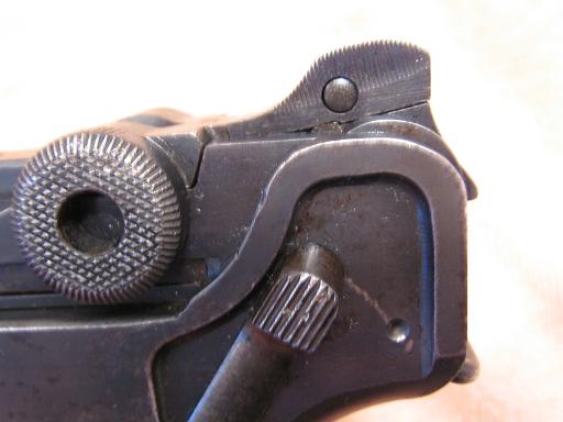

Default Two Date Navy
I have a 1914 two date navy 1920 over 1917 the gun is marked in the military manner (For a navy).IThe serial # is (4895a) it is stamped Germany,everything about the gun is in military fasihon except the stamp Germany.Any insight would be most helpful,Thanks

Tim,
in my humble opinion, it is still a navy. The 'GERMANY' stamp just means that it was imported into the USA and does not deminish it value. The double stamp just means that the Wiemar government inspected the gun after the war. There is an implication that certain parts may have been replaced for various reasons. However, if all the numbers match, then probably nothing was done to the gun that would affect its value. According to the WW1 treaty, the barrel should have been shortened to, I think, less that 4 inches. Given the condition of the rest of the gun, if the bore is too minty or the barrels finish is too good, then the barrel has been replaced. That would affect the price. If the barrel finish, the serial numbers on the bottom of the barrel and the bore look appropriate, then you might have an exception to the treaty. With that said, the value of anything is only what someone else is willing to pay for that item.
Big Norm
Unread 04-01-2007, 08:55 PM   #9
Tim,
I would venture a guess that yours is probably a $ 3000 Navy luger.

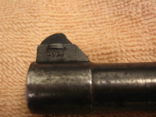

Looks like the barrel still has the little "1917" date on the left side of the front sight base...so probably original to the gun.
It was property stamped with "1920" at the beginning of the Weimar period but no other visible ToV modifications.
"Germany" for some collectors may beat down price/value a tad...other Navy folks do not seem to care much.

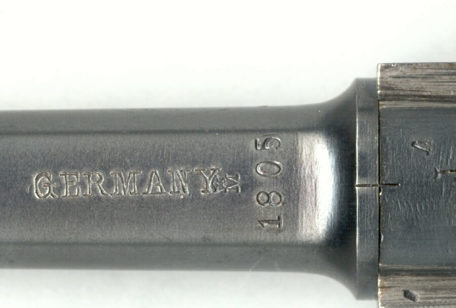

My 1917 Navy also has the "GERMANY" stamp, but in a different location. It is underneath the barrel. Also note that a different die was used for my marking.
Was there no consistency in the location of the "GERMANY" export markings?
See picture below. Also, my gun does not have the 1920 date stamp over the chamber.
The apparent flat area on the bottom of the barrel is not real; it is an artifact of the image process when created by a flatbed scanner rather than a digital camera.

Luke, my 1917 Navy is export marked exactly the same as yours!

drbuster -
Thank you for the comment. I have wondered ever since I bought this Navy.
I bought it from FGS (Doug Smith) only after I spent an hour on the phone with Doug discussing the gun. He told me that he had knowledge of this Luger in that he had sold it to a collector many years ago, and that collector had recently traded it back on a 1908 Navy. I am about as certain of this Navy as any I have seen, but always wondered about the "GERMANY" marking on the barrel.
Big Norm -
Your observations about British proof marks and the "GERMANY" export mark and their relation to price help to confirm my belief when I bought this Navy. The gun was so good, otherwise, that I was pretty confident that the export mark would not have much effect on its value in the long run.

Tim,
after looking at the picture of the front sight, I would assume that the condition of the gun is rather pitted. It isn't uncommon to see the front of the barrel pitted, but yours looks like the pitting might go beyond the front of the barrel. While I would agree with Pete that the gun would go for "about" $3000, all would depend on who is buying the gun. There are a lot of prime navy Lugers w/matching mags out there and yours isn't prime. Still, check all the serial marked parts to make sure that all numbers match. Also check the bore to see what its condition is. A bad bore can affect the price too. It is a crazy market out there and anything is possible right now.
