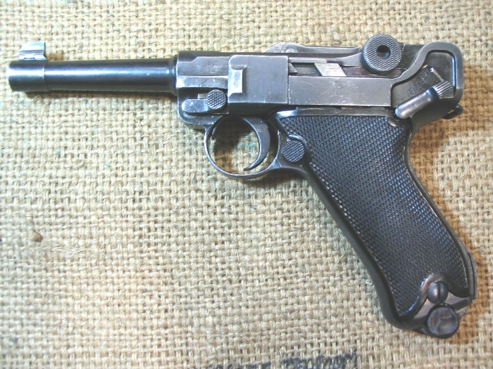

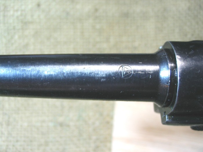

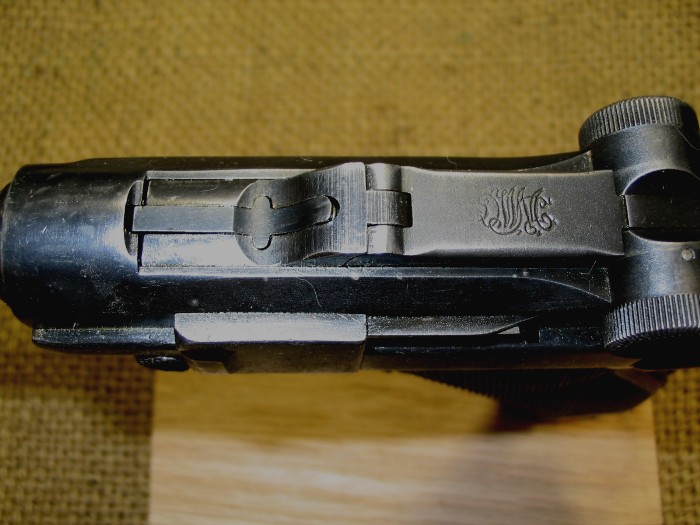

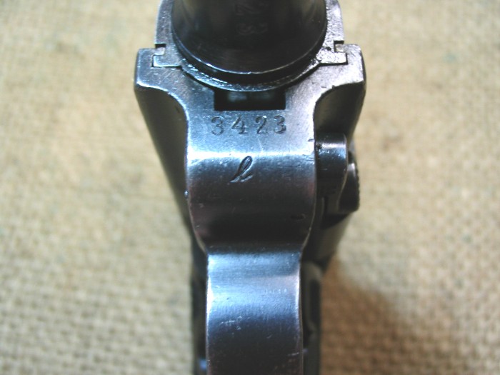

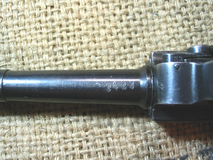

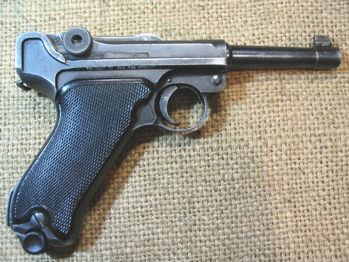

Unread 04-02-2007, 12:14 PM   #12

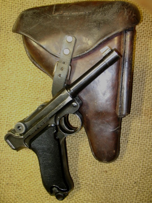

I just received this Finnish Contract Luger. My understanding from answers to previous questions, is that the 4" Tikka barreled Finns are difficult to come by. As most of you know my collecting interests are focused on Weimar Era military Lugers. So I thought it proper to pursue an example of this interesting variation to add to the pile.
A 1920 DWM Alphabet commercial in fairly decent condition.
Side plate is numbered in commercial fashion with #10 Trigger is #45, Takedown lever matching #23
I would like to eventually find an original set of issue grips with ID disk. My understanding is that the black plastic grips were a post 1940 standard
Unread 04-02-2007, 12:16 PM   #13
The holster was aquired about 3 years ago with another pistol. Riveted and with back panel,pull-up and hold down straps replaced with odd blue-gray leather.
Unread 04-02-2007, 01:15 PM   #14

Unread 04-03-2007, 06:35 PM   #15
pillboxesghost
Join Date: Feb 2006
Location: Coastal NC
Posts: 22
Default Finnish Blue Grey (or Green??) Color
I believe I am correct that the green leather (blue gray material) was used for the Finnish infantry holsters. At least that is the hue of the "as new" M-39 Finn rifle slings that are currently being sold.
I am led to believe that the brown holsters were issued to border guards.
Just acquired a brown Lathi/Luger holster (120 mm bbl.) thru Juha Hokkanen that had a replacement "green/blue grey" lifting strap installed.
I believe "AVA" (or "AVG" ?? don't have the holster in front of me) is a rather common manufacturers marking that appears on these holsters.
Evidently repairs were made with what ever color material was on hand.
Perhaps one of the Finnish nationals on the board can set us straight.

Unread 04-04-2007, 07:43 PM   #16
Alsky
Location: Pa
Posts: 30
Jon the marking on your holster is AV3. It represents Arms Depot #3 and was located in Kupio.
