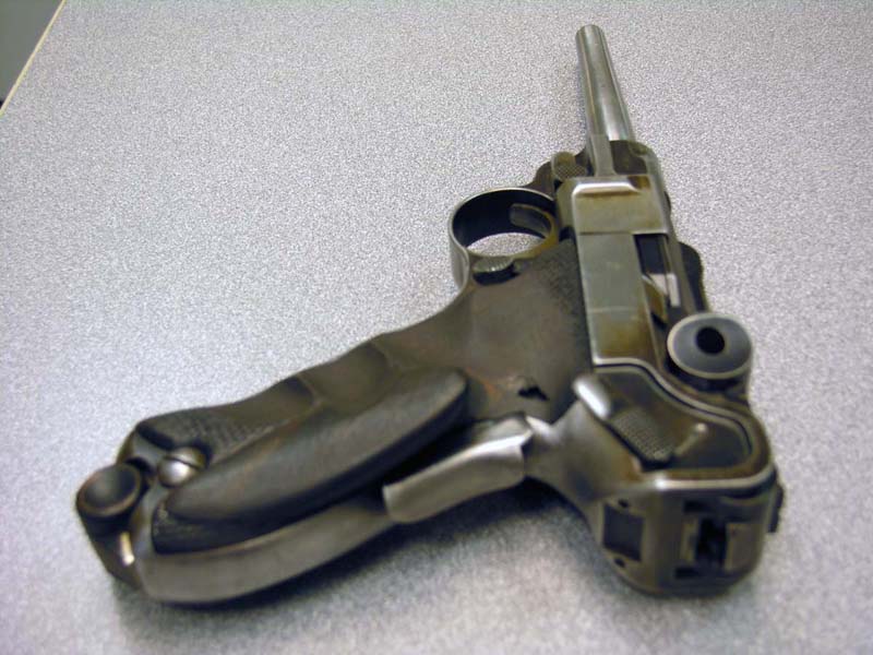

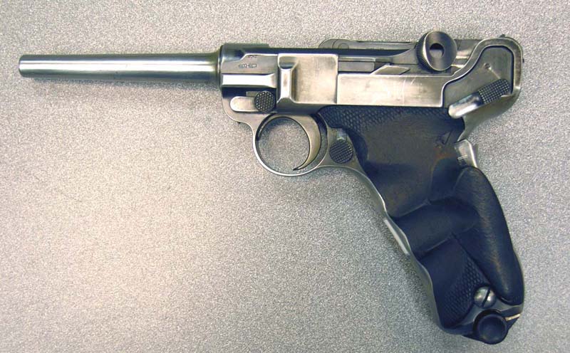

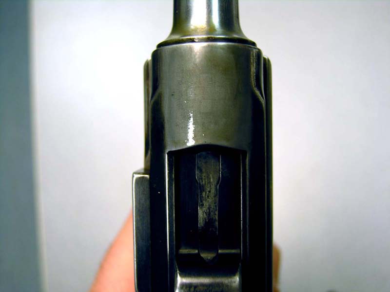

I believe what I have here is a military contract Swiss model of 1900. It is in our reference collection (I am a firearms examiner). The top of the chamber was polished down and when I hit it with a bit of acid to restore it I found the Swiss cross and "sunburst" pattern (see pictures). The grips have been turned into some sort of "target" style and for some unknown reason the front of the barrel has been turned down and the front sight removed. Very sad. Just thought some of you would like to see the torture first hand.

Hi Jared,
Thanks for posting...too bad about the modifications.
Odd that a shooter wanting "target" grips would not have a front sight with which to acquire an accurate shooting target view.
This gun has potential for restoration if anyone wants to dump some money into it.
BTW...this gun would be considered a DWM-Swiss M1900 Commercial has it has the commercial BUG proofs and not the Military Ordnance proofs.

Jared,
Very sad, but thanks very much for letting us see the pictures. Fyi this gun is actually a Swiss Commercial, determined by the crown/B, crown/U proof marks on the left receiver. I would expect to see a c/B, c/U, and c/G on the underside of the barrel.

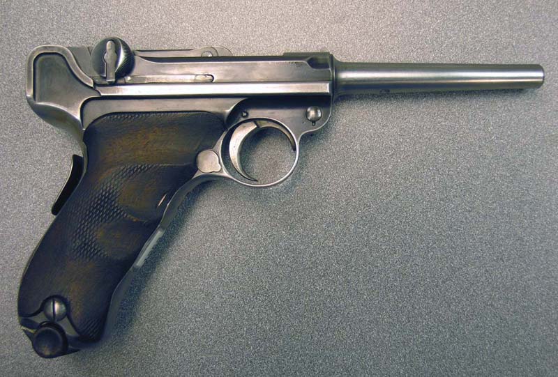

For my data-gathering on these guns, could you please tell me if the grip safety is narrow (half the width of the grip strap) or wide (full-width)? Thanks again.

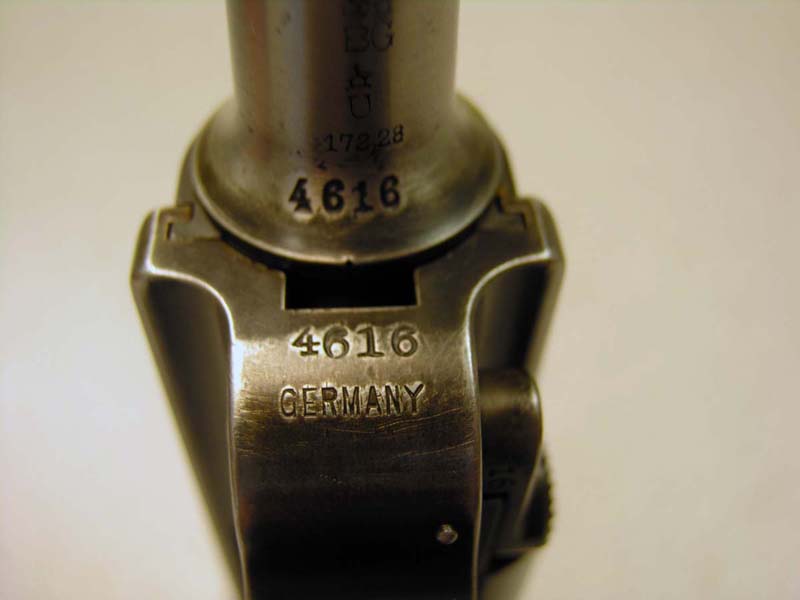

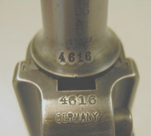

My mistake, the literature I was getting my information from (2004 standard catalog of firearms) stated that the military serial number range was 2001-5000. The grip safety is of the narrow type. And yes the BUG proofs are present on the bottom of the barrel. The bottom of the barrel also has the number "172,28" What is this number?
jford is offline   Reply With Quote
Unread 04-12-2007, 02:31 PM   #9
The 172,28 is the old standard for measuring gauge. So this would be the number of lead balls of the diameter of the bore (in this case 7.65mm) required to make a pound. The comma between 172 and 28 is of course the European equivalent of a decimal point.

BUG's on the barrel are there...just a bit hard to see in the photo's lighting :

Default Backstrap and grip safety
