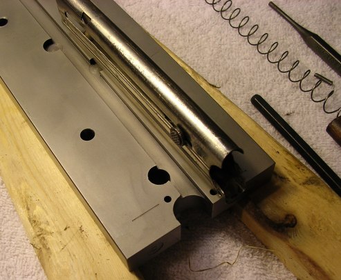

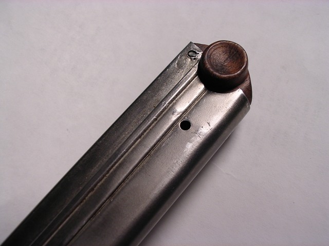

The following series is of the GT magazine tool in action.

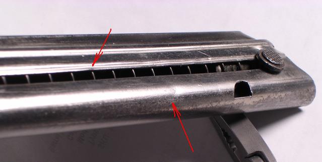

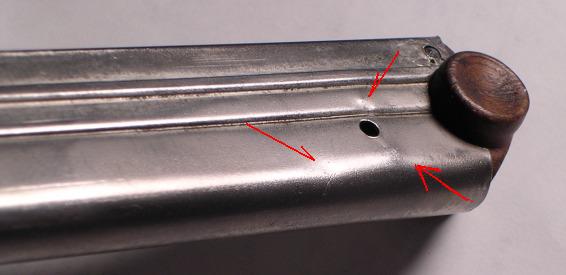

THe mag before work

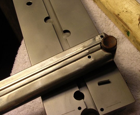

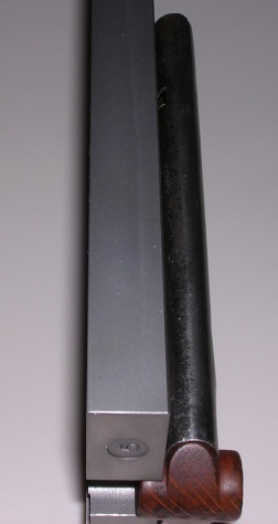

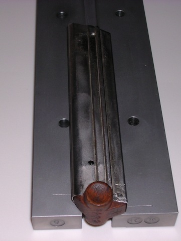

First Step is to align the mag on the tool base
and drop the mag down into position to remove the base pin
side view of initial set up
more on the next email

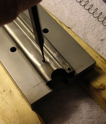

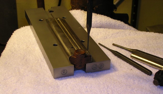

These pictures do not show that I used a drill press as a pin press. Chuck the drift pin in the drill press with the motor of and you can use the drill wheel to precisely lower the pin. Saves hammering.
Step one done

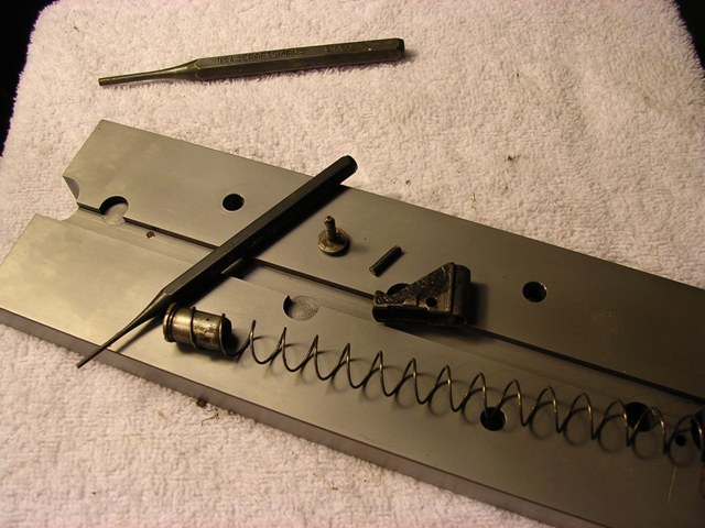

Step two is to remove the magazine follower pin. With the base plug out you remove the spring and move the follower down to line up with the removal hole in the magazine sleve, whiich also aligns with a hole in the GT base plate fixture.
Press the pin out
Step two done and the mag is gutted

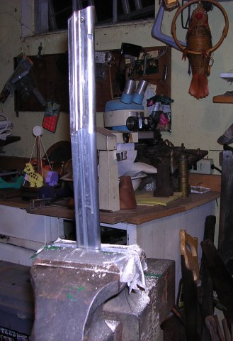

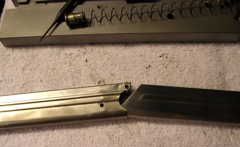

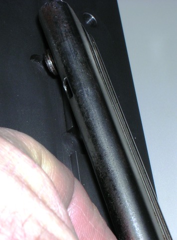

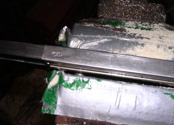

Step 3 is swaging out the dents in the tube.
Insert the swage

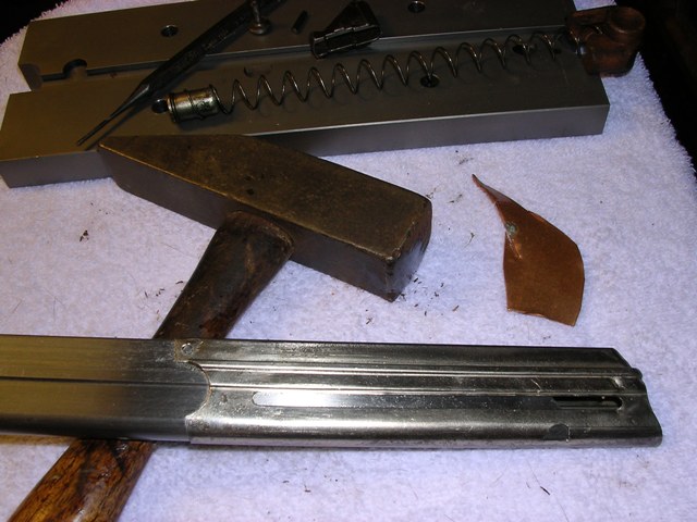

Mount the mag on the swage and clamp the swage in the vise. The hammer work here is a little tricky. Mostly you put on a leather glove and slide the mag back and forth forcing it down on the swage. The parrot is one of Hugh's spies.
The hammer is used to smooth down the raised dents. I use the copper to protect the mag from hammer blows. The swage is up to the hold open slot in this photo. This is a slow careful process.

Refreshed Mag works very well and looks much better, The before pictures do not show how rough it really was.
Now that you have seen the process, do not quibble over the price. And, my GT swage and base is not for sale.
