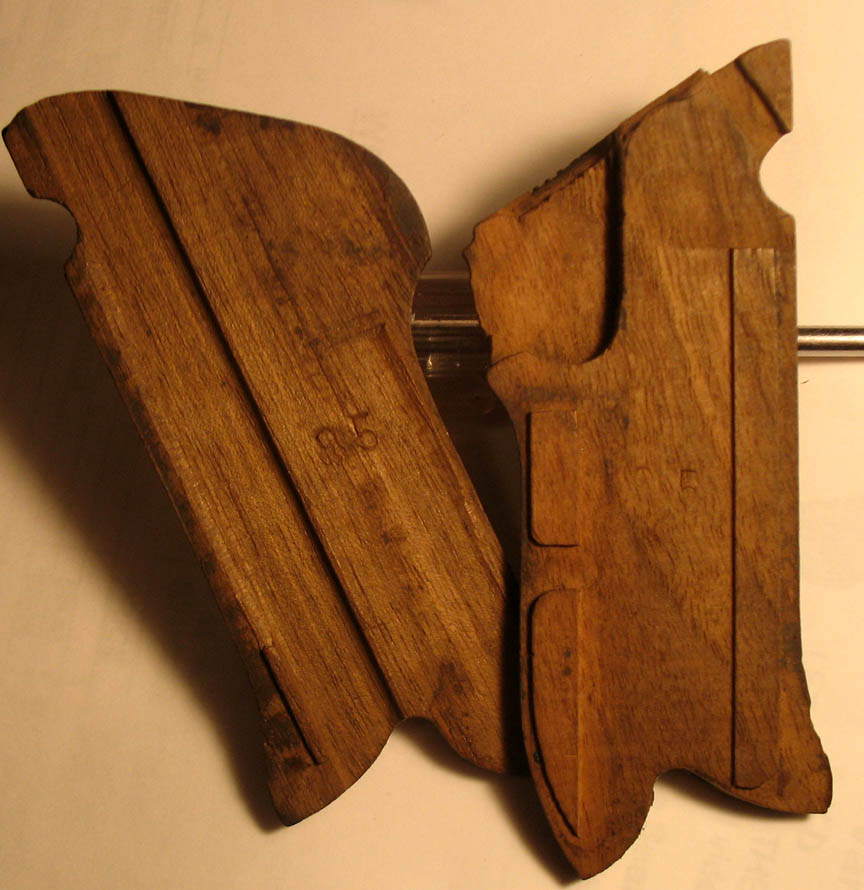

I have a pair of grips that are stamped with the last two numbers and the E/135.
I tried to get a better pic but my "user friendly" camera SUCKS!
Anyway here are the pics.
Bob

Unread 01-31-2007, 12:29 AM   #13

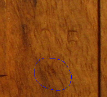

Default another
The one on the left has the E/135 stamped over the "9"
The one on the right is just to the lower left

Bob, thanks for the pics!! Just is proof that both serial numbers and Waffenamt Marks do exist!! BTW, nasty chip on the left grip! Too bad!

Ya, I do have the piece that broke off. I just need some time to carefully glue it back on.
Bob
