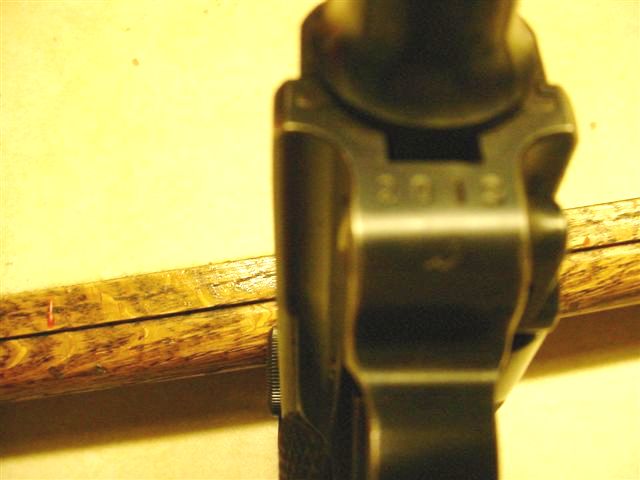

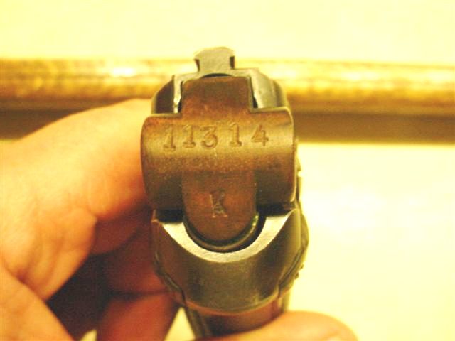

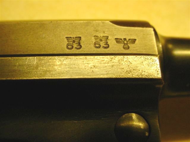

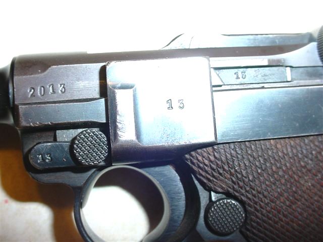

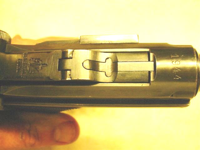

Gun No. 1 photos appear to show a rare 1944-dated HK luger (serial number not listed in the R. Gibson book about HK lugers) :

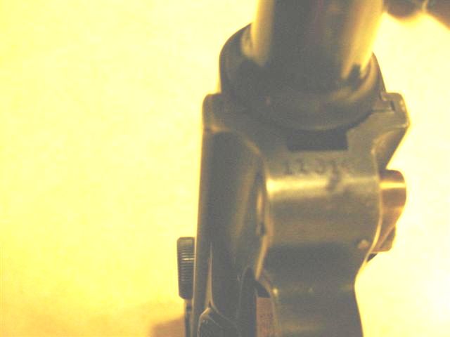

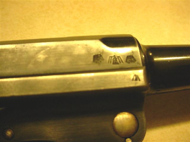

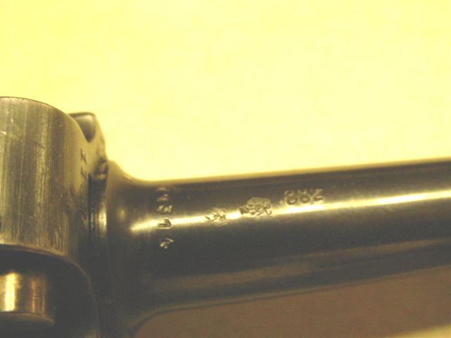

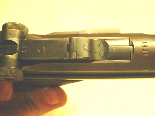

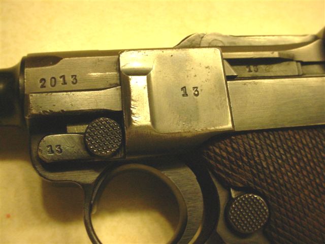

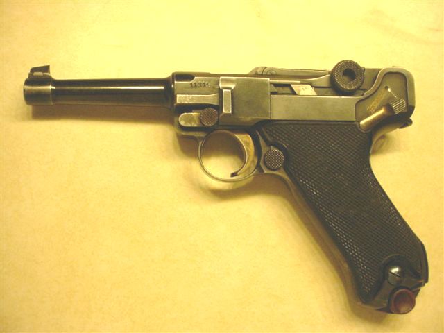

Gun No. 2 photos appear to show a WWII Mauser era luger :

Join Date: Dec 2006

1939 42 is not uncommon.
The 1944 krieghoff is rare as hens teeth... I can be over tomorrow and pick it up, its only 560 miles to your location...

John, would like very much to hear your "take" on this 1944 HK as it has stimulated a bit of discussion on Jan Still's Forum. The two issues are the Finnish appearing front sight blade and the wooden magazine bottom. Not only haven't I seen a wooden mag bottom on an HK, but the fonts of the serial number look force matched and the marking below the numbers looks like a "K" overstamping something else. These unusual features raise the question of this HK's authenticity and your opinion, I believe, should be shared.

I suggested he get together with the Simpsons for an appraisal. When a gun might be worth $ 10K or more, the $ 135 spent might be a good investment to know what one really has...
R. Gibson estimated around 200 1944-dated ones, only.

I think the Pacific Arms lugers from the 1920's had a front sight blade with this profile as well...maybe this HK had its sight replaced at some point in time. I hear those parts were abundant in the 1950-60's.

Here is a link to similar Mauser WWI lugers for sale on the Simpson LTD web site. Remember retail dealer prices are usually 15-20% higher than what a gun might sell for between collectors, privately :
http://www.simpsonltd.com/index.php?...sort=2a&page=3
As you compare your Mauser luger with these...keep in mind that value is based on :
1. Is the finish on the gun factory original.
2. How much of the factory original blue and straw finish remain (usually in a % rating such as 95%, 98%, etc.).
3. Are all parts serial number matched to your guns' main serial number. This assumes "forced matching" has not occurred.
4. Does the magazine match the luger and is it the "correct" type of magazine for your luger. Same with the grips, where applicable to a model.
5. Bore condition.
