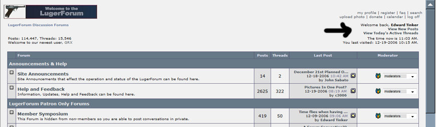

Unlike many forums, these are all interconnected, so folks may not post to ONE part, but in Military P08's, or Krieghoff's, etc. Go to the main page, and then If you look on the upper right corner of this page, you will see these, View New Posts, it will show you new posts since last time you visited. You can click on the one under it and see the posts from the last 24 hours.

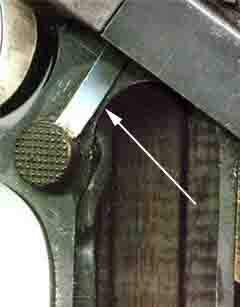

Excellent response! The numerous types you mention is the origination for my confusion. But I digress. Books and study is where I need to be.
The MAGAZINE button is actually loose. (it goes in and out without any pressure on it) When I eject, the button could stay in an ejected position.
(it depends on gravity) If I push on the button from the right side of the gun, the button is out far enough on the left to now lock in the clip. It seems like there must be a spring there to keep it forced more to the left side of the gun, but I don't see one on the dissasemble diagrams on the site....

Robert,
You are correct that you are missing the magazine button spring. It is a small, flat spring which slips under the side panel in the frame and a small slot milled into the mag release.
I'm sure that you can get one from someone on the Forum; Tom Heller (Lugerdoc) probably has one for sale.

Ahaaaa! I see it. The spring is there. I found a very tiny pin like part close to where I was working with it, shaped in an L. Im wondering if this is a 'pin' to keep the spring in place and pushed forward.
Another question I have though, is the removal of the hand grips. I can remove the screw at the bottom of the hand grip, but it looks like it has no value in keeping the grip in place. In fact I can't even see what the purpose of the screw is. The grips appear to be glued, or Im too nervous to see how to take them off.
If I can get the grips off safely, I can check to see if this 'pin' is fits in there.

Wow. Ok. The grips came right off after I removed the screws and put a tiny bit of pressure on them from the inside of the mag space.
After that, I can see where the small part I've saved does belong there.
The only problem is, I removed the spring gently, touched it once or twice and it snapped right in half. Guess I'll need one of those springs
