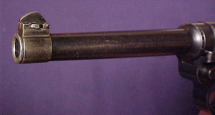

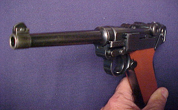

What this seller does not state (but does show in the photos), is that there are three (3) different serial numbers on the Swiss M1929 luger :
http://www.auctionarms.com/search/di...temnum=7771318
Main serial is # 55539, but the barrel has # 59169 and the rear toggle link has # 64605.
Front sight blade is not the Swiss style either...

Pete, And the seller calls this gun "Near-Mint". It's not even close to mint in my book. I would classify it as a mis-matched shooter. I'm sure that Swiss shooters can be found for less than $2K.

It would make a great $ 950 shooter...if you can convince him to reconsider his pricing...
BTW...the photo may show a bore that is just too big to be 7,65 mm. Maybe a 9 mm replacement in 4-3/4" length. The front sight barrel band does not look right and appears too "fat" as well...
