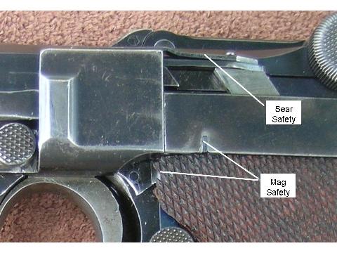

Tim, welcome to the forum, take a look under the FAQ in the New Collectors area for a police sear safety.
It sounds like you have a weimar police luger, probably what is called a Alphabet Police luger, it might have a suffix on the front of the frame.

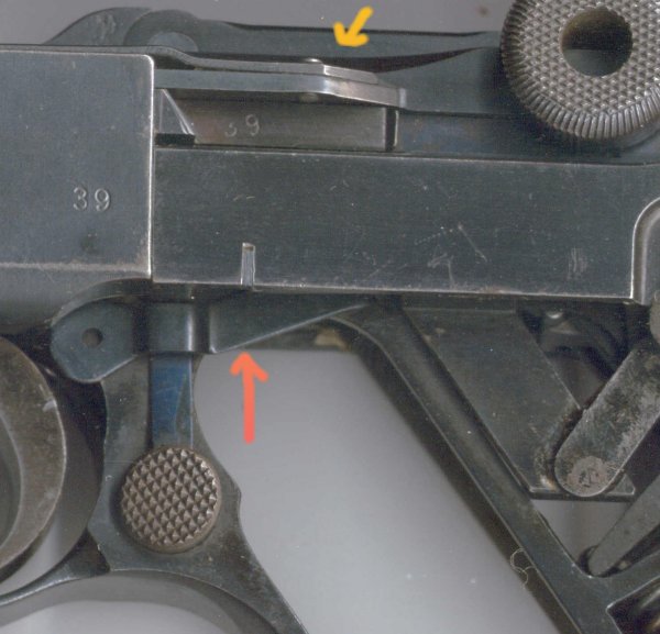

The "q" suffix is quite appropriate. It indicates this pistol was one of 9,999 with that suffix manufactured by DWM in 1927 or early 1928. Your serial number suggests about mid-1927. These were nominally commercial pistols (no chamber date) but most with this suffix were purchased by the German police.
The marking on the grip strap indicates the pistol was weapon number 72 of the Revierpolizei (precinct police) of Command VII of the Schupzpolizei (Protection Police) in the Prussian administrative district of D�¼sseldorf. Command VII was one or more cities within the industrialized Ruhr region in The Rhineland. I have been researching German police markings and have a database of over 1200 of them. Counting yours, it has only two Lugers from this Command.
For my database and research, I would appreciate knowing the following additional information (which may be in the forthcoming photos):
* Is the R in the marking crossed out?
* Does or did this pistol have a magazine safety? The following photo illustrates both the sear and magazine safeties.
Don

The R is not crossed out. The pistol has the sear safety and the cut out area in the grip and frame for the magazine safety. Apparently someone has removed the mag safety, is there a photo or drawing of a magazine safety removed from the pistol that you know of, or a place I can purchase the mag safety. If I could see one I can make it. Pretty handy with my J Head Bridgeport Mill.

Magazine safeties are quite rare, particularly those that are still intact. Most of them, if they weren't removed altogether, were clipped to remove the part in back of the trigger that blocked the movement of the trigger when the magazine was removed. I do not have an image of a mag safety removed from the gun, but here is a photo of a complete one...doubt that you can fabricate one from this image but it will give you an idea of what it looks like and how it functioned. I have only seen two complete magazine safeties ever offered for sale. Good luck.

G. Henrotin has an e-book The Luger Pistol Mechanical Features that illustrates the mag safety (no dimensions, unfortunately) and explains its operation. Since the German police apparently despised it, I'm not sure what the benefit would be of making repro mag safeties. You don't sound like a booster. Discovering a Luger with an intact original mag safety would be a genuine find, however.

Just FYI... the mag safety was a stamped sheet metal spring... not a machined steel part... while the Henrotin E-book does not give dimensions on the safety, the illustrations are good enough that an enterprising machinist like your self could probably make a good reproduction from the images... They would be a novelty, but I think you would probably sell a few here on the forum if you could make them... If you are concerned about someone passing them off as genuine, you could just mark them in a way that they could never be mistaken for a genuine part...

A magazine safety is also shown in Jan Still's book. Although I don't know if I agree with making them, I personally would want several for myself if you "insist on making them
weimar_lugers@comcast.net
Top is the sear safety, bottom is the magazine safety
